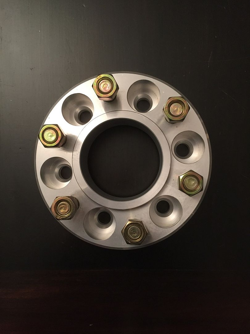

So honestly..the wheel spacers made a huge difference or just so so....cause I'm thinking of putting someon my b26 along with wheel weights..when I attach my rear blower...because if I do a little fel work ..I don't want to take off and on the blower and attach bh just for ballast...or if anyone has any other suggestions my ears are open.... IMG_2431.JPGIMG_2432.JPG

The spacers simply allowed me to install the chains without the chains rubbing on the fenders. The spacers themselves I'm sure help stability a bit. But the main goal was the chains. Tractor was useless on my hilly laneway without the chains.

Ok..I've been doing lot a of research on the spacers.they are suppose to help stability quite a bit.....I'm thinking of 2" on rear and 1 1/2" on front...with the laurin cab on its top heavy..so just for a little peace of mind .the spacers should help me out.....

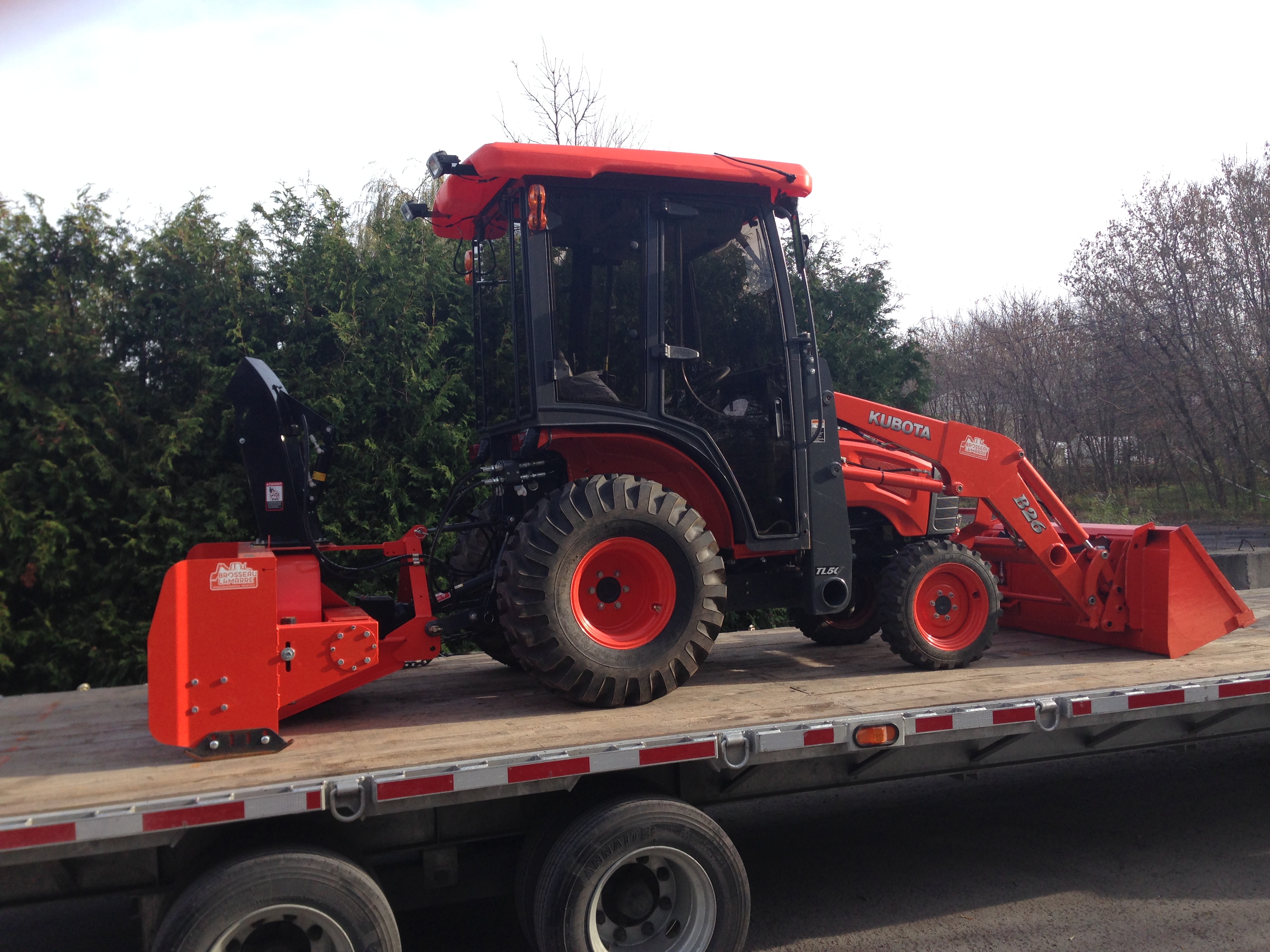

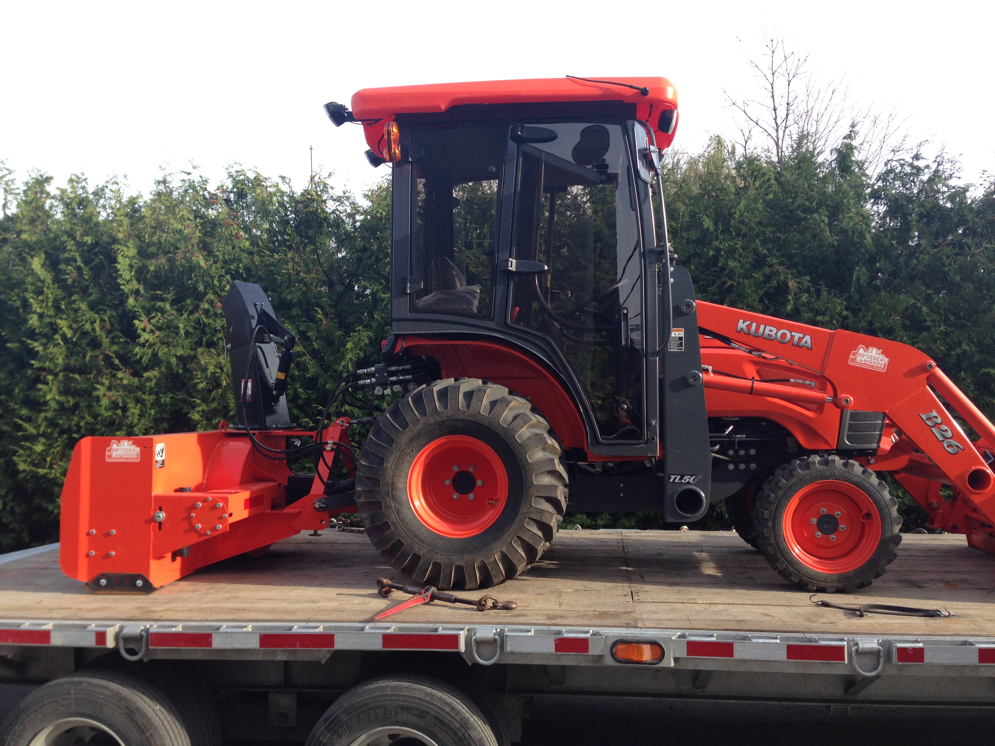

So honestly..the wheel spacers made a huge difference or just so so....cause I'm thinking of putting someon my b26 along with wheel weights..when I attach my rear blower...because if I do a little fel work ..I don't want to take off and on the blower and attach bh just for ballast...or if anyone has any other suggestions my ears are open....View attachment 528742View attachment 528743
No real need for a plow when you have the blower! Might pick up a blower some day. The cab is looks great, but wow are they expensive.

Thanks..yea very expensive..my first year with cab and blower...I will post to see how b26 runs the blmx3164 rear blower...I heard positives and negatives about this set up...I'd like to get rubber chains for mine along with wheel spacers...

My spacers came from bro-tek, very pleased with the quality and the service.
/ B26TLB & Plow #31
Thanks backlight..I'm ordering now as we speak..
