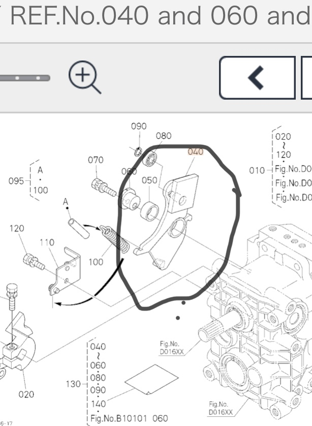

If you look under the right side of the B2650, you can see the return to neutral safety switch. You will have to crawl under the tractor.
There is a metal loop about 1” long that slides up and down that affects the safety switch.
Look for any sign of rust around that loop. Spray with lubricant.
I had a similar problem on my B2650.
Hope this helps.
   / B2650 stalling or not starting - one problem or two #16
I think this where your problem might be.

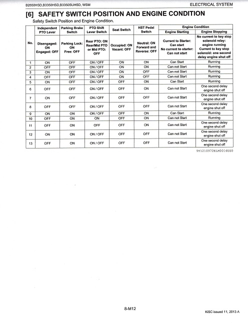

I did end up putting the wire over top of the seat safety to temporarily rule it out. And I will definitely have a gander for the metal loop that slides up and down by the switch, lubricating it, as well as unplugging the switch, inspect/clean, di-electric greasing it, and plugging it back in the next bit of free time.
When the issue arises again at least it is narrowed down to the switch, sensor, or relay, and likely the return to neutral safety switch.

The HST pedal switch is a common failure point on these tractors, mine went around 600hrs and was glad that I had noticed a few other people had issues so I knew where to go. You can unplug the switch and throw a jumper wire in the next time it acts up and see what it does
