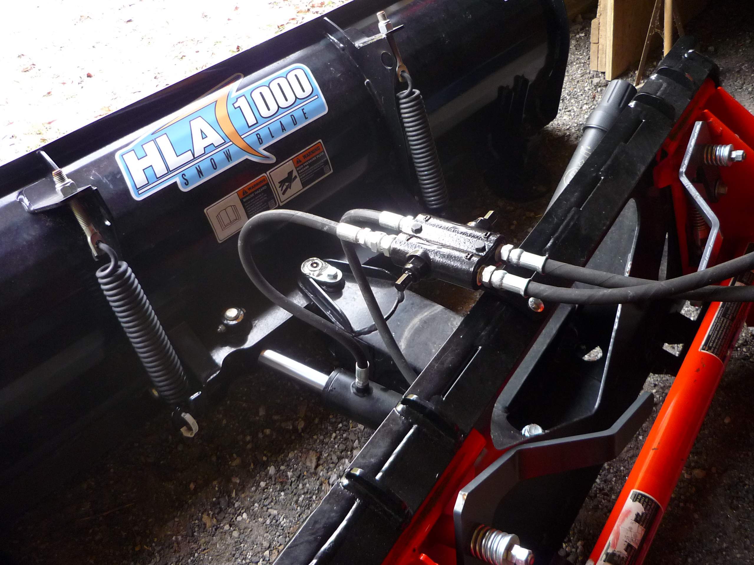

Kubota sells a blower, plow, sweeper and what all for the frame mount QA (as opposed to the SSQA) for the B2650/B3350. While the SSQA has the obvious advantage of being able to lift and pile snow high, it could also put a fair amount of side loading on the loader frame. Just in normal use with the loader, it's obvious that the loader is not exceedingly strong when it comes to lateral forces (side loading) - it deflects sideways with mild force (at least "mild" when it comes to shoving things with a tractor). I doubt the loader would be damaged in normal plow ops, but if the blade was angled and hit an obstruction - I'm not so sure. The QA, on the other hand, is attached directly to the tractor front frame - exceedingly strong and close coupled, so lateral forces on the plow or other attachments will have less ability to deflect the tractor front end than would be the case with the loader mount. And since the QA only uses one set of hoses, you can use the other loaded function to operate the hydraulic angle cyclinders for the plow if you don't have 3rd function.
/ B2650 snow removal options #23
And a 'crossover valve' between the plow hoses on the plow frame dampens shocks, lateral and otherwise, to the loader, or subframe, depending on how one mounts their plow.

With a larger than ideal width HLA 1000 blade on my L3400, I also liked the idea of impact protection, especially when I was plowing depressed gravel lanes, so after speaking with HLA's guys, I ordered a $75 crossover relief valve from Surplus Center, and made a small pressure adjustment after installing it and using the plow. Now, if one side strikes something, the plow seems to release. Note that I don't usually have it fully angled, which logic tells me would defeat the crossover's ability to work. Mine is likely the same arrangement that is used on the single cylinder 2000 series plows.

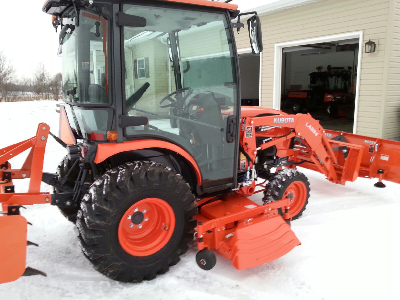

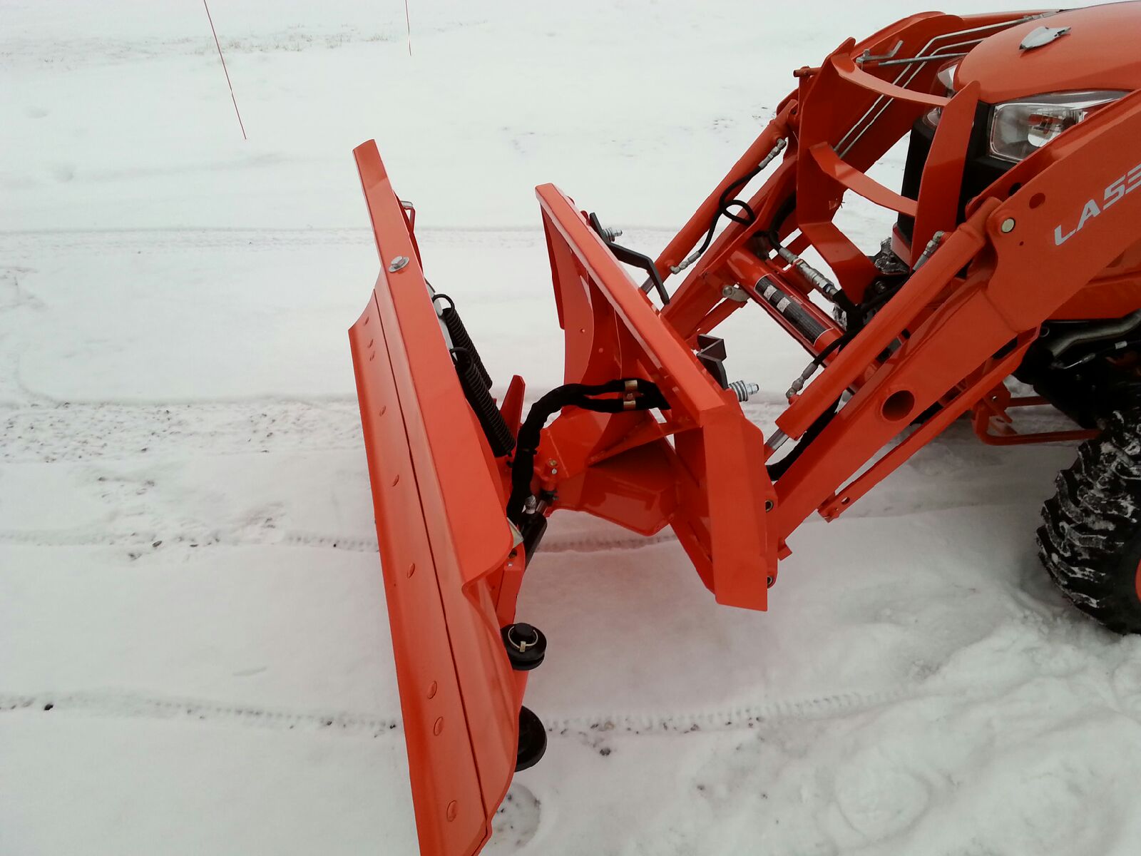

Newtattoobob
Can or would you post some photos of your qa blade. Is it spring loaded?
/ B2650 snow removal options #28
Yes its spring loaded, its the kubota one. I'm not sure of the model but I will find out and post some pics.
/ B2650 snow removal options #30
Here is a couple pics of the plow when I first got it.
/ B2650 snow removal options #31
N T Bob- that's a very clean looking rig you have... do you have a third function for the plow angle? I am getting serious cab-envy, but it wouldn't work when I go fire wood gathering, or post holing, so maybe I need a second tractor?
/ B2650 snow removal options #33
Those pics are when it was brand new. Not quite so clean now! It does have the factory third function kit.
