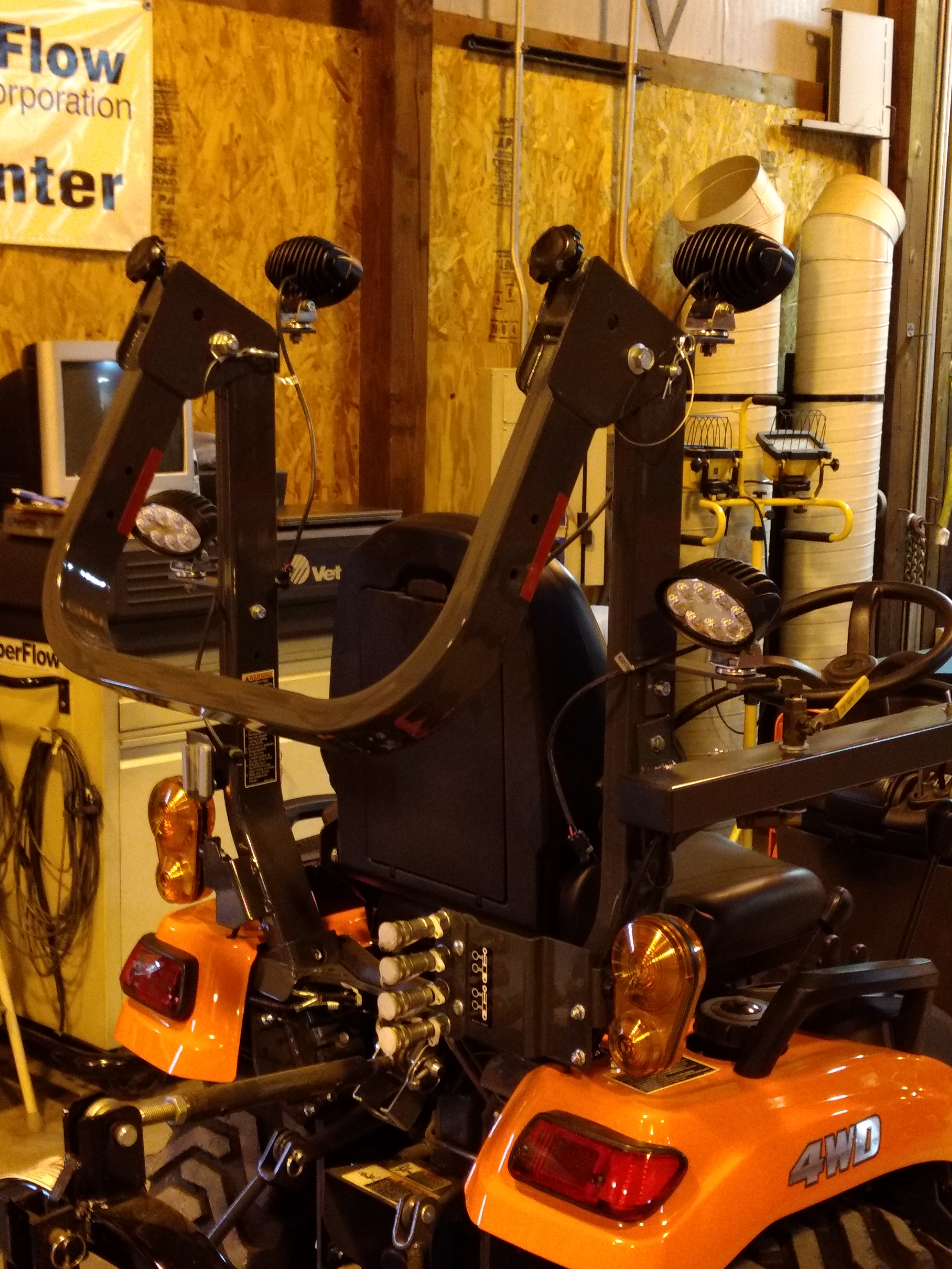

Oh my goodness! I have a BX2380 and an L6060 with rear remote hydraulics and they are very well designed and tidy looking. The set up in the picture looks like the Russians hacked into the designers brains! Thanks for the link to the picture. I can see why Kubota doesn't show that anywhere in there information on the B2650.
Yep it don't look good .

I do not know why it isn't engineered for adding the remote hydraulic valve kit. I have a picture that shows the coupler location and the operating levers, the valves are mounted on the right hand side of the transmission housing behind the rear wheel.

This is what it will look like
And it痴 actually over 1200 with tax
What a Rube Goldberg.

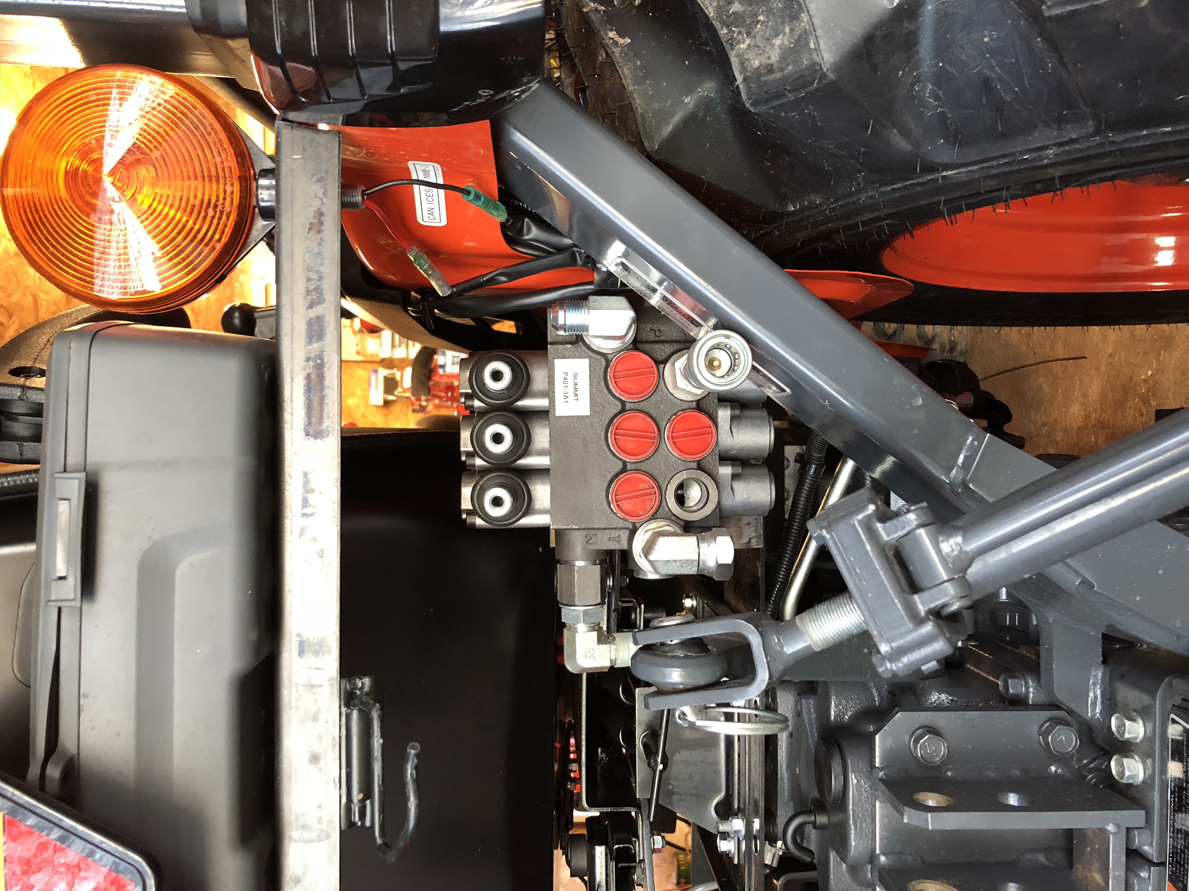

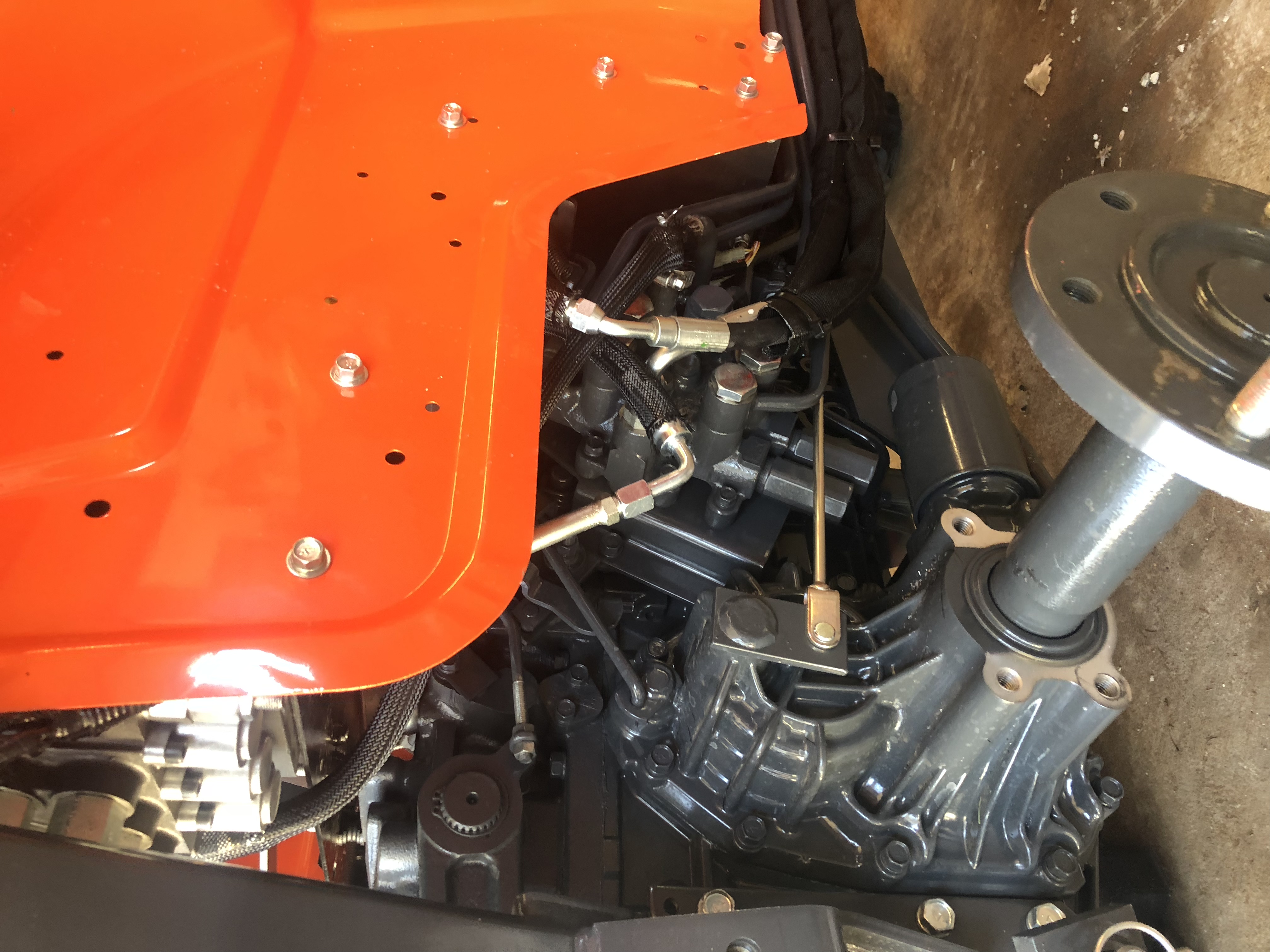

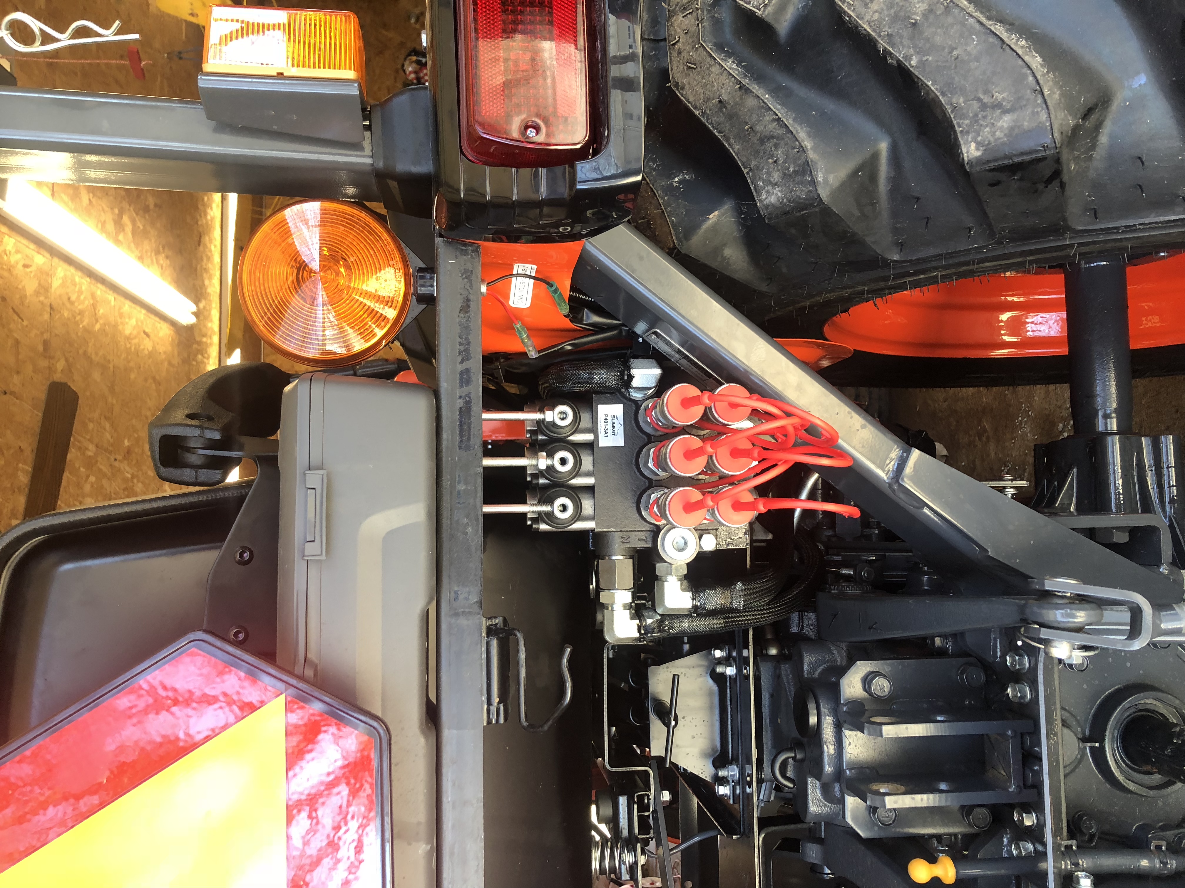

In case anyone didn稚 follow the other threads.
This is the 3 spool valve I mounted to my b2650. 10x better than kubota option for less than 250$
I haven稚 got around to making handles yet as I haven稚 came up with a need for the valve yet anyway.
I got most of my ideas from RKIDD so I can稚 take the credit
   / B2650 Remote hydraulic valve kit #18
Is this something that someone with little to no experience with hydraulics can figure out? Is there a parts list available for someone to buy all of this? Is it a "simple" bolt on, or is there machining and fabrication required?
