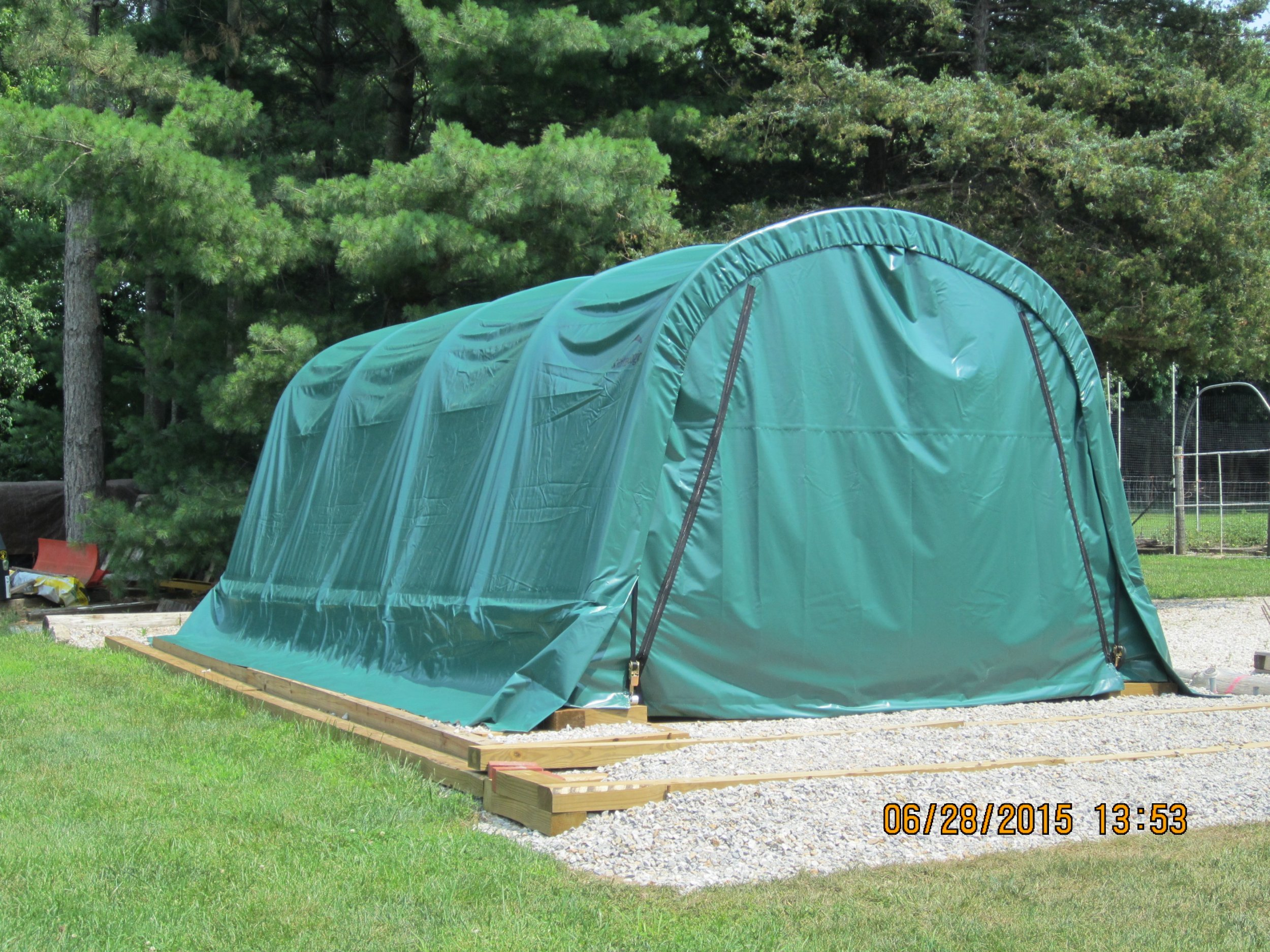

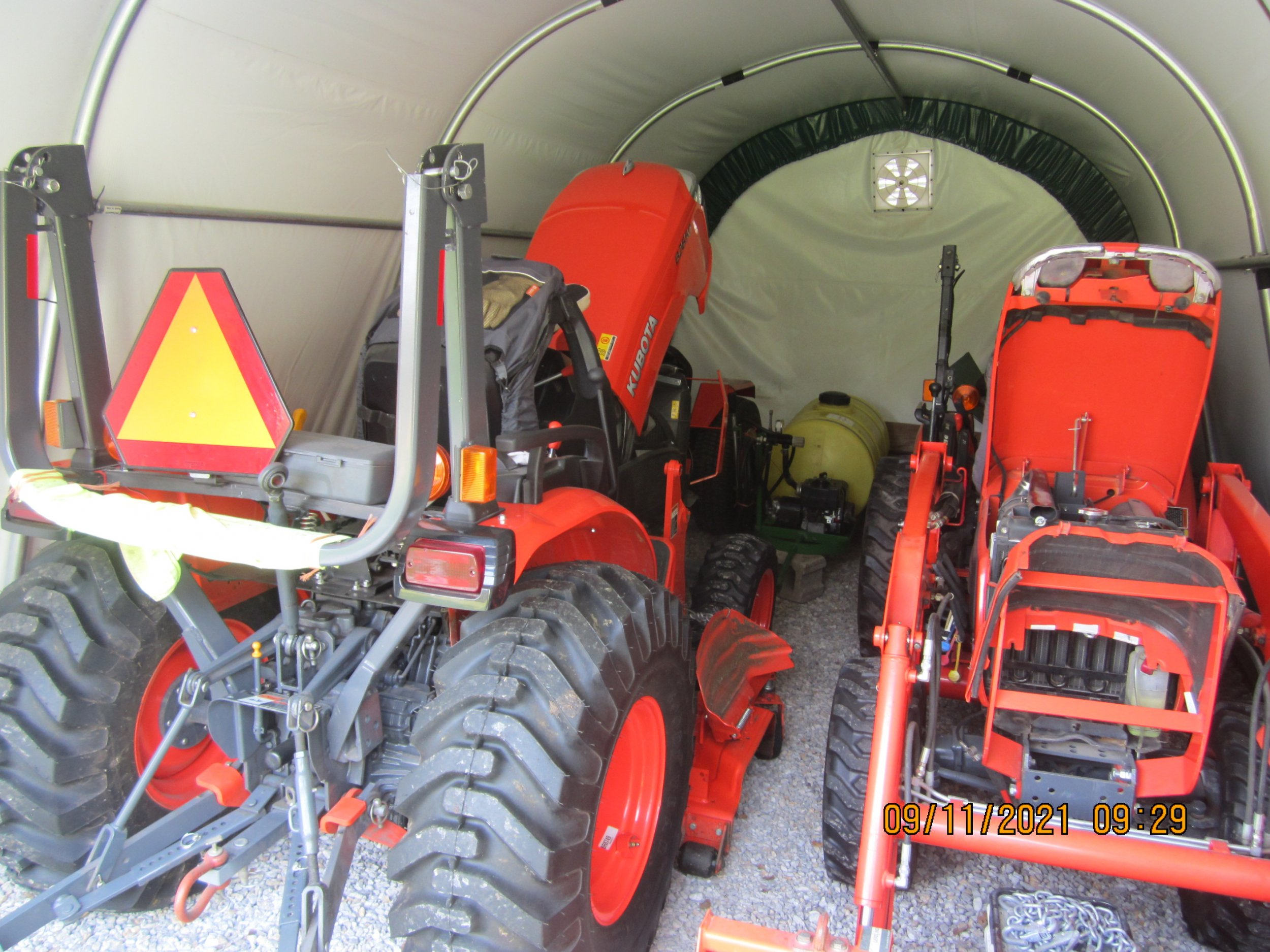

My experiences with a 2018 ...bought brand new B2650 now has 300 hours on it. I also run a B2620 and a Case 448 doing various chores
1. The Shelter Logic...Top of their line... I installed it myself with about $2000 into it. In six years it has withstood 70 mph winds and several heavy wet snows. I have the B2650..the B2620 the Case 448 and a MightyMac chipper /shredder and some small stuff garaged in it.

My Shelter Logic tarp shed blew apart the first spring it was up. My 2650 now sleeps in a pole barn with the other toys.
