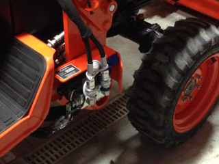

I am hoping to take delivery of my B2650 cab tractor in the next week or two. I ordered the tractor with loader, third function, loader mounted snowplow, quick hitch, front mount snow blower and 2 rear remotes. The blower is coming with hydraulic chute rotation, but I opted to fabricate my own hydraulic deflector using the cylinder from my BX2750D on my B2320. Seeing as it is snow season I will have to get to building as soon as the tractor is delivered. I am going to start gathering up some hose and fittings to do this project so that I have them on hand once the tractor arrives. I have a few questions that I hope others who own B50 series tractors can answer.
1. I am planning on running the hydraulic chute rotation off the third function. I am doing this to avoid the problems others have had controlling the motor due to the loader dump/curl circuit being regenerative. Where are the quick disconnects for the third function when the loader if removed? Are the located near enough to the loader valve quick disconnects that I will be able to move the hoses over to the third function, or do I need to plan on making some jumper hoses?
2. How much flow is there through the third function circuit? Will I want to add a restriction to slow down rotation of the chute?
3. Are the hydraulic quick disconnects on the B2650 the same 3/8 ag style couplers as on my B2320? I imagine they are, but don't want to order the wrong style. ISO 5675 Agricultural Hydraulic Quick Disconnects
Thanks for the help!

Does anyone have a Kubota third function on their tractors? I have ordered mine with this for use with the loader, but also in hopes of using it for control of one of my snow blower functions. I did not buy the Kubota OEM chute deflector because is was quite expensive and seemed to duplicate the third function by uses of a diverter valve on the roll/curl function. I have a cylinder I uses on my BX2750D to make hydraulic chute deflector that I was planning on transferring over to the new machine. From what I can see online, the third function is controlled by a set of buttons under the joystick knob. I presume that the lines must disconnect somewhere near the quick disconnects for the loader to enable loader removal. Anyone got any info to back this up?
/ B2650 Cab Snow Blower Questions #6
You will retain all loader functions and the valve assembly stays permanent on the tractor

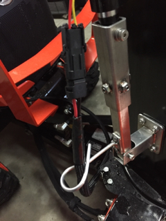

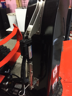

I went this route and built a 12 volt chute deflector this allowed me to keep the 3rd function For my hydro top link
