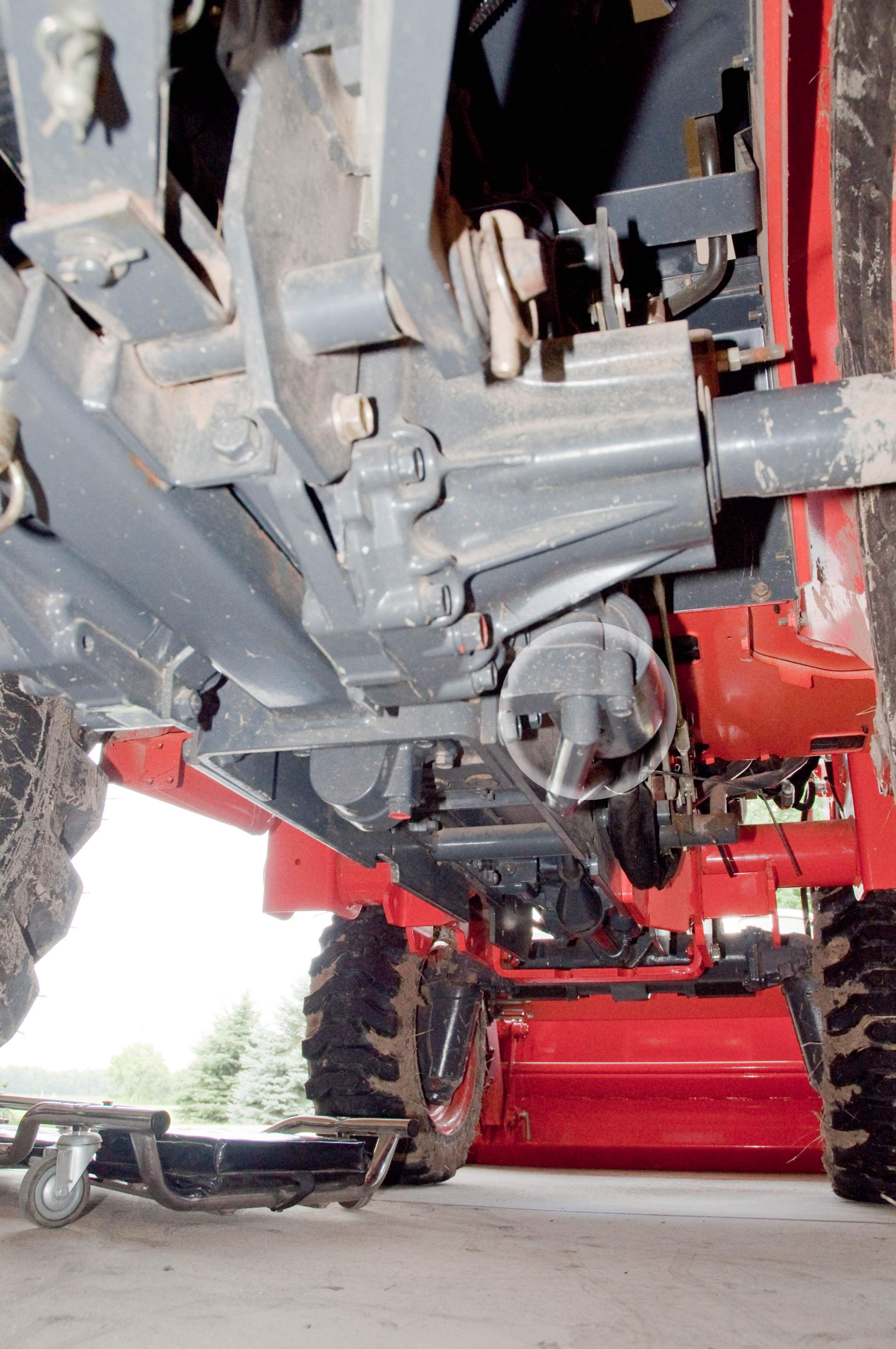

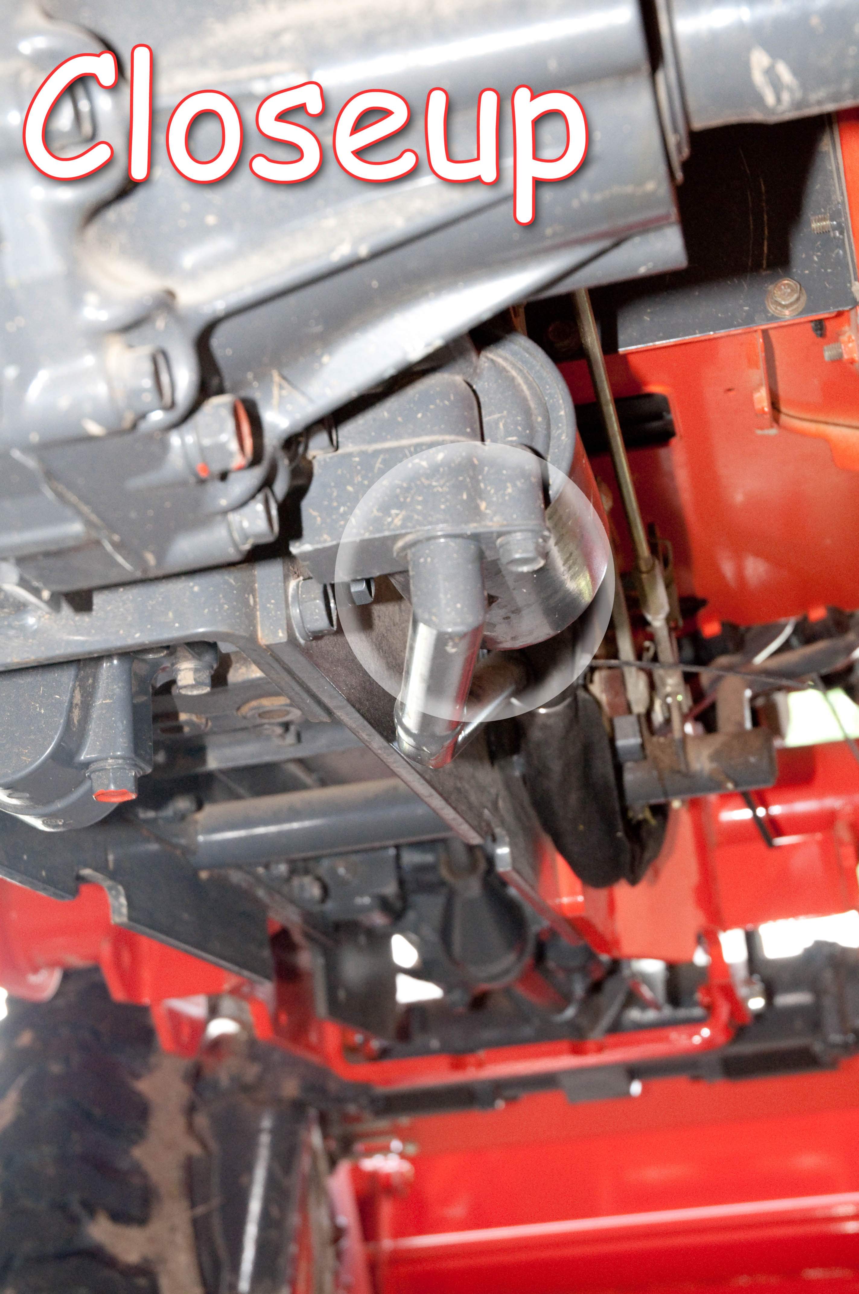

Thanks for the links TripleR & KubieTwo. After reading these and lookong at a my tractor, I think I may have found the screen location on my B2630 but not the mower (ZD323). See Pics attached and let me know if this is where the screen is located on the tractor. The circles are where I think the screen may be.
Thanks,
Rob

I was told by my dealer there is no hydraulic screen on that series tractor.
/ B2630 & ZD323 50 Hr Service #9
Earl may very well be right, if there is one it should be pointed out in your Manual.
/ B2630 & ZD323 50 Hr Service #10
I can't speak with authority on the B2630 but the B7510 and b7610 do have. It is right beside the suction filter. Both the B7510 and B7610 have 2 range transmissions so the difference may be that the screen was dropped on the 3 range transmissions in the smaller B series.
