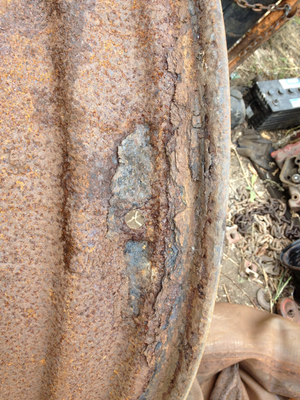

Was at a tractor shop when a customer brought in this tire with a small leak.
Other picture was the inside.
/ B2630 Tire Leak #7
Perfect example of why I hate calcium chloride. I will choose cast every time in spite of the cost.
