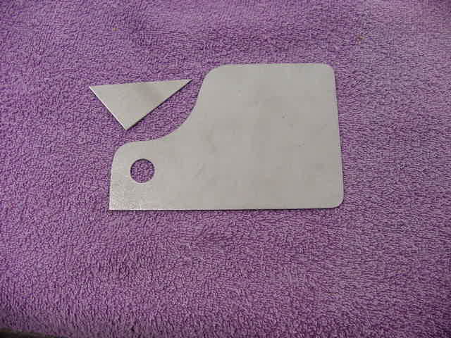

They are made out of 14 guage and look similar to this one which is made out of 11 guage. Will post actual picture tomorrow.

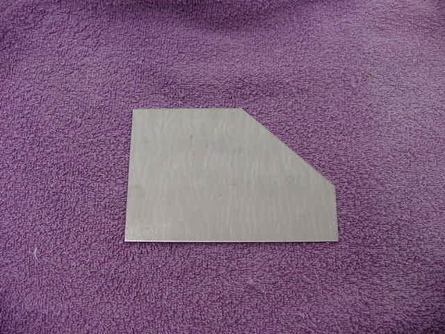

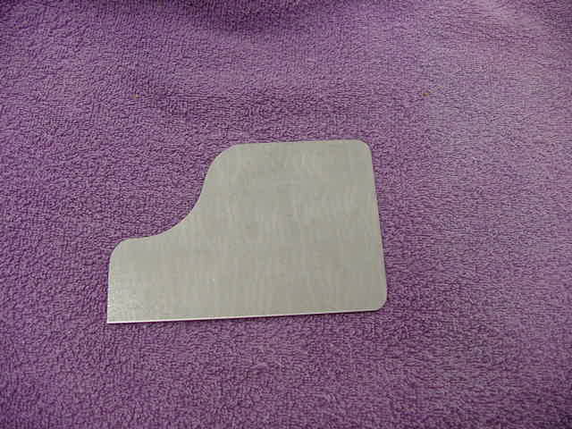

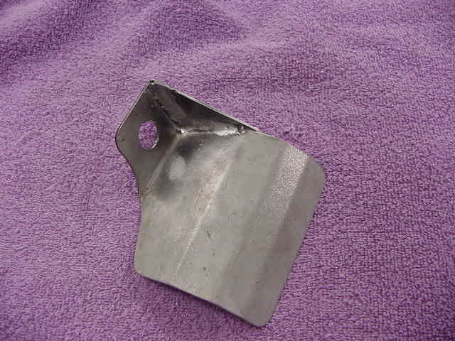

Here are some pics of the finished product. Welded them up yesterday, sanded the rough edges then bead blasted them before painting. The rounded part is done by bump breaking which is several small bends (you can see in pics). Because the metal is coated to except paint and resist rust I couldn't heat them and I didn't have a roller.
