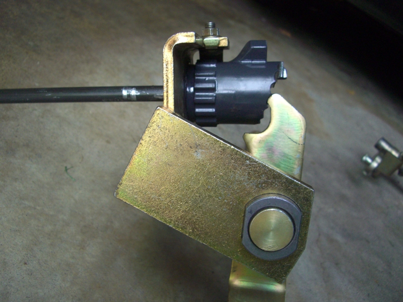

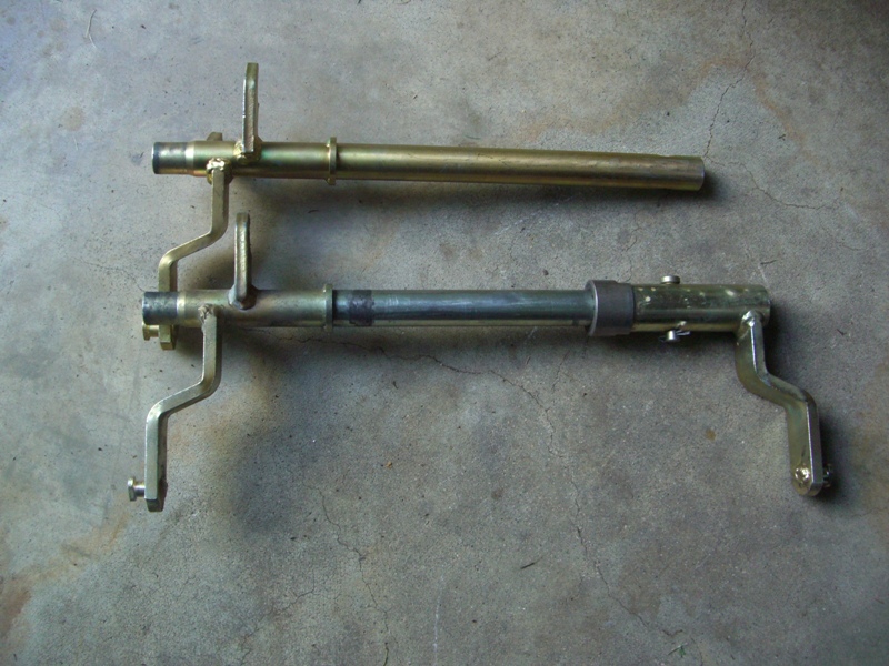

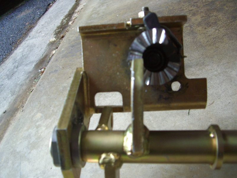

I got the parts back today. Here what they did:
1) New parts - the stepped cylinder and the shaft
2) Grinded down the steps in the cylinder to enhance the steps
3) Straighten the lever that engages on the step to align it
4) Grinded the top of the stepped cylinder so that the knob is not wobbly
It looks like it is going to work better with this improvements. We'll see when I mount the assembly on the tractor and put the MMM back. Attached are some pictures of the new and old shaft and of the wohle assembly.
I will report back how it all works.
