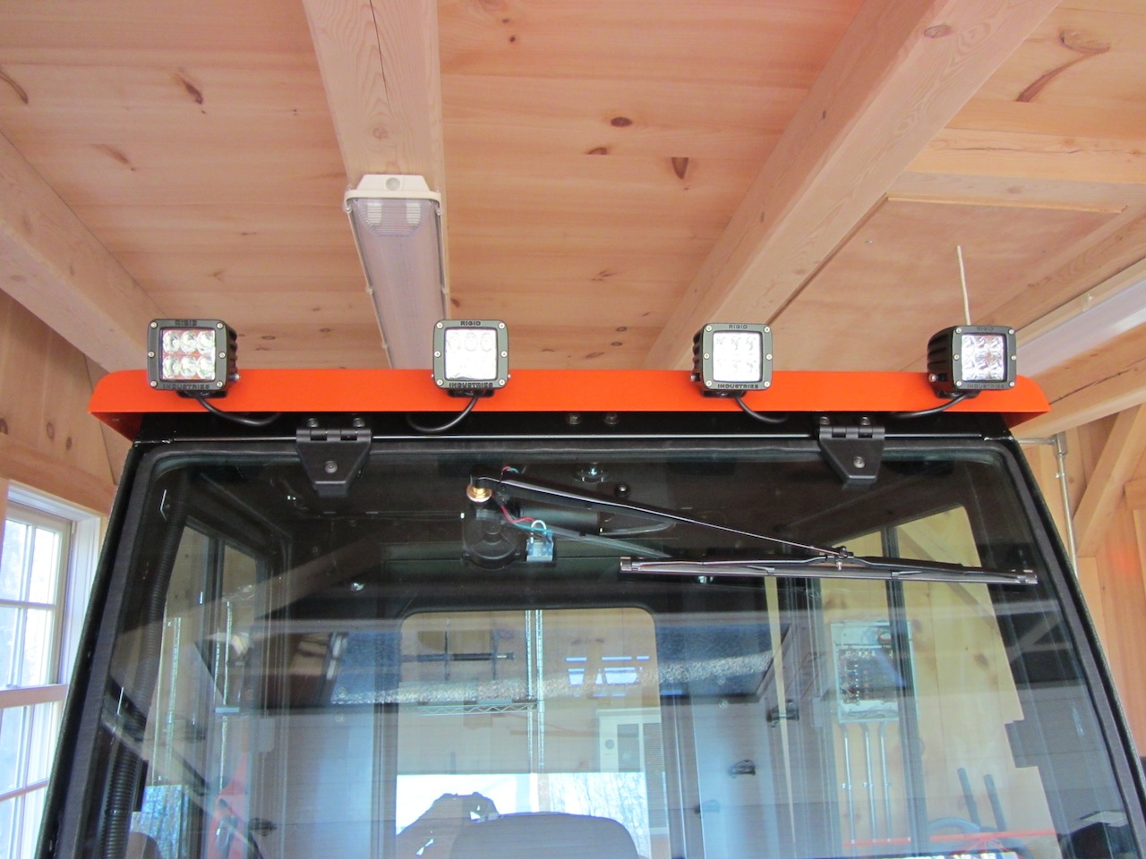

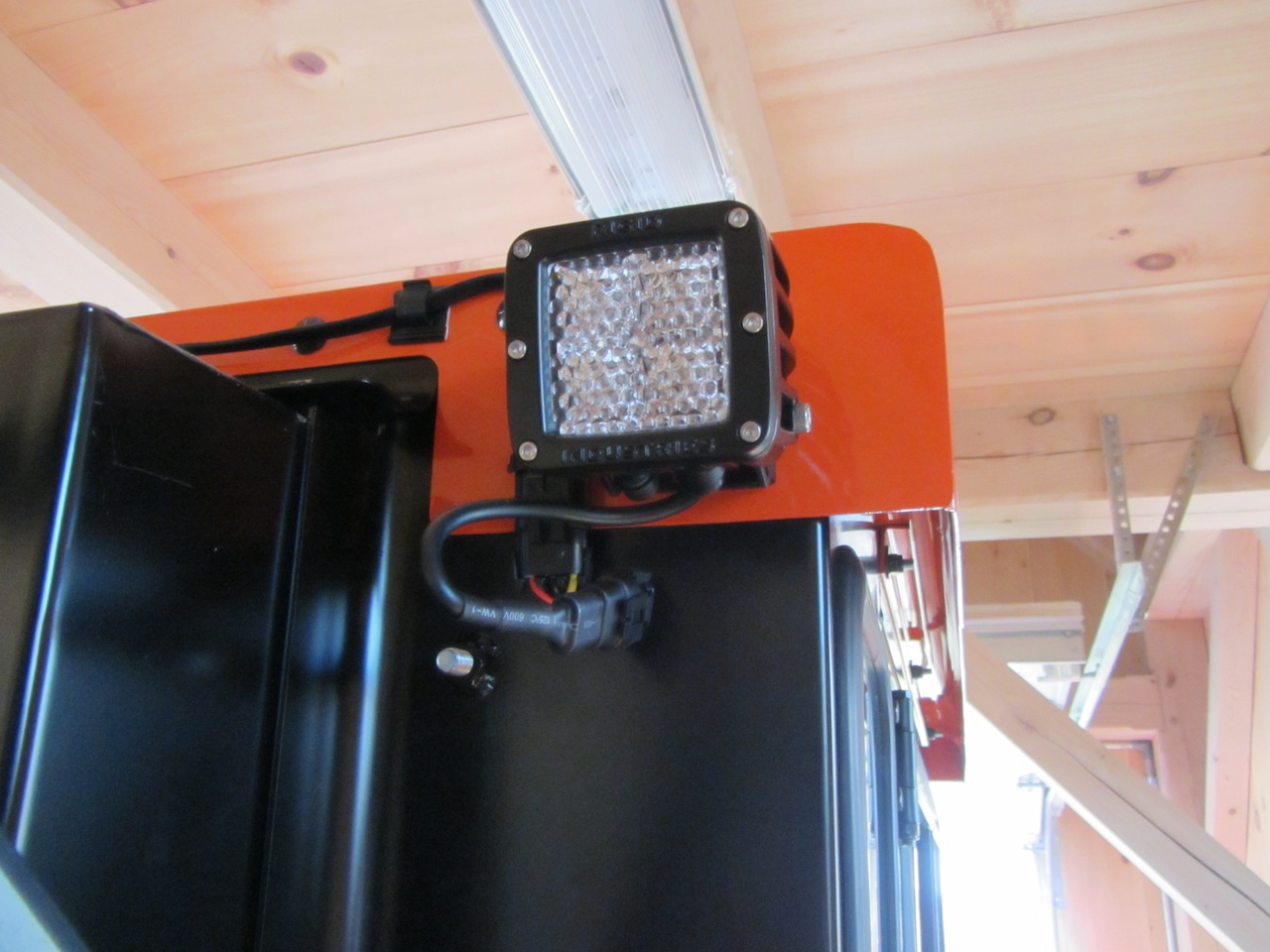

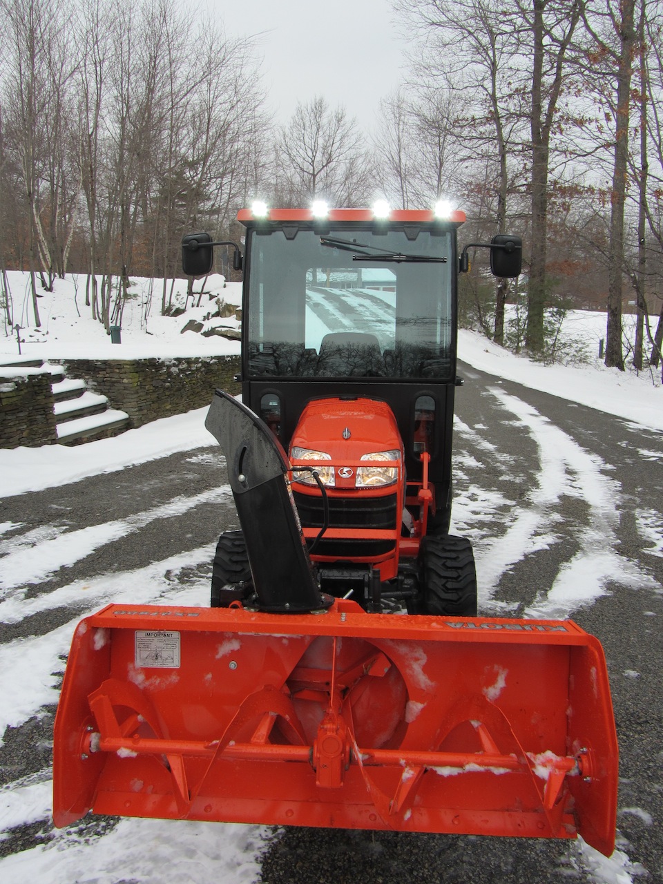

Here's some close-up pictures of the Rigid Industries Dually D2 LED Lights that I used. I'll try to get a picture of them at night to show how bright they are.

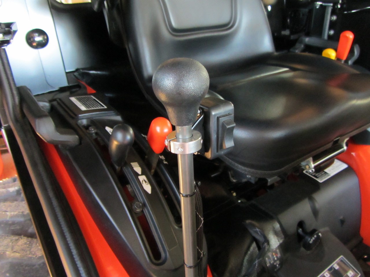

In addition, I had a request to show a close-up of the ATV winch rocker switch that I used for the chute control. If you need anymore, just let me know.
I really think you did an excellent job with this install.
Where did you mount the ATV winch on your tractor? I've been contemplating getting on for my B3200. Also, what strength winch did you get? (i.e. 2000lbs, 3000lbs, etc)
/ B2620 Cab Installation and Modifications #22
Bidman1970;
No winch mounted.
The winch rocker switch is used to control the Shute deflector
/ B2620 Cab Installation and Modifications #23
Bidman1970;
No winch mounted.
Doh! (as Homer Simpson would say).....makes sense....actually a really good location for the switch and it's usage!

Those LED's are nice!
Do you have any trouble with sticky snow not melting off or have you not had the chance yet to use during a snow storm?
#25
Thanks. Even though I haven't used them during a snow storm yet, I don't expect any trouble. They definitely get warm, which should be enough to melt any snow/ice accumulation immediately.
In fact, the entire light housing assembly is actually one big heat sink with large cooling fins in the rear (they weight a ton for their small size - looks are definitely deceiving in this case.) I believe their raw output is something like 2600 lumens per light fixture. A lot of power output for such a small light (which is the main reason I went with them.)

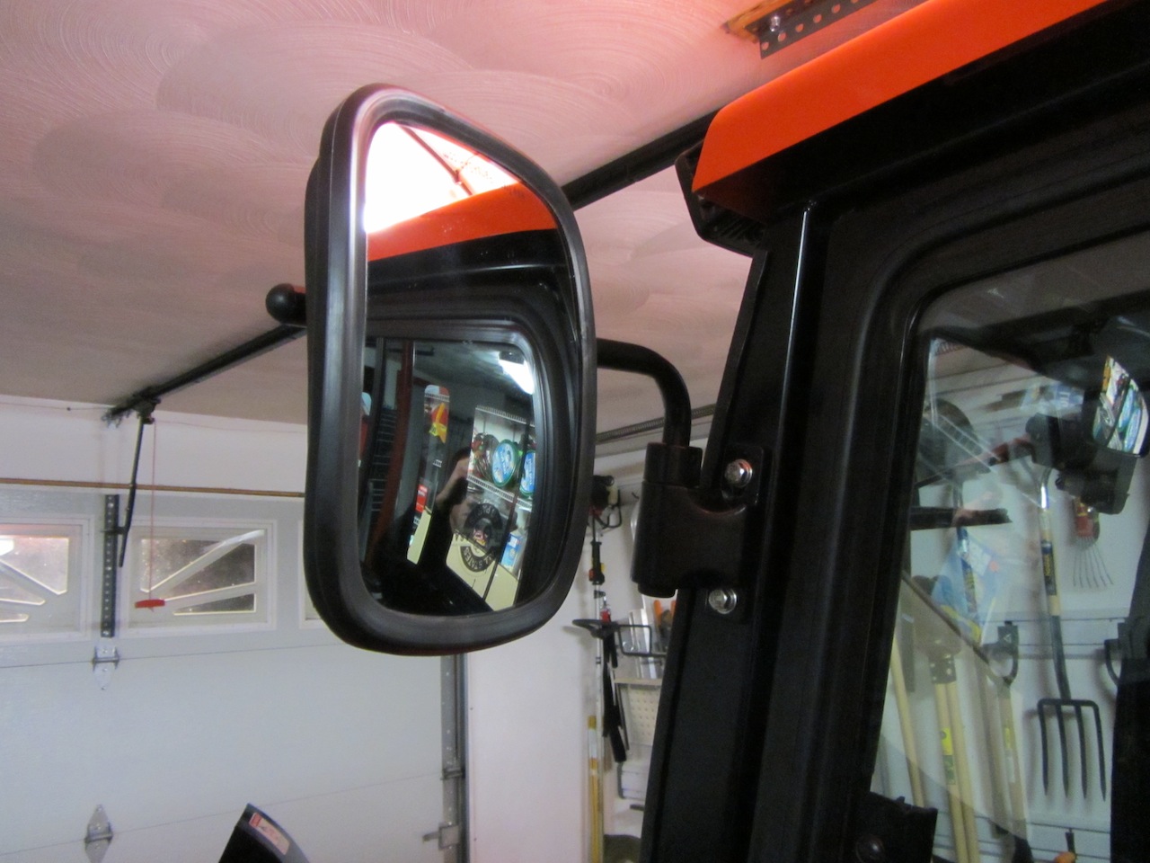

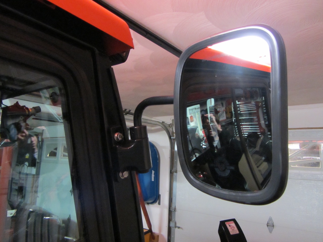

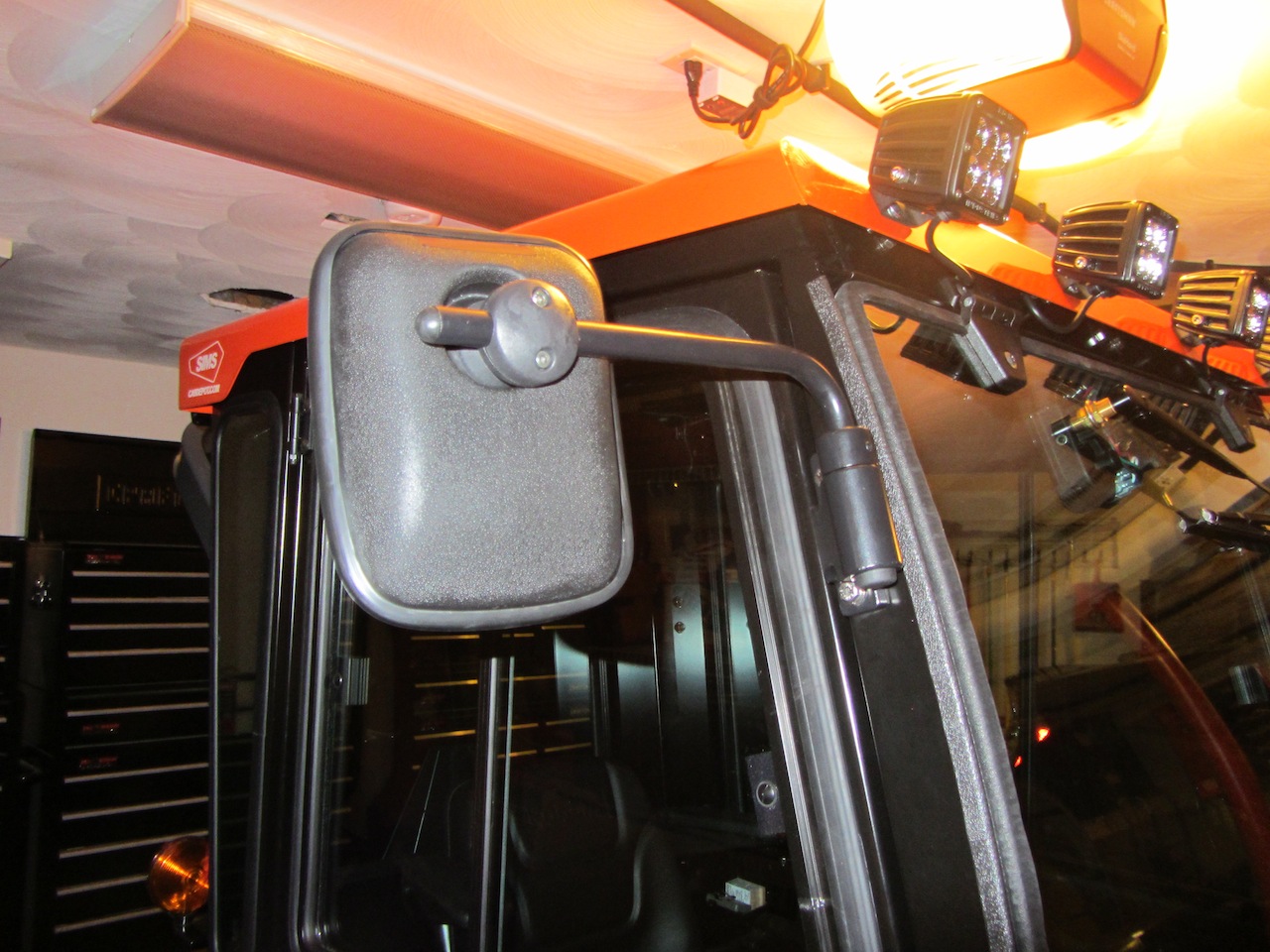

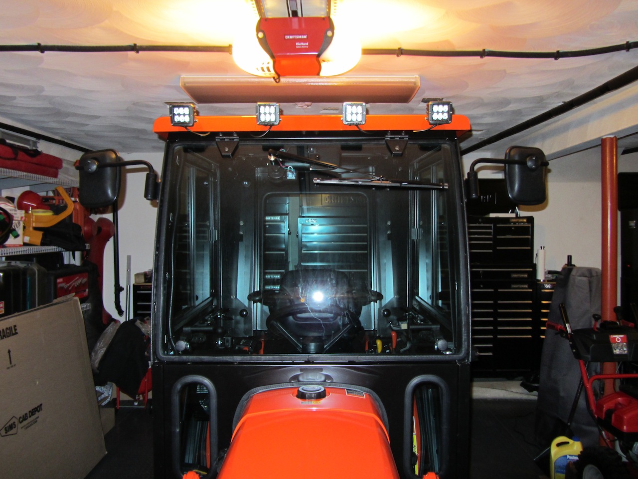

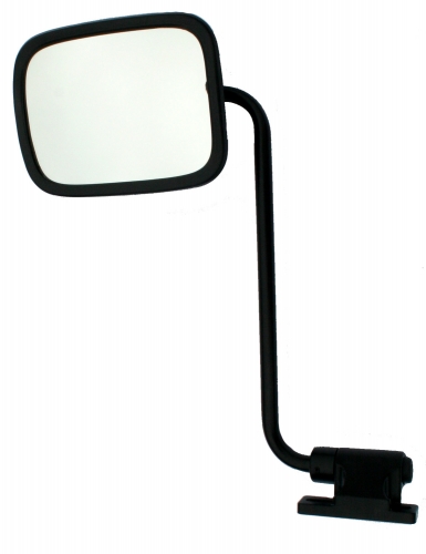

I made some more progress today with the installation of the mirrors for the cab. Even though Sims provided me with a free mirror kit, I decided not to use their kit as I wanted something more substantial. Instead, I went with the Depco Little Hoss Mirror Kit along with some modifications to the arm assemblies.
In my opinion, the Sims mirrors were just too small and even though I wish the Depco mirrors were a little larger, it definitely fits the size of the cab much better than the Sims mirrors.
To install them, all I had to drill holes in the door frames and install 5/16-18" Rivnuts.

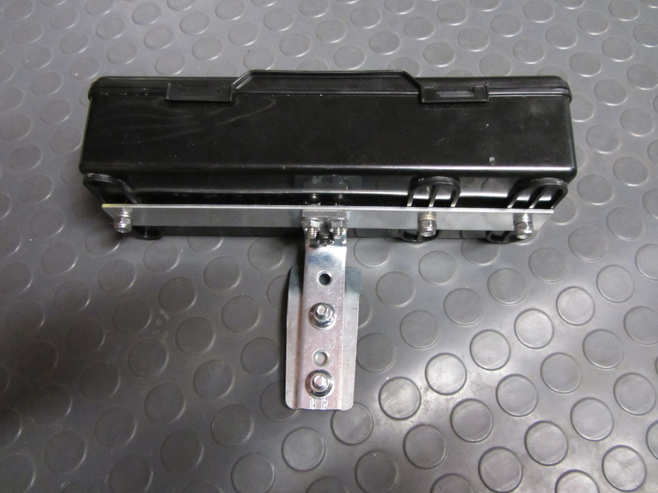

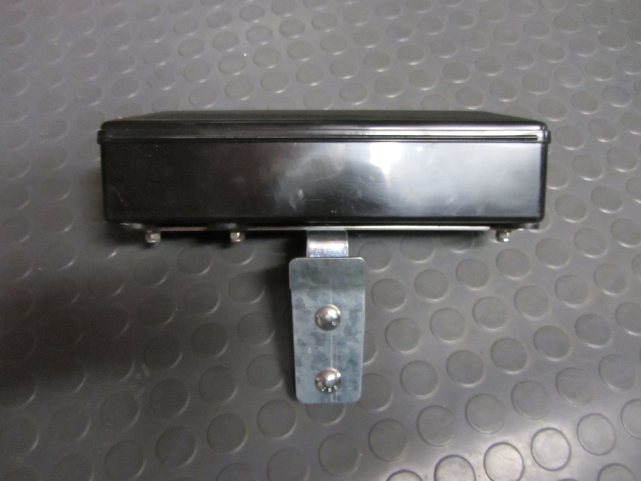

Now that the cab is installed, I no longer had a place to mount my toolbox. The bracket that comes with the backhoe to mount the toolbox to the ROPS interfered with the cab.
Another member mentioned they mounted their toolbox behind the seat, so it got me thinking. Why not make a quick bracket to mount to the SMV bracket behind the seat?
After a trip to TSC, I came up with this design. When the weather gets warmer, I'll break out my welder and weld everything together rather than using bolts. For the winter, this should work just fine holding my 3-point hitch and snow blower shear pins.

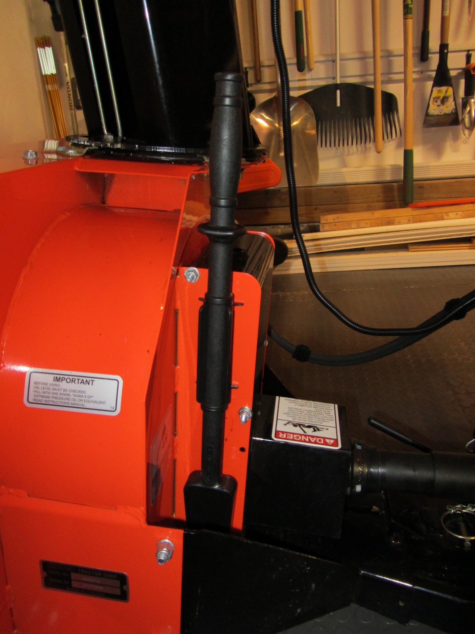

In addition, I mounted an MTD chute clearing tool to the BX2750D. It fits right on the side of the chain house without having to drill any holes. It should work well for clearing slush from the chute when it gets blocked (actually, I needed to use it during the last snow fall.)

Nice mirrors!
Just watch running along buildings or trees...don't ask

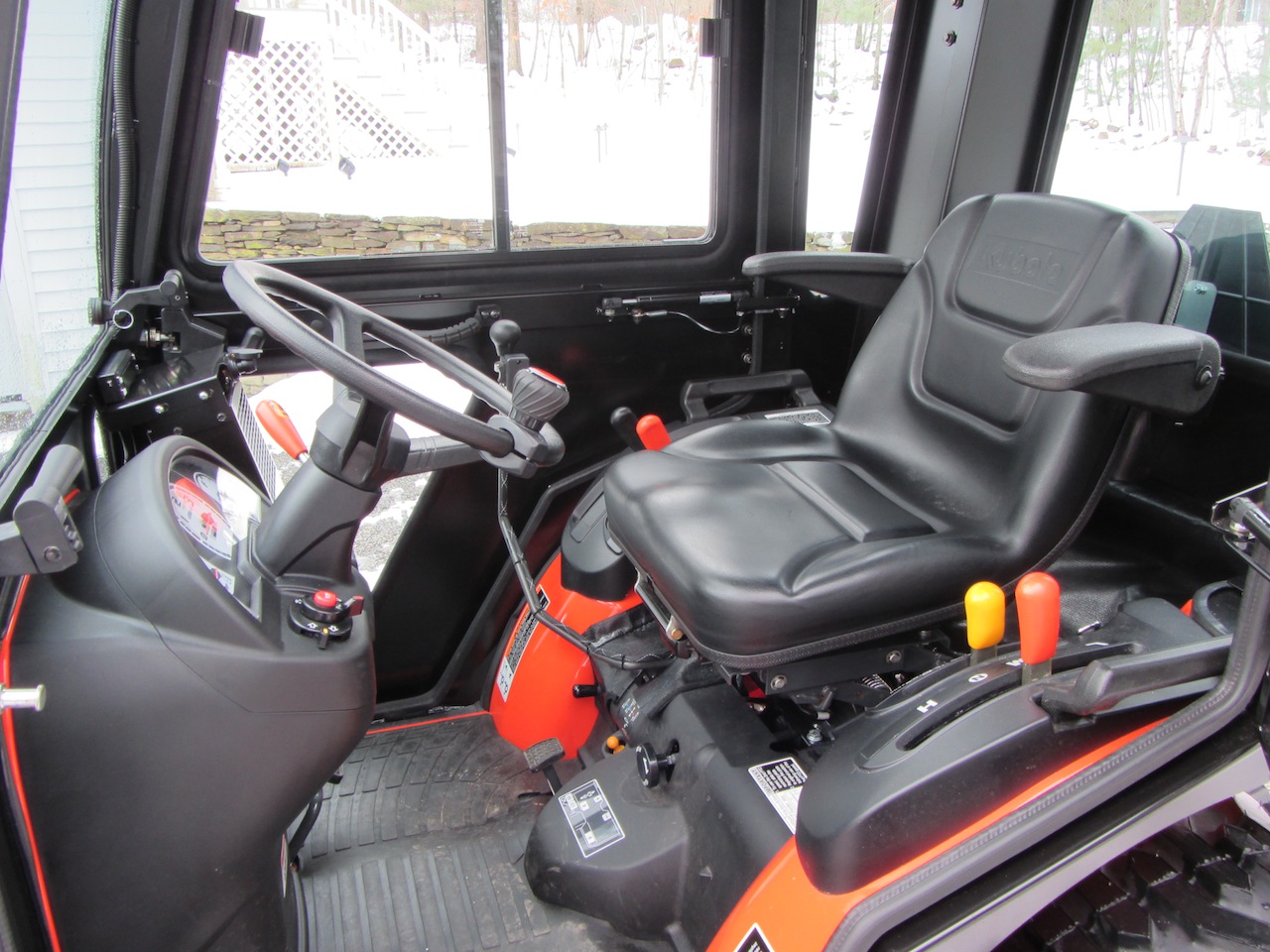

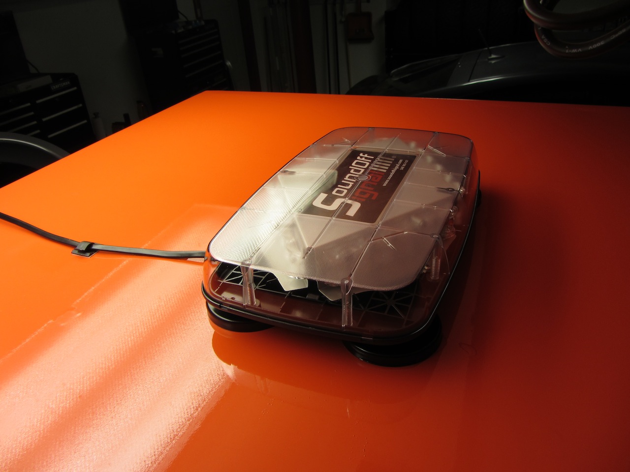

#32

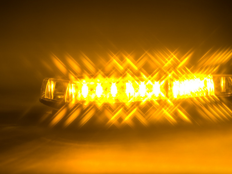

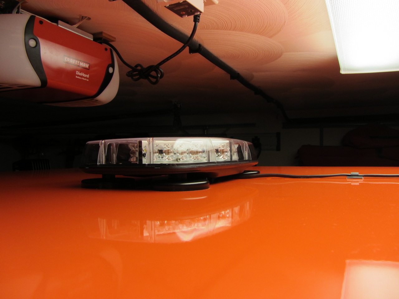

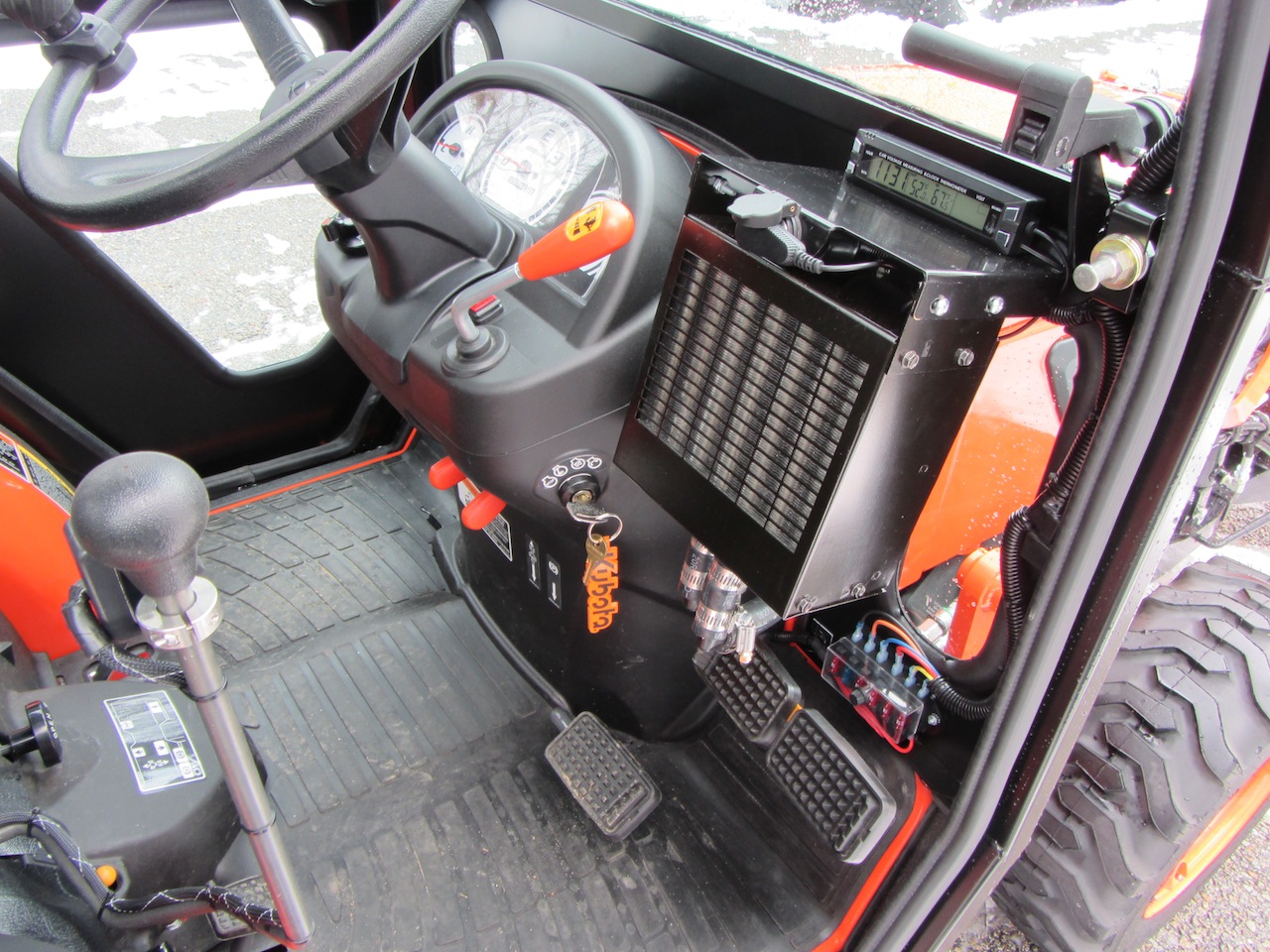

Here's a few pictures of the SoundOff Pinnacle LED Mini Lightbar that I installed on the roof of the cab. It's held in place with magnets, so I didn't have to drill any holes in the roof and risk getting leaks. It's really bright for it's relatively small size and has 28 different light patterns that you can program.
To change the light pattern, I also installed an additional momentary push button switch (that is separate from the on/off switch) on the side of my switch control panel. It works well, and I don't need to disconnect anything should I decided to change the pattern.
I'll try to make a video or get some better pictures at night of all the lighting to show how well everything works.

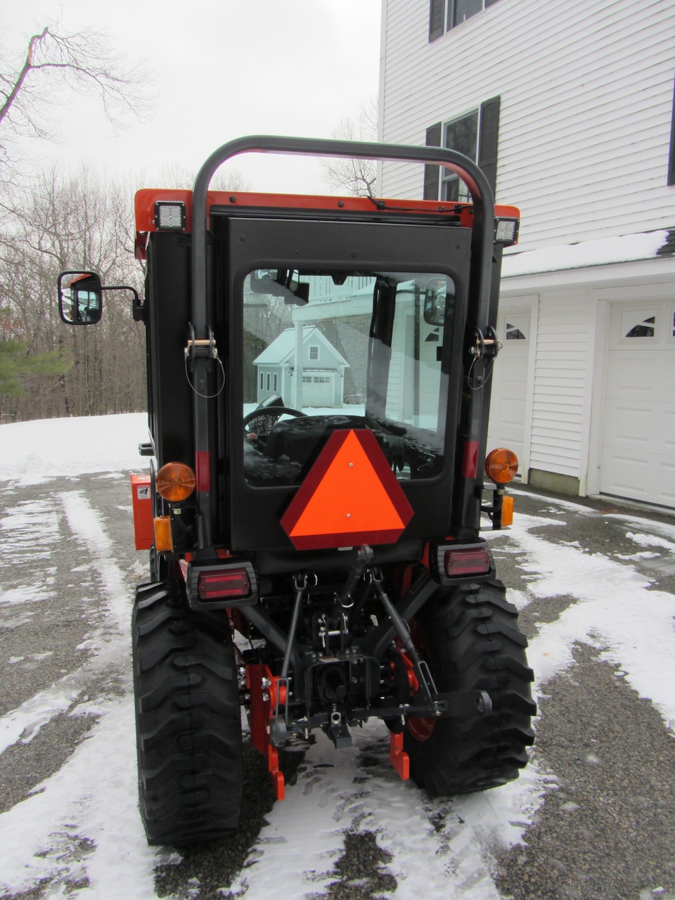

#33

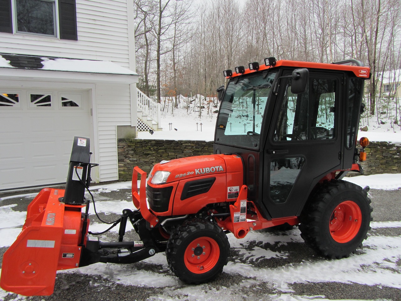

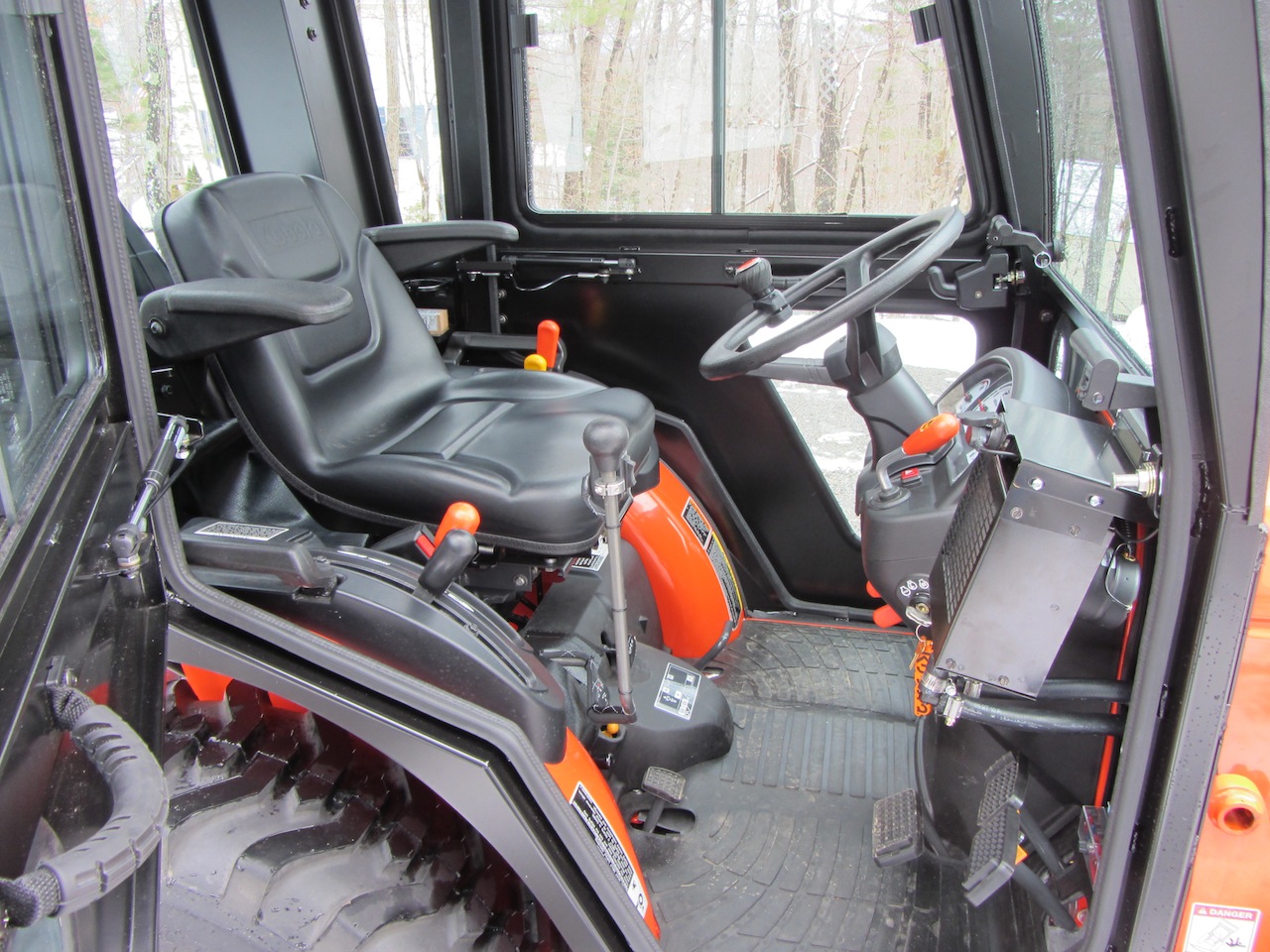

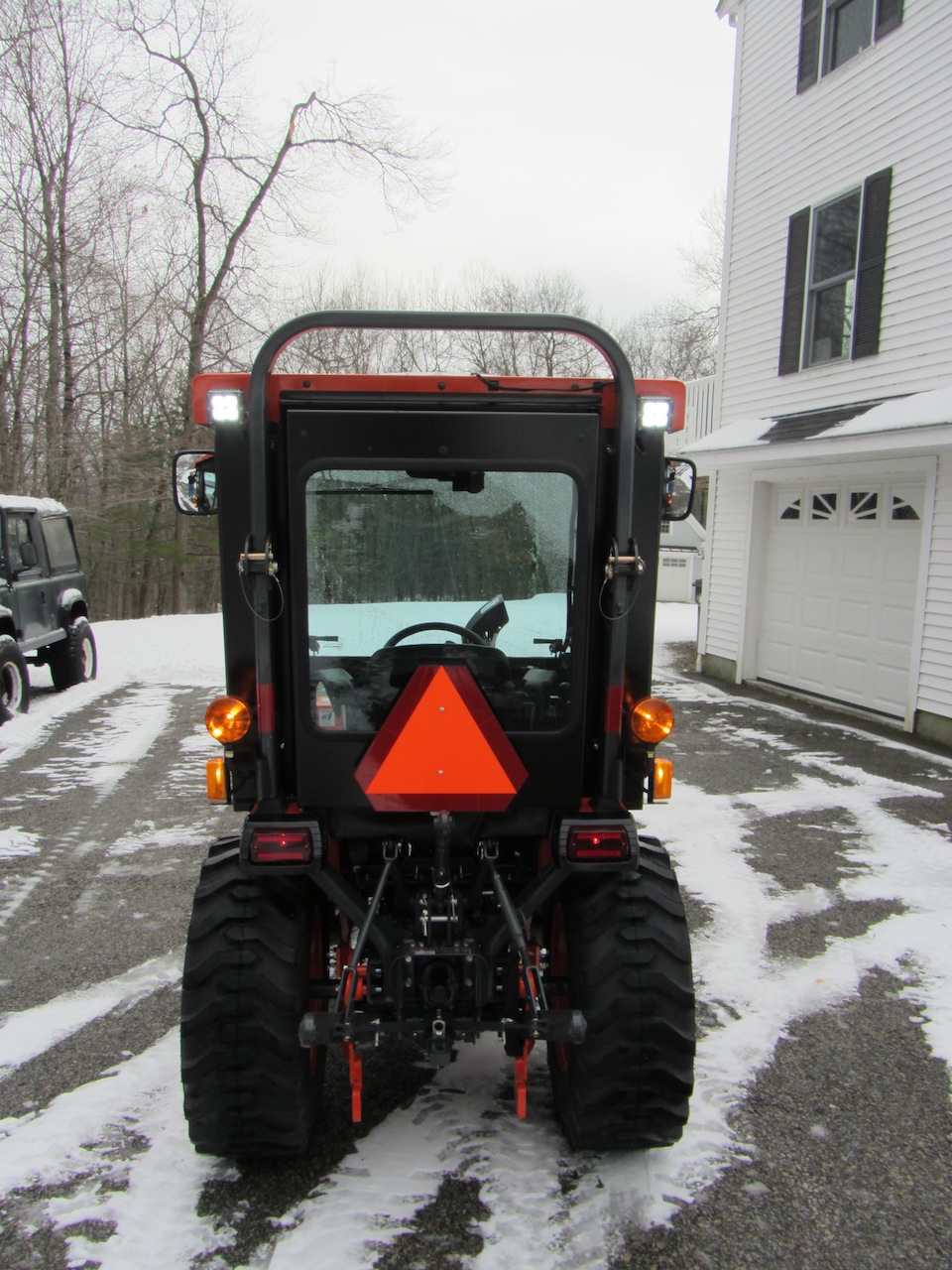

Here's some much better pictures during the day of everything. This should be a lot clearer than the previous pictures I've posted.
I also finally picked up my BX2763A blade over the weekend, but I haven't had time to install it yet and take pictures. Will post pictures shortly.

I just ordered two sets of those Dually D2 lights.
Is it one harness per pair of lights ?
Thanks, Tim
#35
I used one harness for both pairs of lights, however the load on the wires is pretty much at it's limit with the 7.6 amps load. I shortened the wires as much as I could, and I haven't ran into any problems (the wires never got even the slightest bit warm and I ran them for several hours while blowing during the last storm.)
Also, the wiring harness that comes with the D2's is much nicer than the straight Dually's. It comes with a relay and heavier gauge wiring whereas the Dually's don't.
