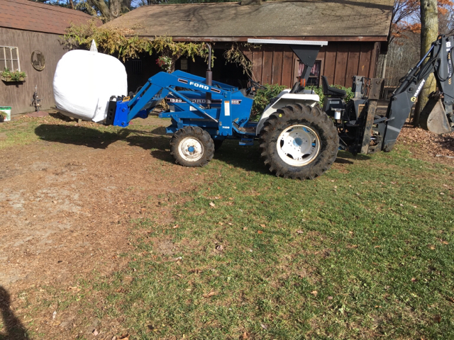

Please post a picture of any 32 hp tractor lifting 4x4 silage bales.

/ B2620 bale spear #9
Oops, just noticed this was about the rear three point hitch. I have to take off the hoe and I'll take a pic, but my 25 hp 1982 Ford 1700 had no problems. This is my 32 hp 1993 Ford 1920 carrying one. Can't lift it much higher about a foot or so. The rear tires are filled, so I can move them without the hoe on.
