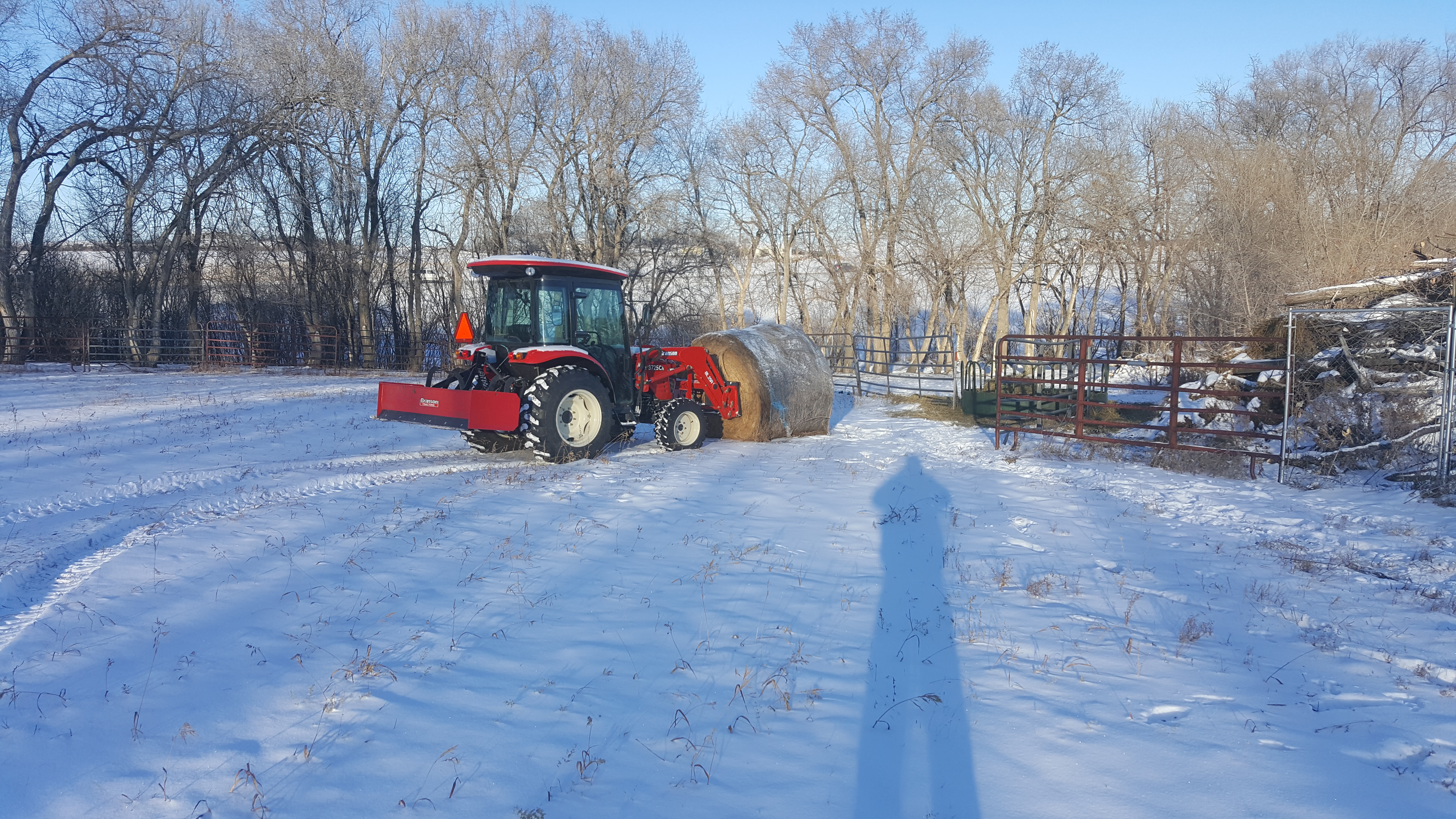

I would say "use caution" when throwing out HP numbers for bale moving criteria. It's more to do with lifting capacity and chassis weight. Those 2 things don't always coincide with "hp".
Here's a 37 hp tractor moving and feeding a round bale with filled rear tires and only a box blade on for ballast. Tractor weighs 7100 lbs so configured (minus the round bale obviously). It will also pick off and set bales on a 2 high stack.
