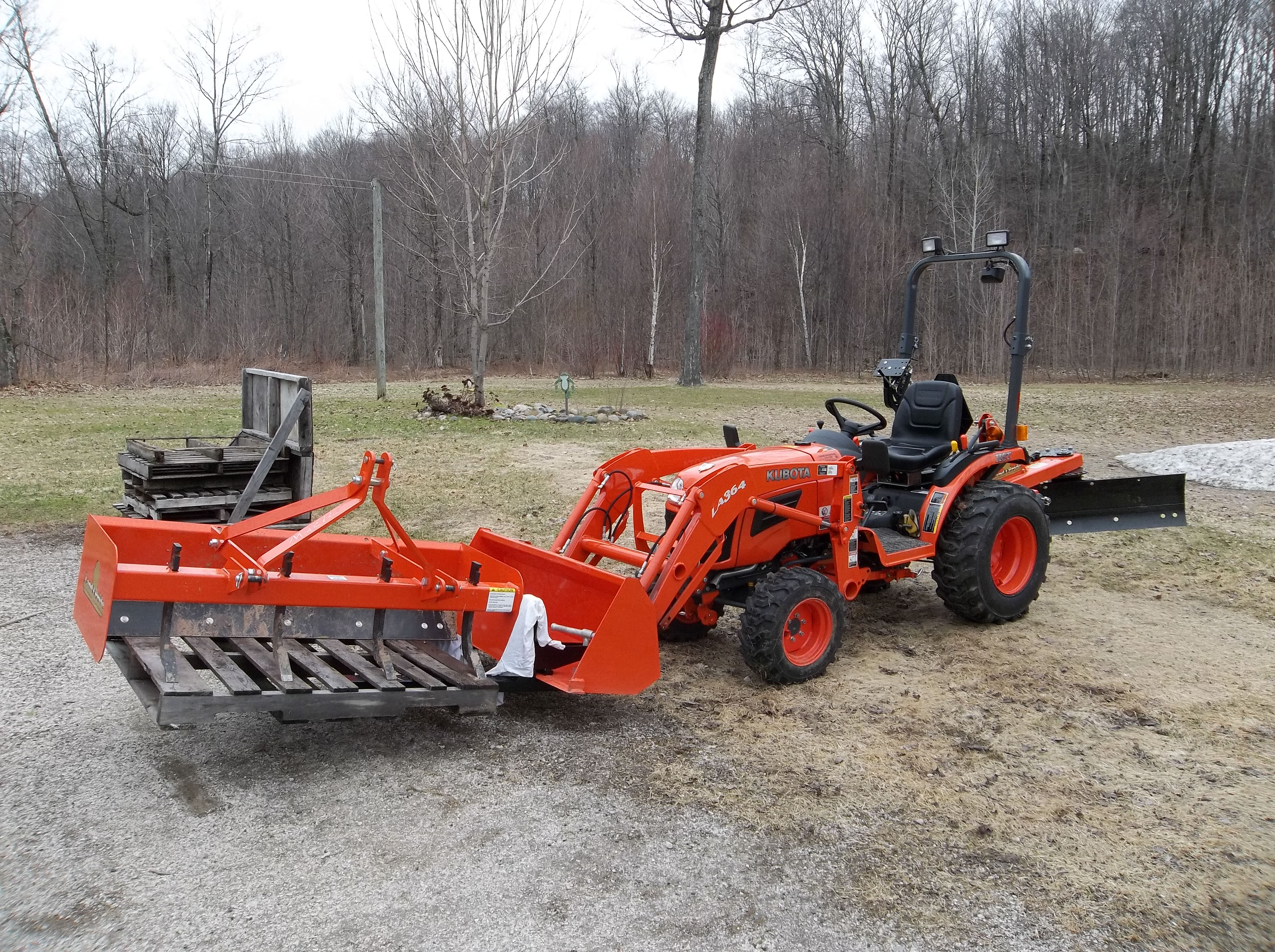

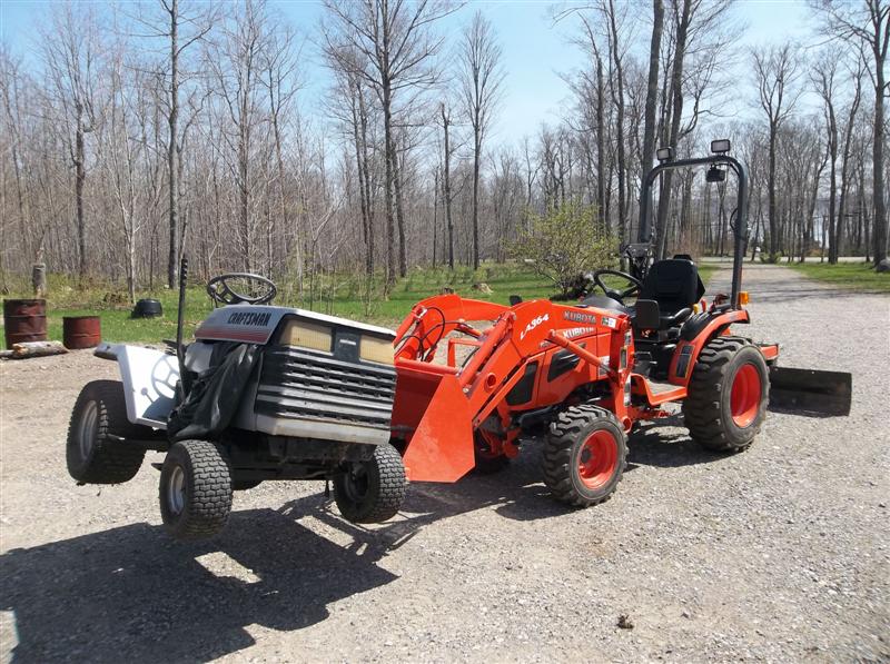

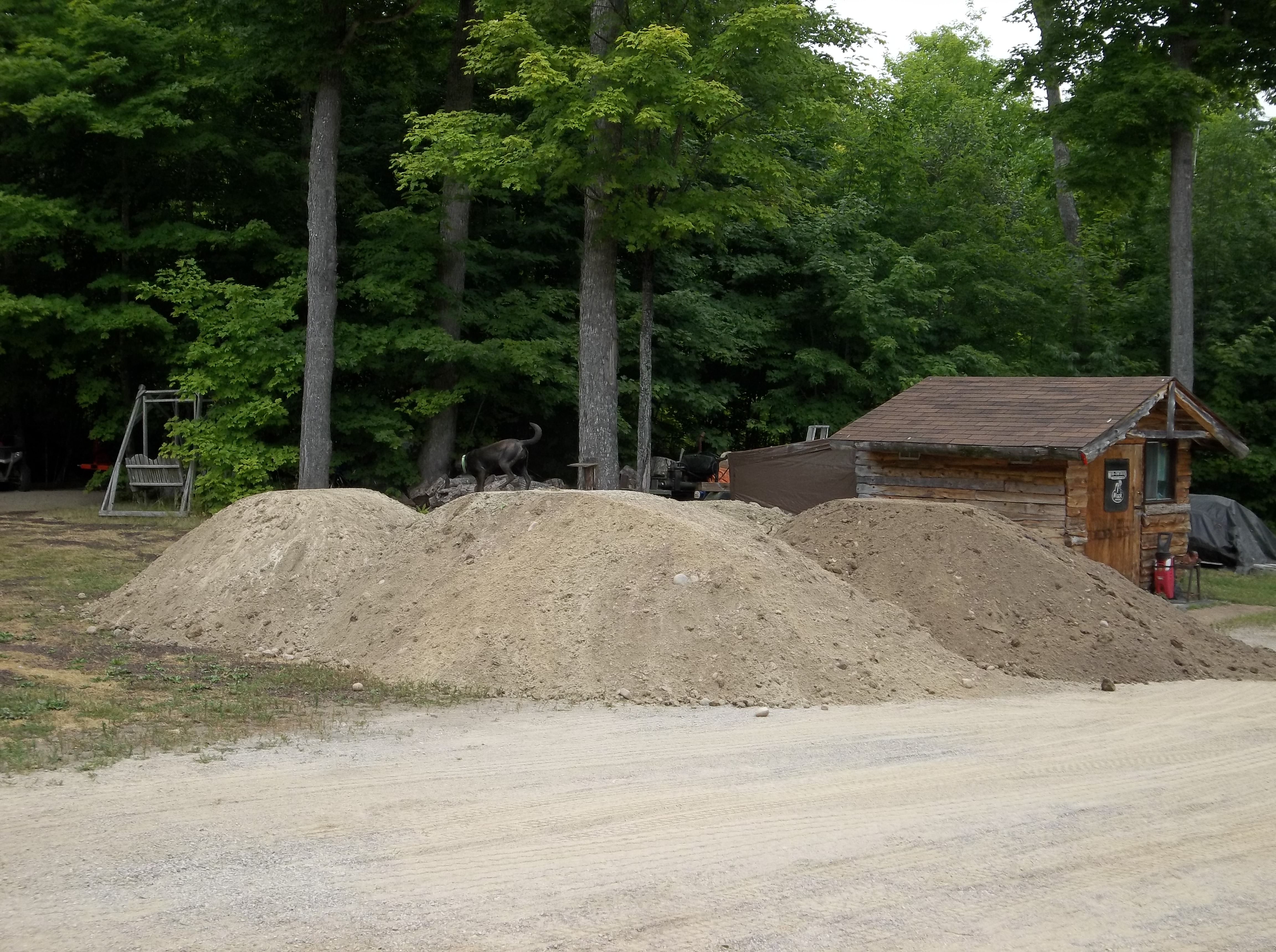

I have pics on all these forums of work I have done. I have moved over 330 metric tonne of stony pit run now and my tires aren't filled. I grab full buckets with only my 60 inch Land Pride box blade on the back and it has never lifted the rear wheels off the ground. Even my angle blade does the trick.

I had a B2920, same as B2620 but with some extra HP, and a full load of gravel in the front loader bucket would definitely make the back end light, and that's with loaded tires and a box blade on the 3-pt. Just having the rear tires on the ground isn't an indication you have enough ballast, and when the back end starts getting light it means the front axle is overloaded. Ideally, you want to keep at least the same amount of down pressure on the rear tires as when the front loader is empty, and that means you will sure need some ballast to offset the front loader's payload. Both the weight and the lever arms come into play. There is a lot longer lever arm from the 3-pt to the front axle than from the loader bucket to the front axle, so rear ballast has an inherent advantage. If you want to do the simple math,
Weight_Ballast_Needed = Weight_FEL_Payload * (Length_FEL_To_Front_Axle / Length_FEL_To_3PT)
Keep that basic rule in mind and you'll avoid overloading the front axle.

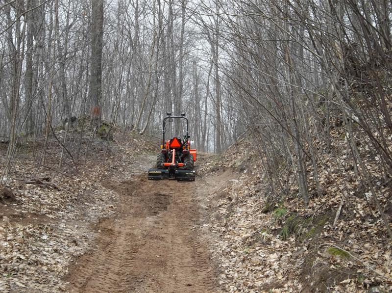

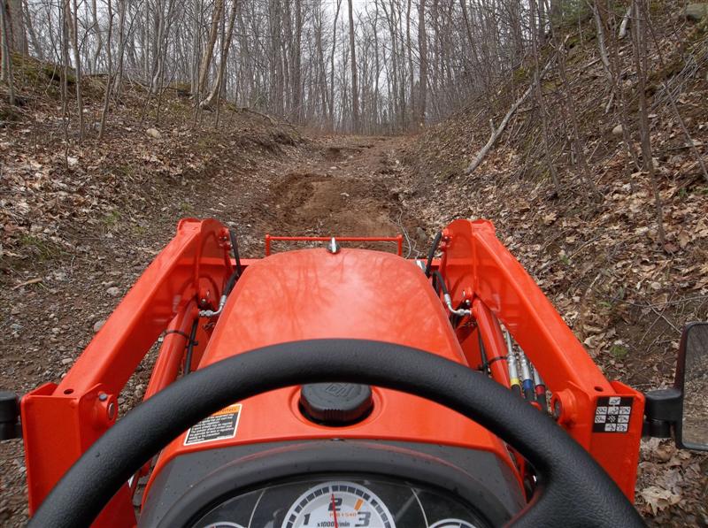

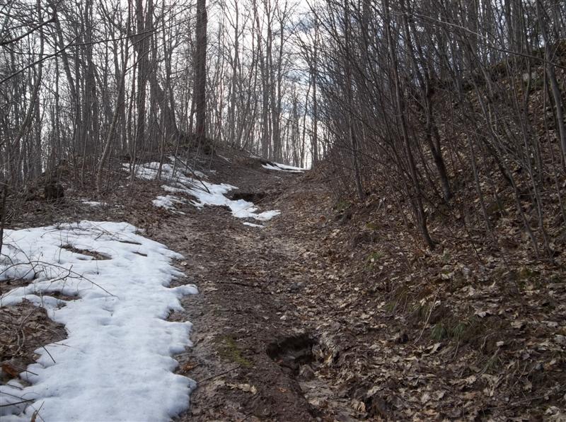

No doubt more ballast is safer, just saying it wasn't necessary. But I don't keep my full bucket way up running up and down these hills I filled in and rebuilt.
