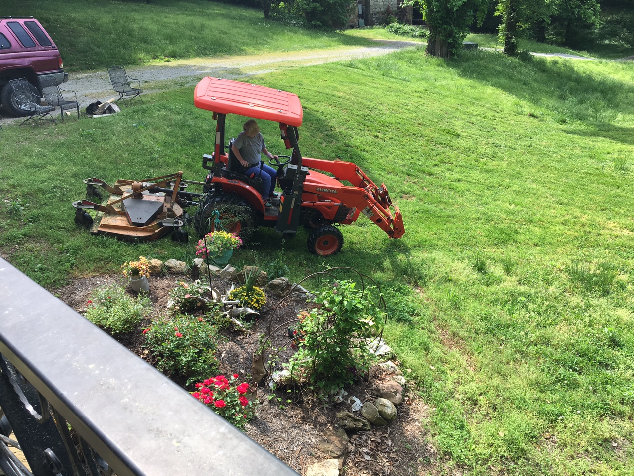

We have tried lots of different tractors and machines over 50 years on our hillside 140ac farm. Best lawn mower is our B26 with a 6’ finish mower. Trims close enough we don’t use a trim mower or weed eater. 1.5” rear wheel spacers and ballast give a solid feel on the slopes. Loader much stronger than ag tractors. Real backhoe. Wife likes to do most the mowing so needed to be safe. Many other custom mods really improve safety and function for our use. Handles mowing heavy grass in orchard, blueberry patch and around buildings. Expensive, yes but over next 20 years use and letting us care for and live at home, priceless.
:applause: It sounds like you have two winners there! If we could all be so lucky! :wink:
The B2601 with spacers and appropriate ballast sounds like a real contender for what I need.

I may be wrong, but Smokeydog's "B26" may be different than the "B2601" that you refer to,, Sid.
The picture looks pretty close to a B2601 to me though, I think his is probably the prior generation. I haven't seen a B2320 but, I think they are all built on pretty similar frames and general specs.
B26 is an industrial grade tractor, loader, backhoe. It is similar in size to the larger B (LX), but with much higher hydraulic capacity and stronger frame, axle build. Not really comparable to the B2301 or B2601.

My b26 is 2016 and same as the current model. They are tlb commercial class. Heavier built, scary strong hydraulics, durable and expensive. Price one and see a big difference over a b2601. My terrain is too rough for a mid mount mower. Like the 3pt woods rd7200 finish mower for cut and durability. Had a first gen b20 tractors for over 20 years. One of the most handy tractors on the farm. Could go and do things the bigger tractors couldn’t. Being able to do things we would have had to hire labor or machines before makes pay back cost effective.
Work around trees is tough so plan on adding extra armor to what ever choose.
