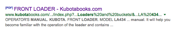

Hey everyone.
Off hand, does anyone know what the weight of a B2601 with LA434 FEL and BH70 BH attached? Will be shopping for a trailer soon.
Thank you!

/ B2601 Weight? #6
  • LA 434 Kubota Front Loader Operator's Manual-2.pdf
