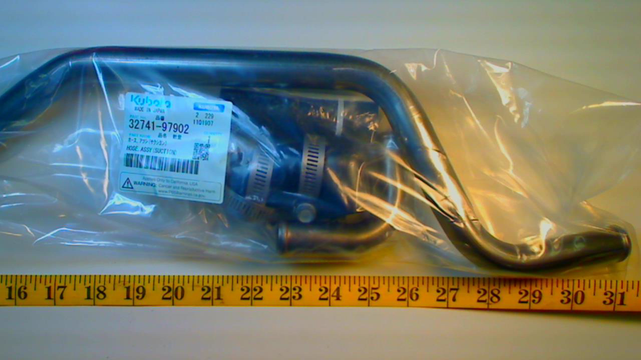

I had an issue with totally random (seemingly) stalling.
Only when the machine stopped moving, but the loader was fine did I think to address the suction boot that has gotten me before with the same issue.
Just ordered the new new new boot kit. Hopefully they actually figured it out properly this time, as it is the FOURTH or FIFTH time of trying apparently.
In the meantime if you want to get going again, just wrap some decent quality duct tape around on the hole in suction hose rubber boot and it is good enough to get the machine moving again and stop the stalling issue.
Kubota #32741-97902 HOSE,ASSY(SUCTIO Installation Tips
$34.31
3 In Stock
Product replaces 32741-39112 32741-39150 32741-39160 32741-97900
