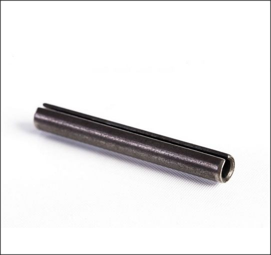

Anyone know what this is? Some kind of cotter pin?
Do you use a punch to knock it out?
First pic is source of the question. (It seems to be the last thing holding the hst pedal against the frame).
Next pic is for reference. Last pic is current state of tractor.
All in all glad to be doing this. I’m sure I’ll save some money and learn a bit by doing it myself.
It's called "rolled spring pin" and they can usually be removed by gently tapping with a hammer & correct size punch.
Before hammering excessively, just consider what is happening to the bearing supporting the shaft on the other side of the pedal(s) and act accordingly in order not to damage the bearing.
IE. Support the end of the shaft if needed.

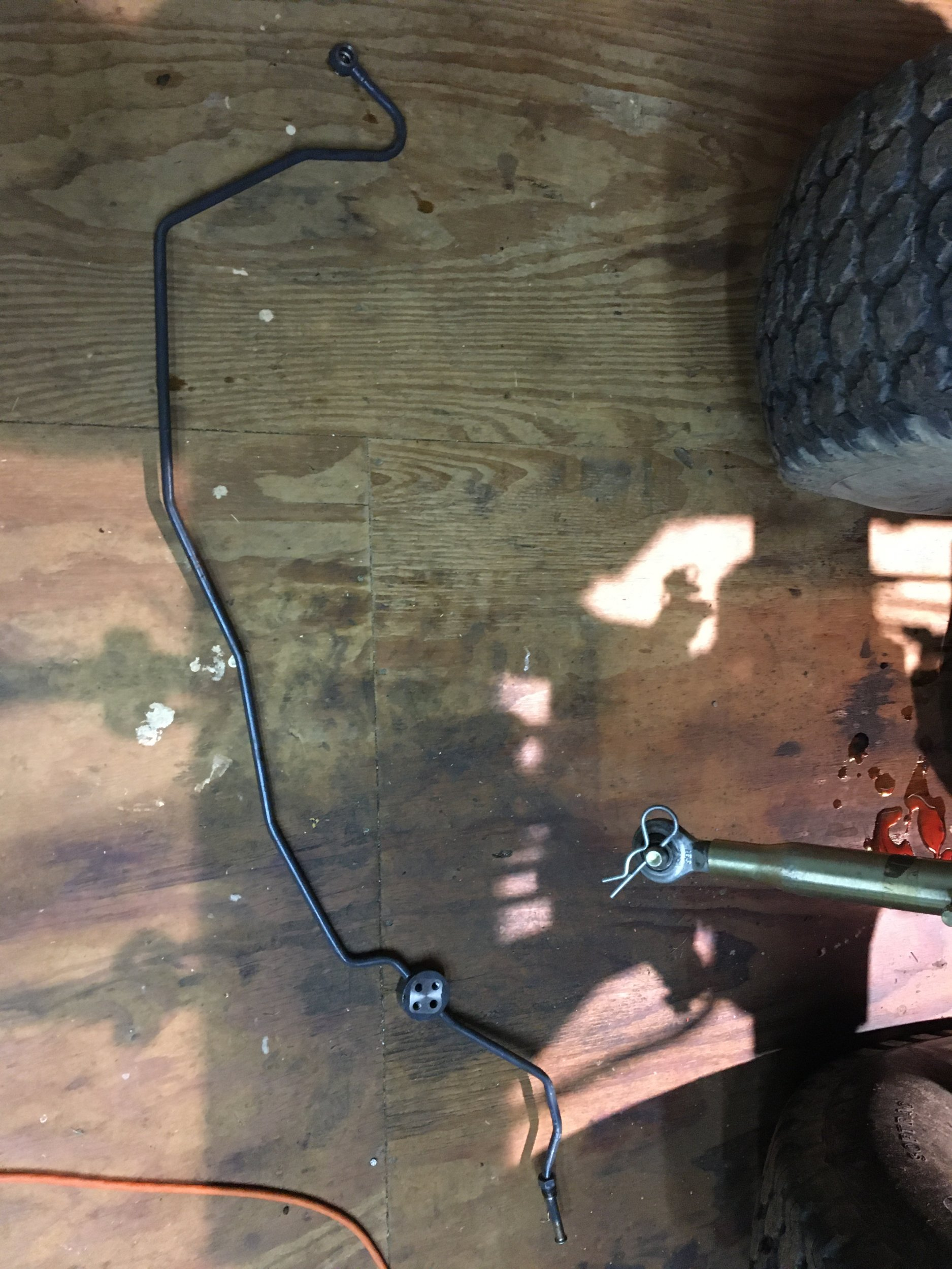

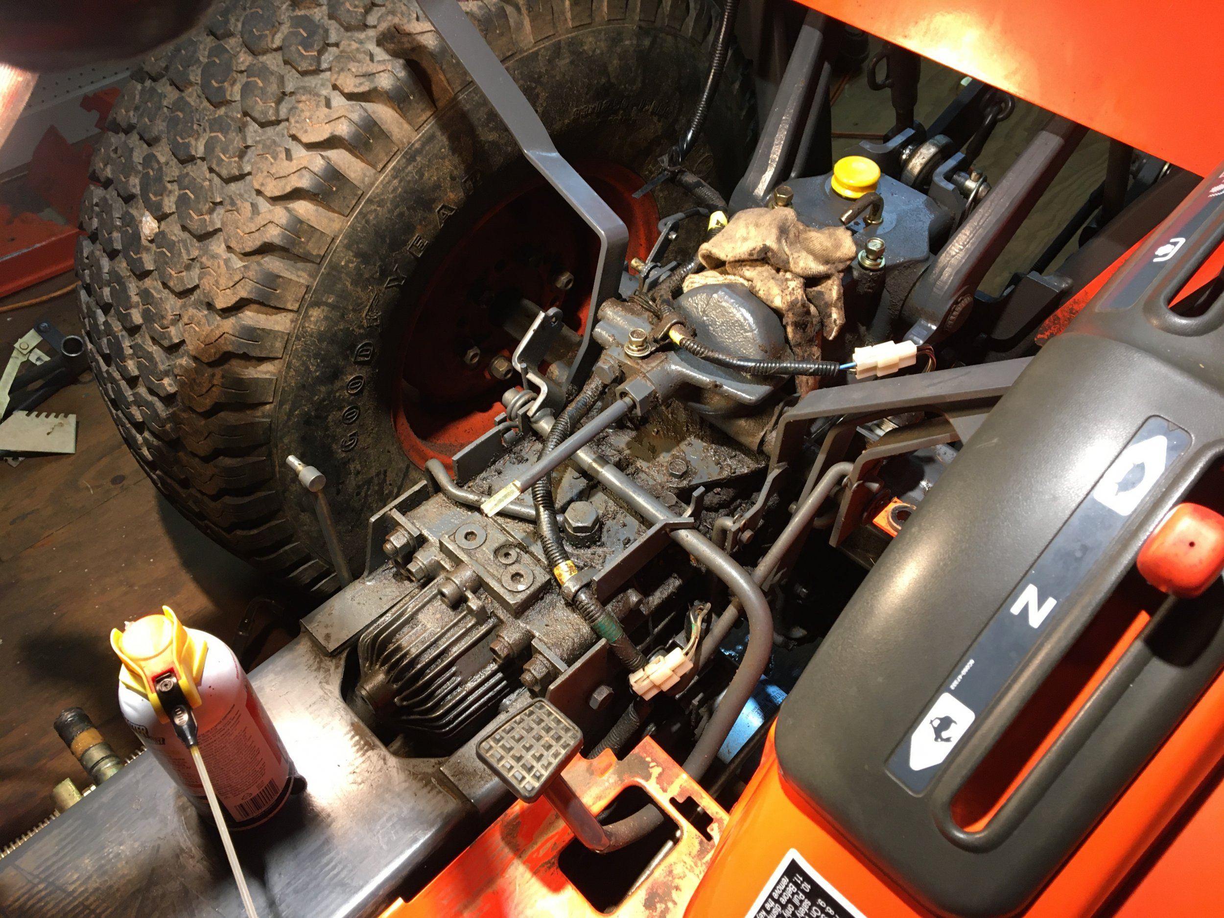

Finally got line off. In addition to removing al the items I mentioned earlier I had to remove the tool box, the seat base, the three point position lever, the linkage for the differential lock, the housing for the hydraulic dip stick, the hydraulic hose that feeds my FEL, and completely remove the brake and hst linkages. And it was still tough to snake out without bending the steel line too much.
Whew!
First shot is of the removed line. Second is of the tractor in its current state.
