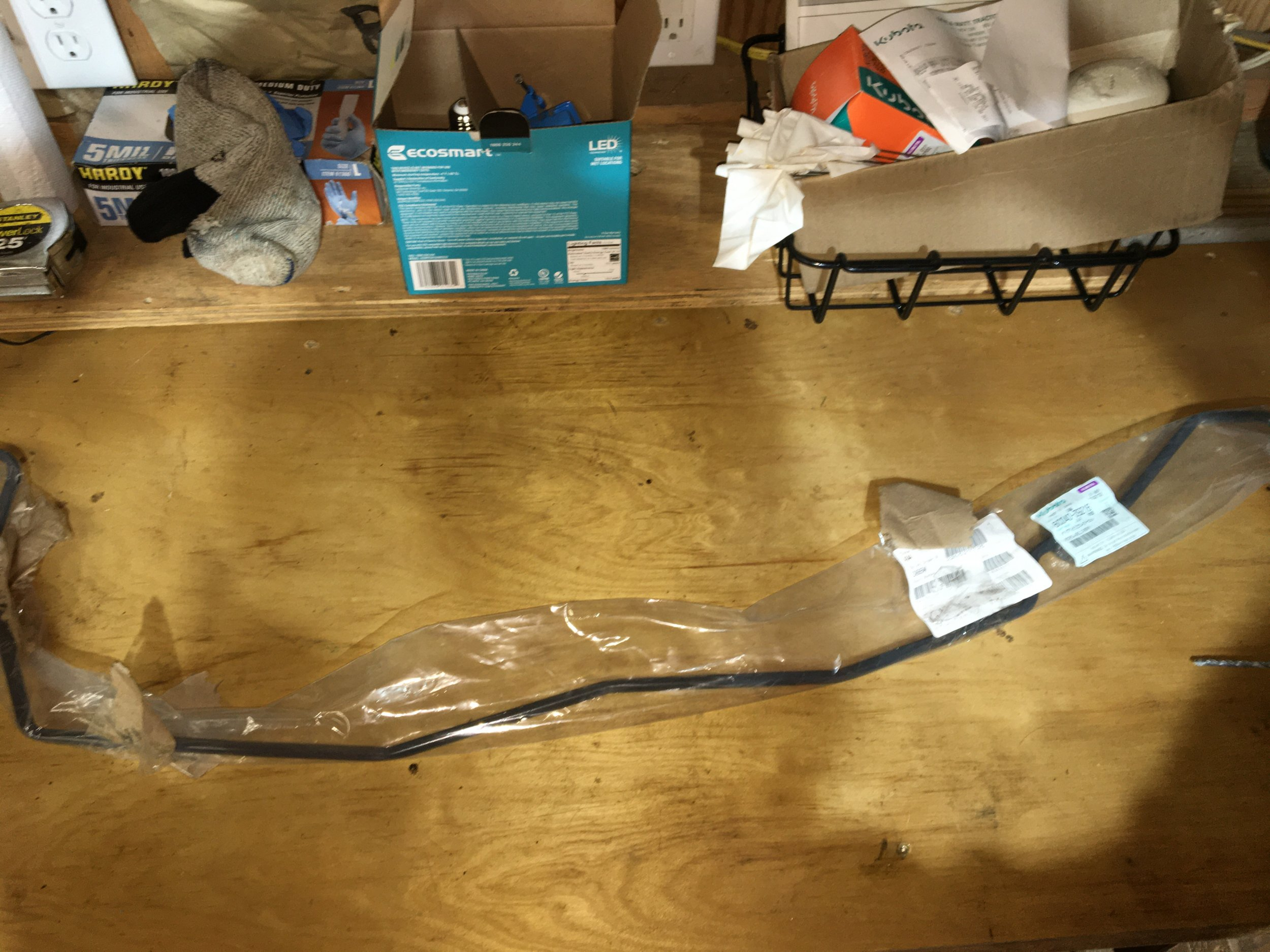

I need some advice.

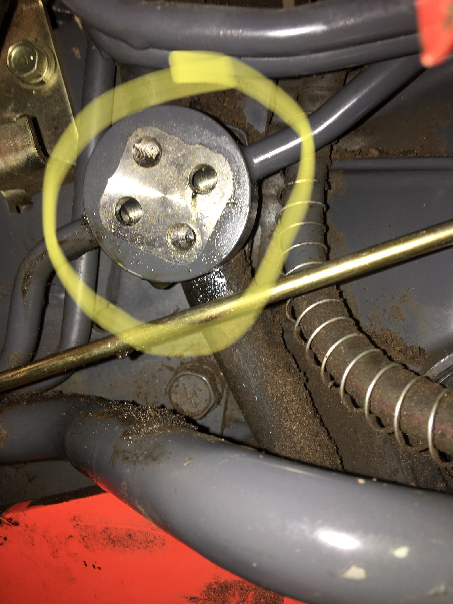

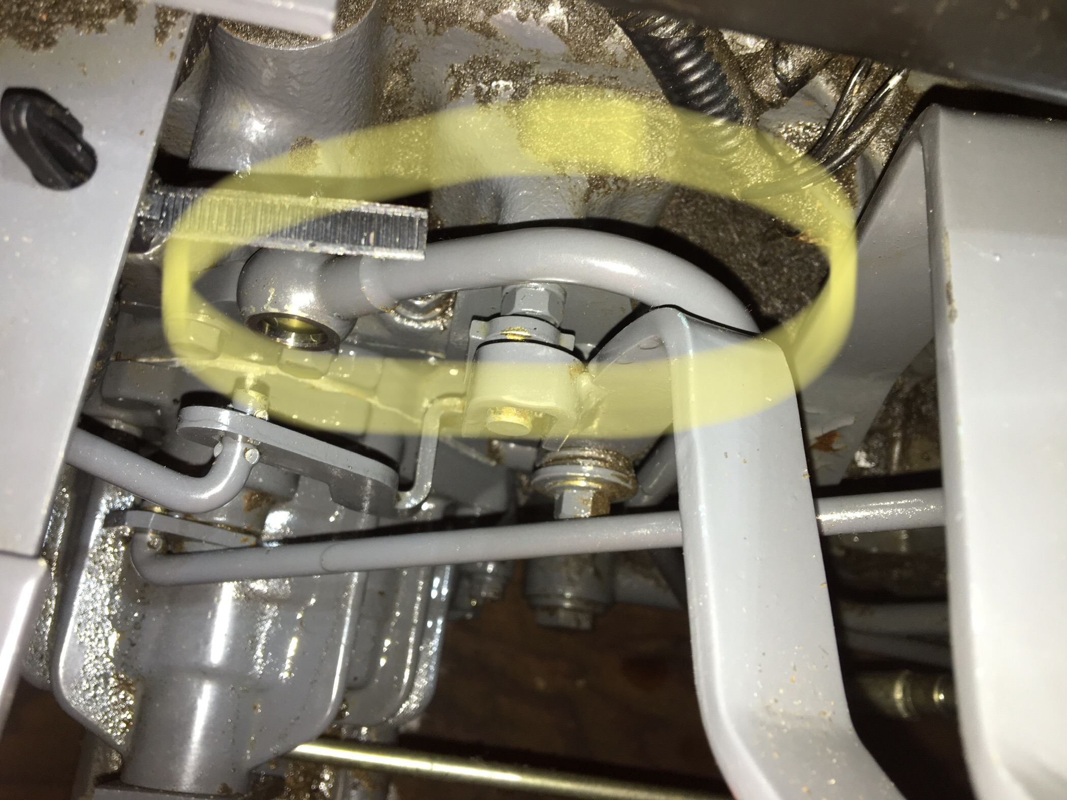

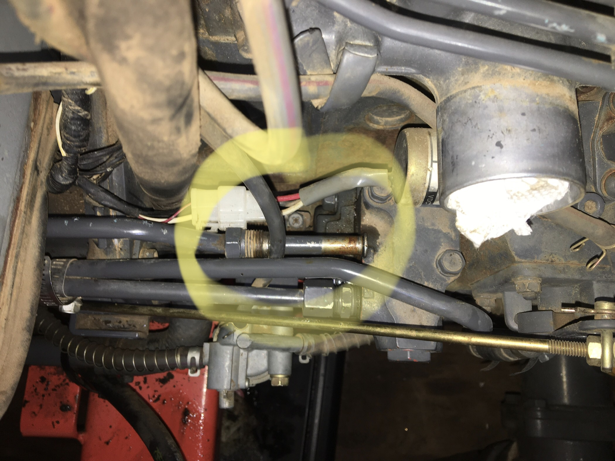

I’m trying to replace the steel hydraulic line that runs from the front all the way to the back just below the seat (right hand side off on seat and facing forward). This is the line connected to the three point hitch.
It had a small crack and would spray out hydraulic fluid whenever I raised a rear implement.
I’ve finally got the replacement line (1st photo) and have taken off all the places where the existing line attaches. (Next three photos)
However seems impossible to remove or snake this line out.
Before I start removing half the tractor trying to get to it…. Has anyone done this before and is there a simpler way I’m just not seeing?
Ant advice is appreciated.
Thanks!

You may have to resort to some compression fittings to get the line in place.
Steel tubing lines can be bent but this should be done with the proper size tubing Bender. There will also be angled compression fittings.
An alternative is to reroute the line Or just replace the failed section.

Replacing is what I’m trying to do. My issue is that even though I’ve disconnected the old line, it seems like it’s impossible to get out. I even more worried about trying to snake in the new replacement. I’m thinking I’ll have to remove a few things to get to it.
I’ll try and document as I go. My understanding is that while this isn’t a common problem, kubota has made at least four design upgrades to this section of steel hydraulic line so obviously it’s been a problem for some folks.

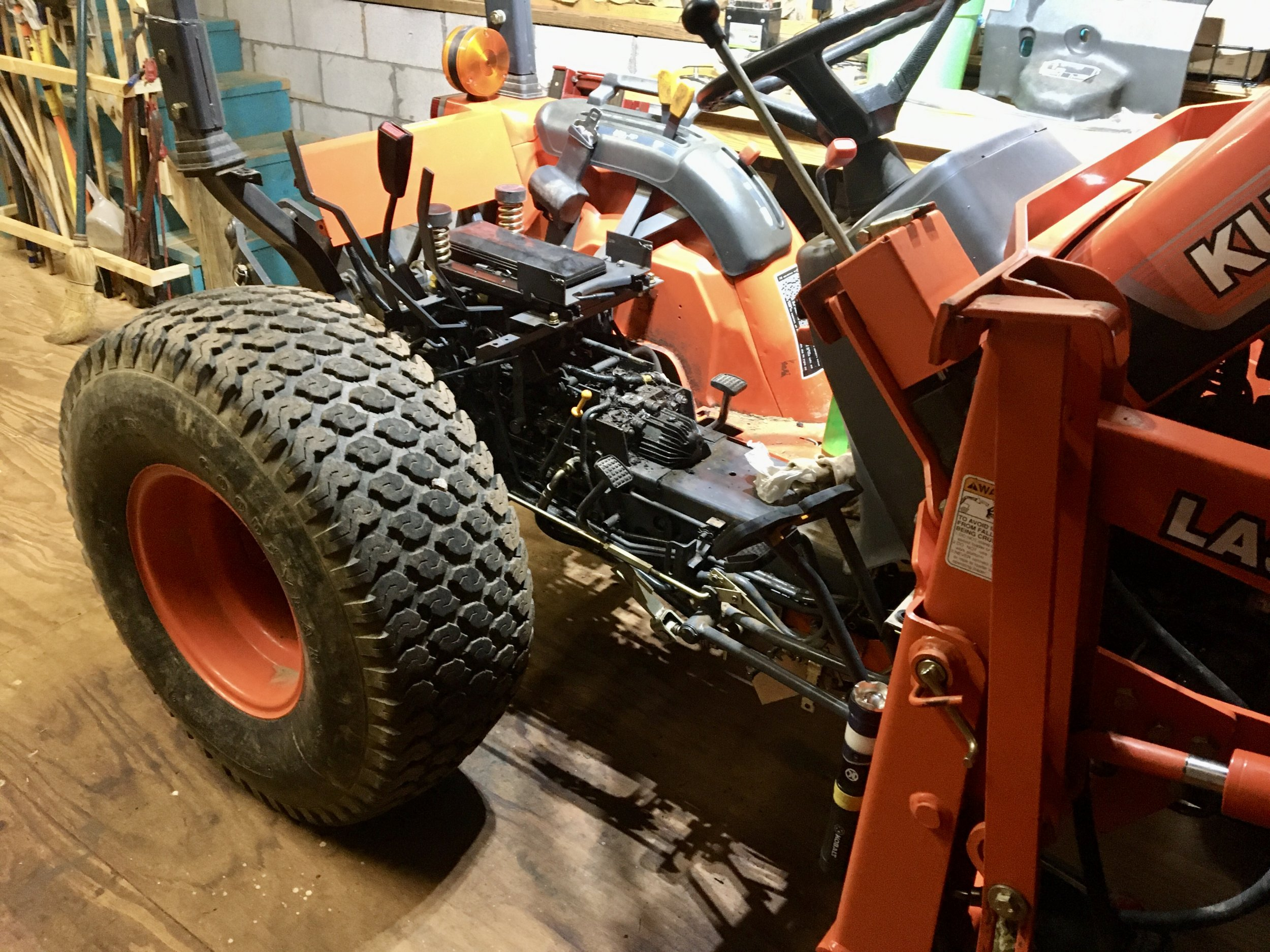

Started the steel hydraulic line replacement in my B2400. (Line that serves the three point hitch).
Turns out you need to remove (in order):
the seat,
the knob for the relief valve,
the black plastic cover that is right under the seat and surrounds the relief knob,
the knobs on the hitch & 4 wheel drive levers,
The black plastic that sits on top of the fender and surrounds those levers,
the tail and hazard light,
the right rear fender,
the rubber floor mat,
the floorboard,
the link between the floor board and the Hst pedals,
and several linkages on the right side below the floorboard for the brake and hst pedals.
And…almost done….

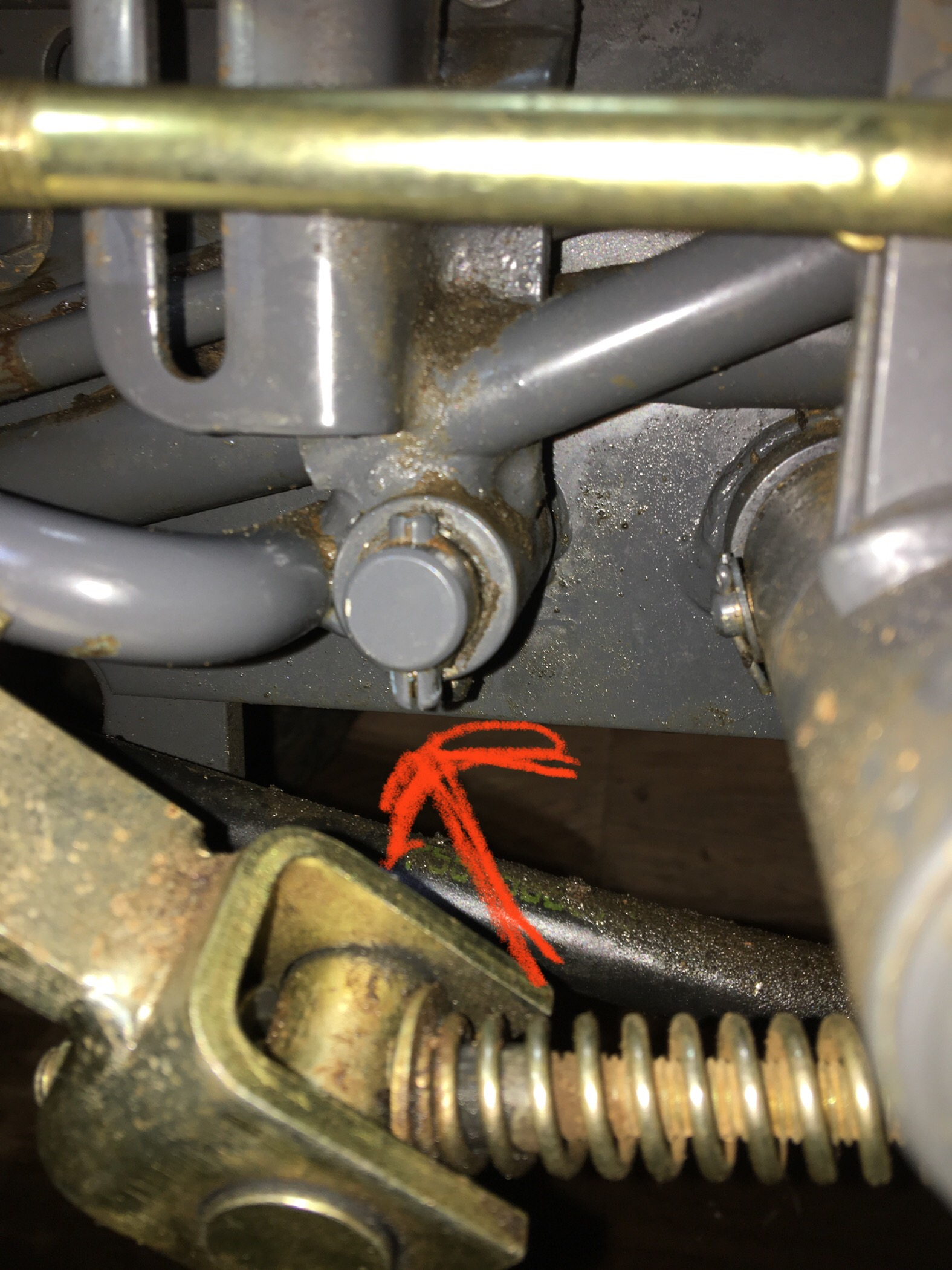

Just have this one last item to remove.

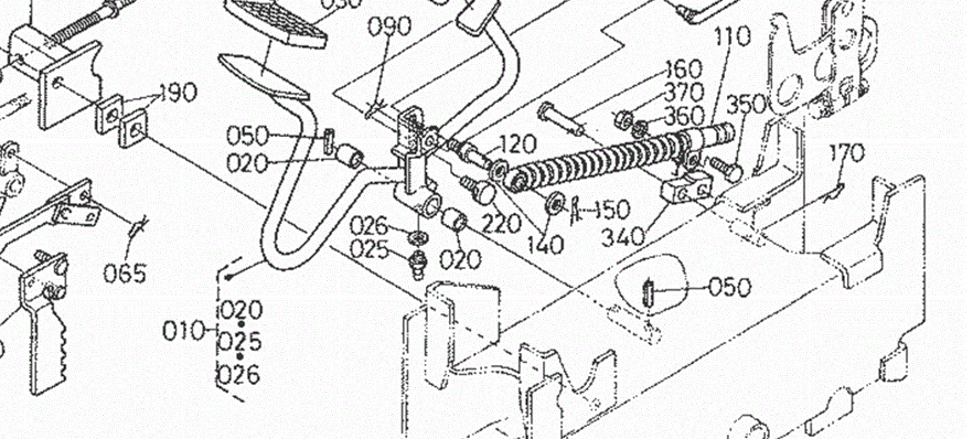

Anyone know what this is? Some kind of cotter pin?
Do you use a punch to knock it out?

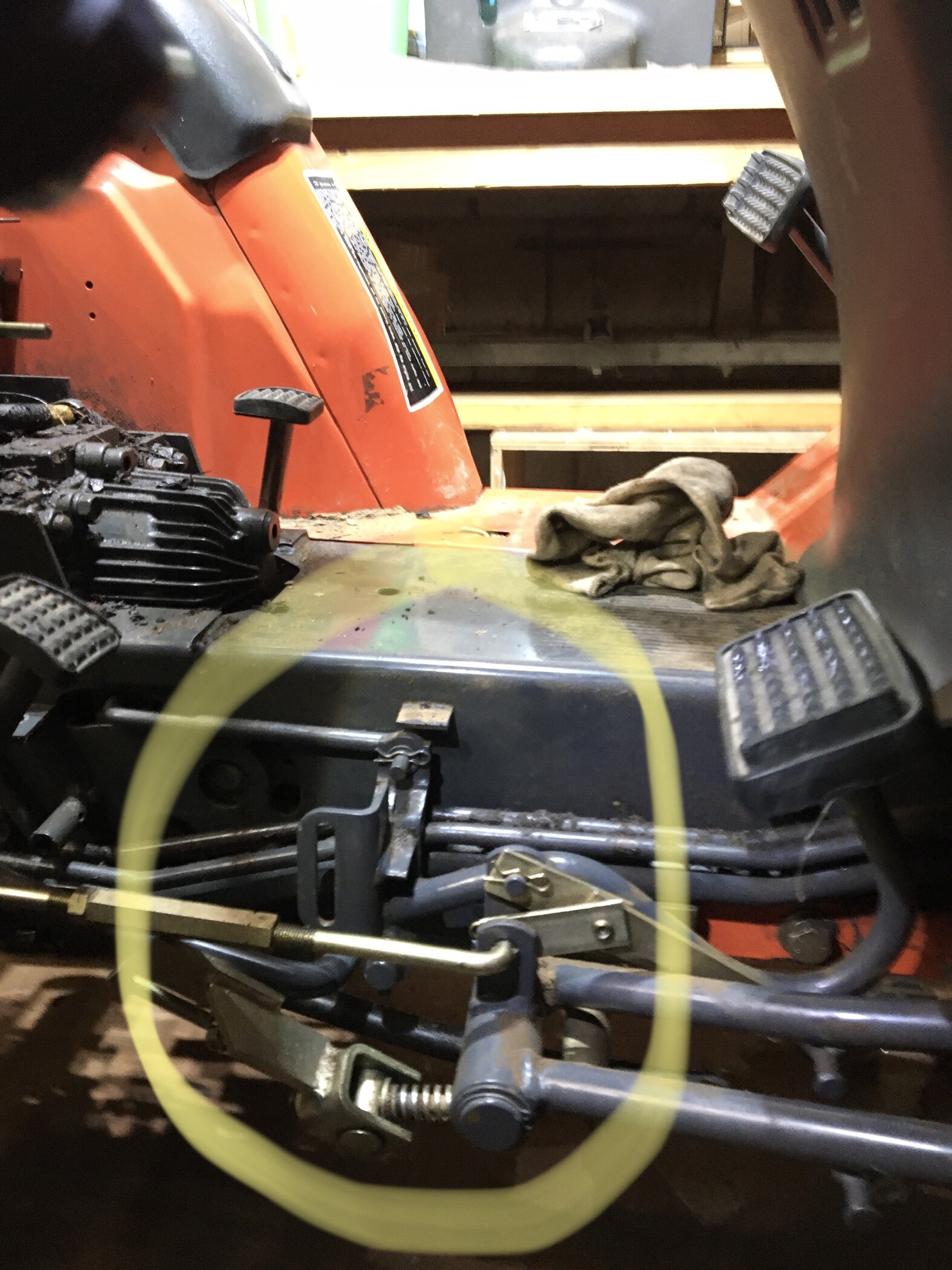

First pic is source of the question. (It seems to be the last thing holding the hst pedal against the frame).
Next pic is for reference. Last pic is current state of tractor.
All in all glad to be doing this. I’m sure I’ll save some money and learn a bit by doing it myself.

That's a roll pin that's tapped in there to hold that assembly together. You can find parts diagrams online. Messicks is a great resource.
I would not be taking all that apart to fix this line, but I admire your determination.
