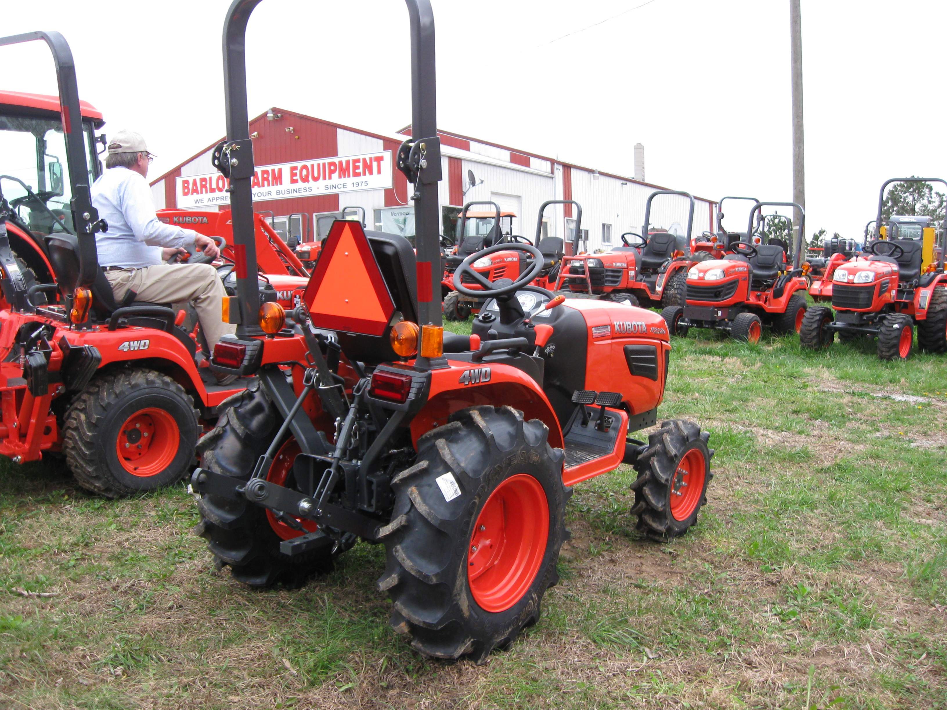

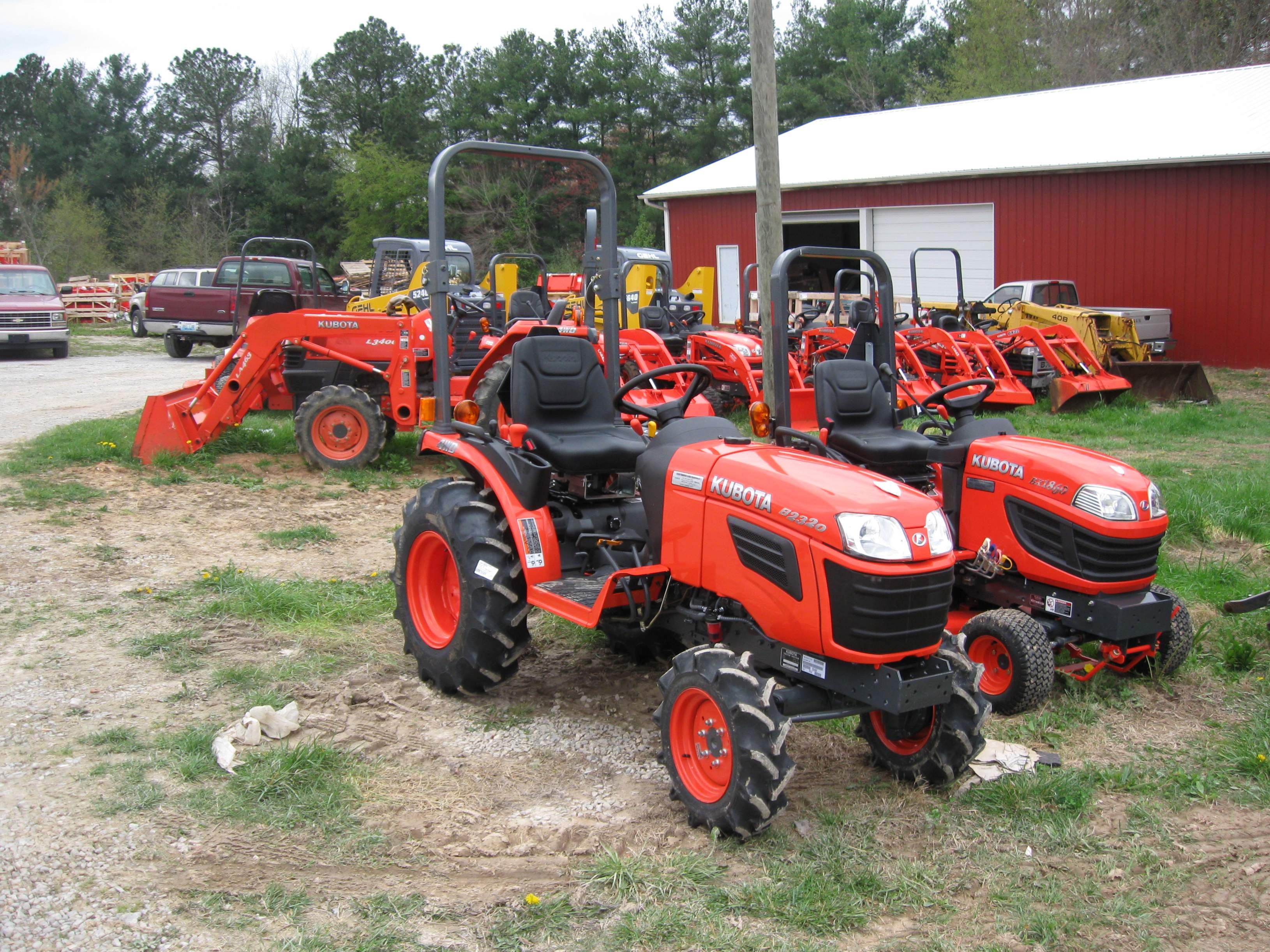

Here are some pictures I took a couple of days ago.
