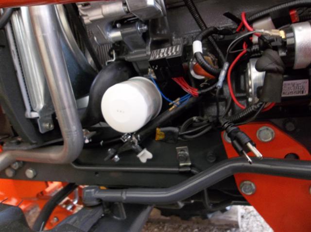

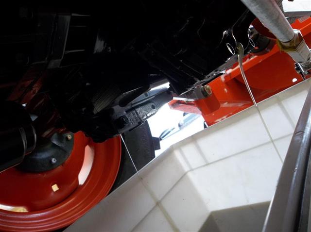

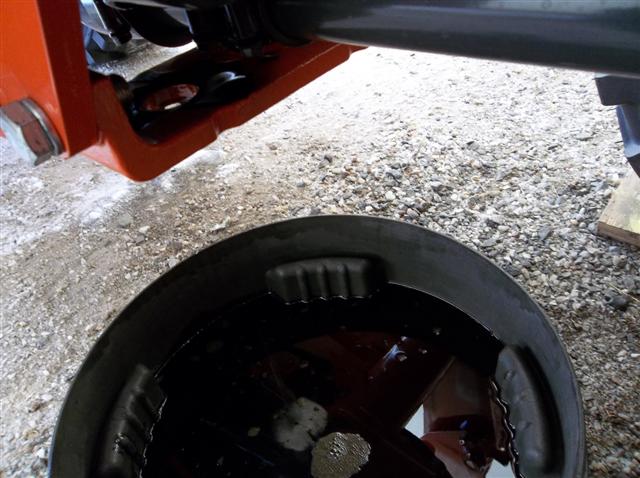

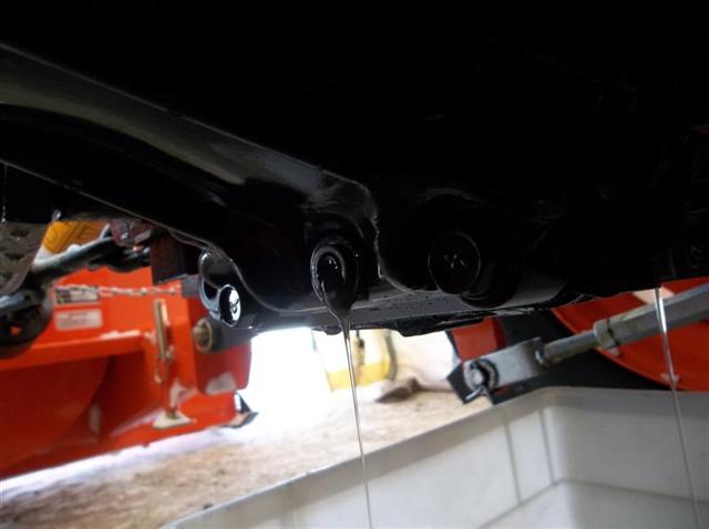

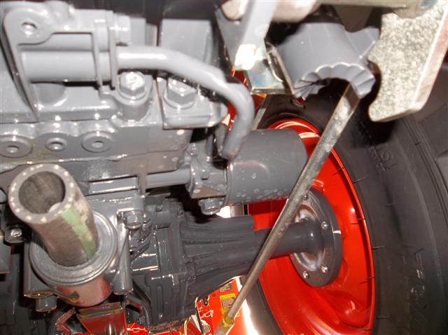

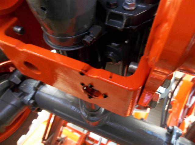

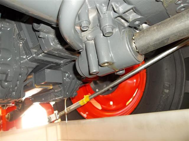

It's very simple to do your service. But the owners and shop manuals don't give very precise details or pics. Here's what I found for draining the trans/hydro on my B2620HSD. Pic #1 is what both manuals correctly show.
Pic#2 is the 12mm I removed which is a gasketed drain plug. Manuals show you to remove the 14mm housing bolt which is just ahead of it.
Pic#3 and 4 are the 12mm drain on the right side. Again, manuals show it as that 14mm housing bolt to the right of the actual drain plug.
Pay attention to the gasket washers.....mine were painted on and didn't look like there was any, but one fell off into the drain pan as it was draining. 1 (Small).jpg2 (Small).jpg3 (Small).jpg4 (Small).jpg5.jpg

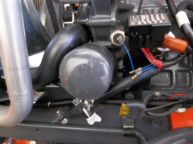

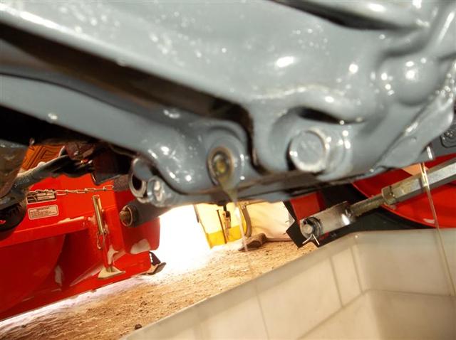

Pic 5 is the engine oil pan drain plug. Manual shows a double sump oil pan with two drains, mine only has a single with one plug.

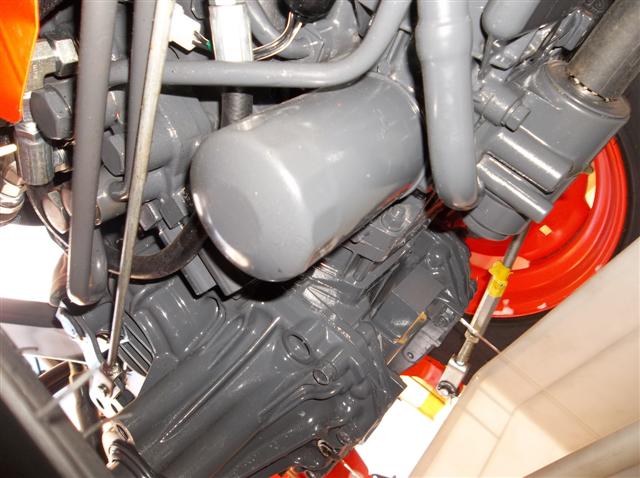

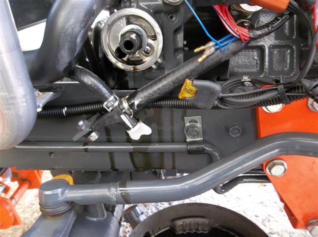

Here's a couple more pics of the 50 hour service. I just use a regular auto drain pan for the engine and front axle.
Just be careful threading the new engine oil filter back on so you don't cross thread it because the rad hose rubs on it. Not real bad, but it does add minor resistance.
And as you can see the trans/hydro filters are very easy to get at. I've heard stories of how tight some are on due to the paint, but mine came off easily.
I use the drain pan from an old dehumidifier for that. Had it for my diesel pickups.
Also note.......the owners manual says to just change trans/hydro filters at 50 hour first service and I see some people on here do leave the oil in. But the Shop manual says oil MUST be changed at 50 hours. And I wouldn't want to leave the break-in oil in there for 200 or 400 hours.1.jpg2.jpg3.jpg4.jpg5.jpg6.jpg
