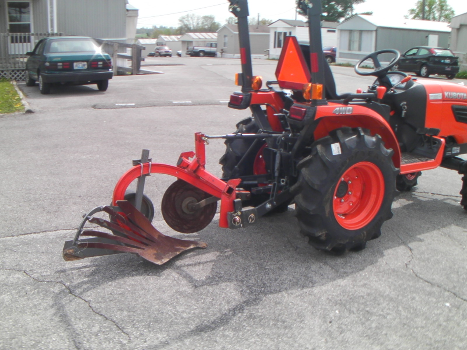

I'm looking at a B2320 narrow in the hydrostatic drive. Its 37 inches wide. The B2320 standard says it's 45.1 inches wide at the minimum tread. However I think that is with R4 industrial tires. I think the AG tires on a starndard B2320 mine bring the width down to about 43 inches from what I can tell. Anyone out there that has a B2320 could you go out and measure it to see how narrow you think it would go front and rear??? hahahah.......Thanks very much......I'm leaning to the narrow for the position control....going to be just a garden tiller flat land tractor.

The way Kubota lists the specs on the B2320 is weird to me, all the way around. They state the width/height, etc on the 2320 as being "different" from the 2620/2920, but that is with different wheels/tires on them. Really odd.
The spec sheet shows the 2320 with smaller tires than the 26 or 29, but when you get R4, all three tractors are fitted with exact same tire and wheel and the dimensions equal out are then the same.
Sooooooo, I suspect the specs, as given, might actually be with turfs or Ags, with the 2320 having a slightly smaller turf or Ag standard, thus creating the dimensional differences in height/width, etc.
I have R4s and my 2320 is indeed 49 width. Having seen pix of John's with Ags, I am certain it is at least 6" narrower. (tomorrow will tell the tale)
Of course, none of this applies to the Narrow anyhow.
/ B2320 ag tire users! #5
All the dimensions for the Kubota B-series are given with ag tires as standard equipment. This is why there are some differences between the B2320/2620/2920 dimension wise (different size ag tires.)
Thats what I thought also. But my mom's B3030 has R4s and the Kubota site list 54.1 inches minimum tread.......that is what it is......54 inches wide on the button with industrials. Looking at the tires its hard to imagine the AGs not being more narrow than her R4s.

The large B-series use the same size, 12.4-16, for both Ag and Industrial tires.
An easy way to get a close measurement to overall width is to take the 'tread' measurement posted in the specs and add the width of one tire. For example, with the B2320 on Ag tires, the tread is (35.5) + tire width (9.5) = 45"
For the Industrial tires, it would be 35.5+12 = 47.5" (this may not be exact, but it will be close)
This formula is also nice to figure the different widths of tractors with multiple rear tread settings. Like the B2320 narrow which can be set from 35.5 to 37.5" overall width, IIRC it can go even wider if you flip the rear hubs.
/ B2320 ag tire users! #11
Or even easier is get a tape measure and measure the distance from the outer edge of each tire, if you have one. Believe it would be more accurate. I'll do that on Monday, already have a note to myself to do it.:)

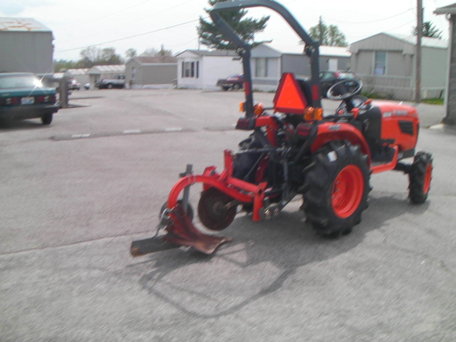

Went out today and measured (had my note to self) the distance from the outer edge of the rear Ag tires on my B2320. Looks awful close to a bit over 45" to maybe 46"s depending on how much air is in the tires to make the sides more straight up or a bit rounded.
#13
Thank you very much for the measurement and the pics. Picture is worth lots. Thanks again.
