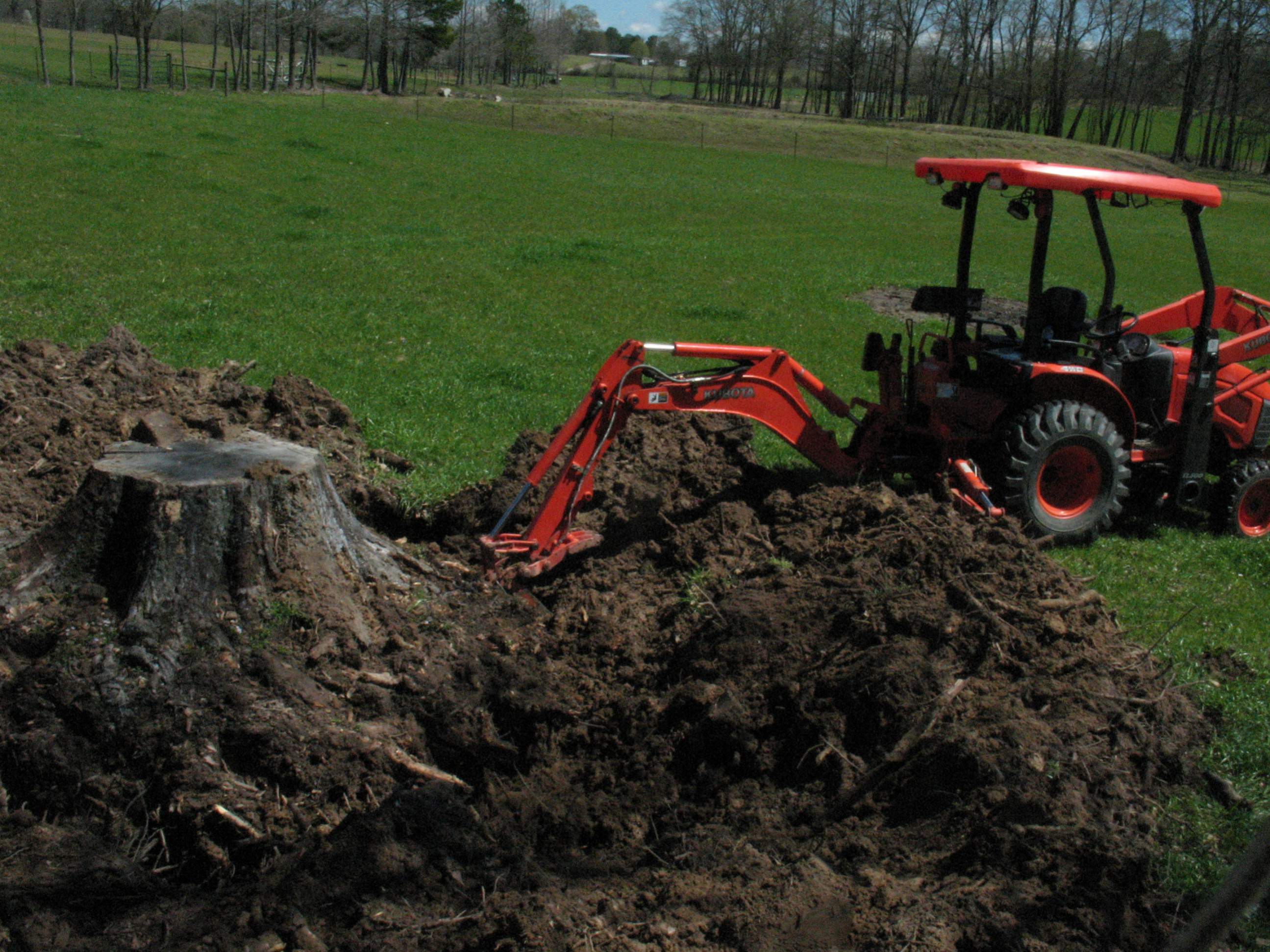

The B21 is a professional grade machine compared to a homeowner quality of the B 7500. They were likely twice as much new as the B 7500. I have B 26 (latest model -B20,B21 then B26and new now they list for over $40K. The B21 would seem to be the much better deal for a back hoe. If you can check the specs, I think you would find you would find big differences in digging force on the two. I don't think you could put a backhoe on a tractor without a FEL, it is needed to stabilize the tractor when digging and of course to move the dirt after digging. I would go for the B 21 personally. Does it have the 4 post FOPS system? Some had it and others just had a ROPS. Here is a photo of mine digging up a "small" stump.
