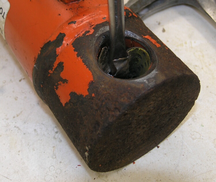

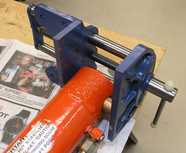

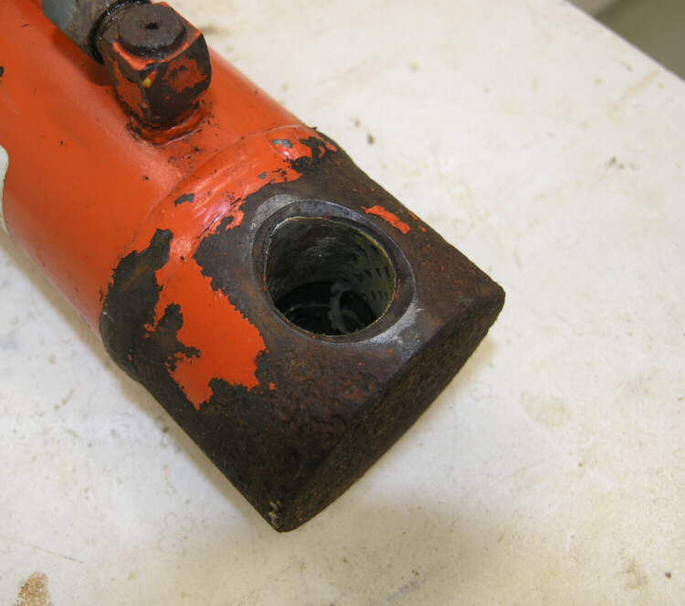

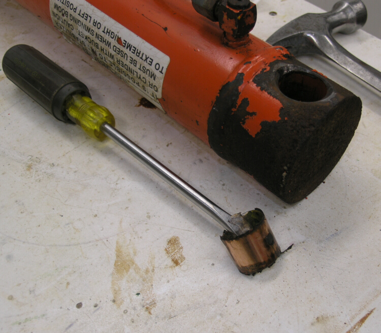

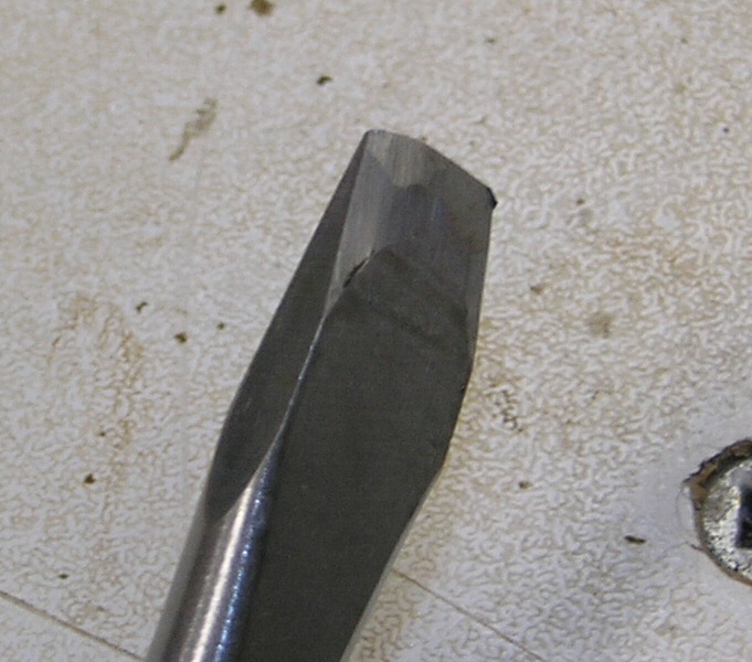

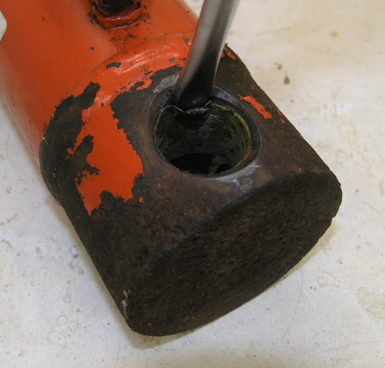

Back to my original problem of removing bushings (before I got sidetracked with the frozen pins).
After a little trial & error I found an easy way to get the bushings out:
1) Take an old screwdriver & grind its end to a chisel with a radius on the back. Try to get it close to the radius of the bushing.
2) Drive it between the bushing & bore.
3) Collapse the old bushing.
The rounded back of the chisel leaves virtually no marks on the bore. If you use a regular screwdriver you get 2 nice parallel lines. oops.
By the way, does anyone know why the cylinder ends rust? Every cylinder on my machine is the same.

Moisture and poor paint job as in one coat.

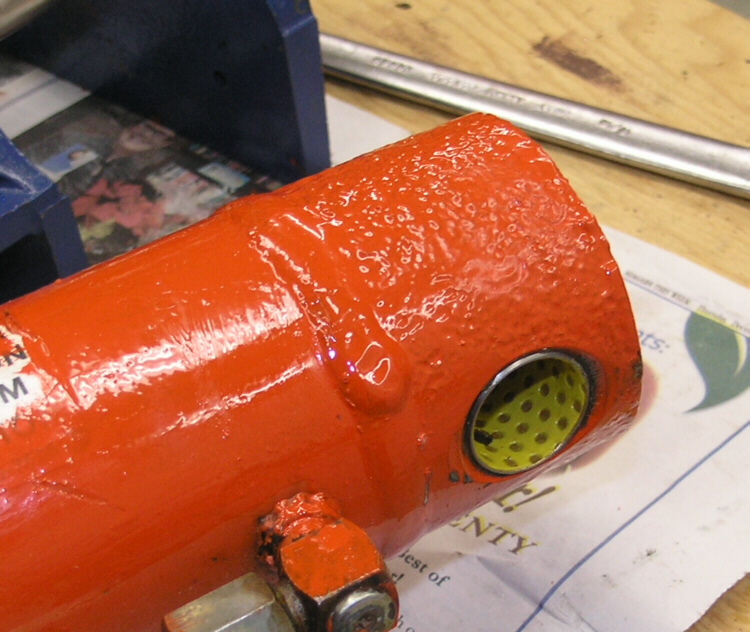

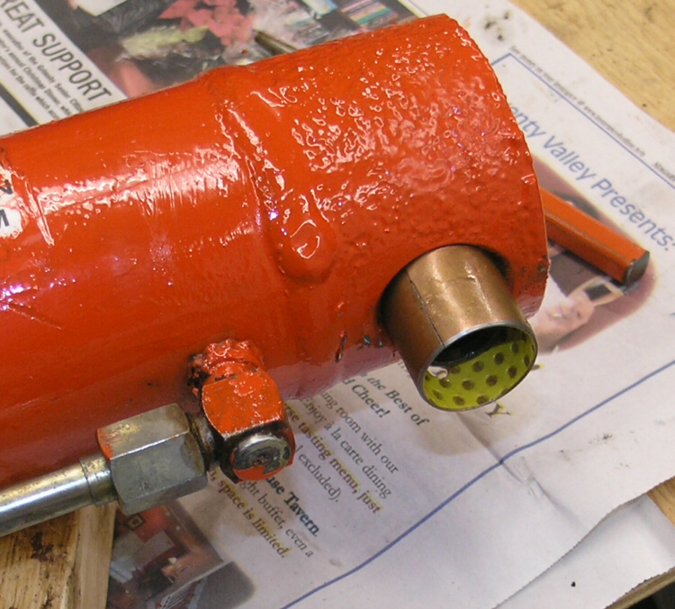

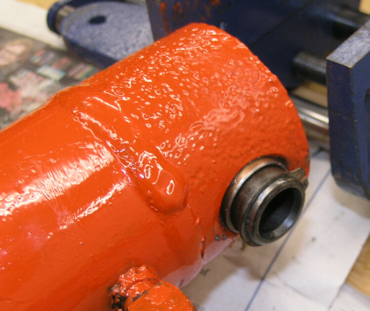

New bushings installed:
1) Start bushing. There is a short section of pin inside the bushing to keep its shape while installing (you can see the end of it in the photo)
2) MacGyver bushing insertion tool.
3) Bushing almost in. I used that short section of pin with a snap ring to push it in the last little bit.
4) Done.
