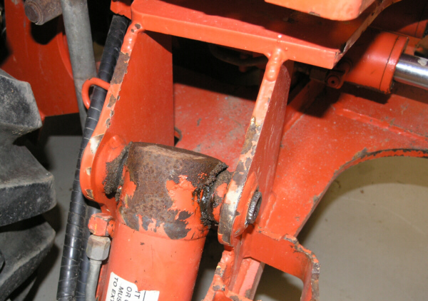

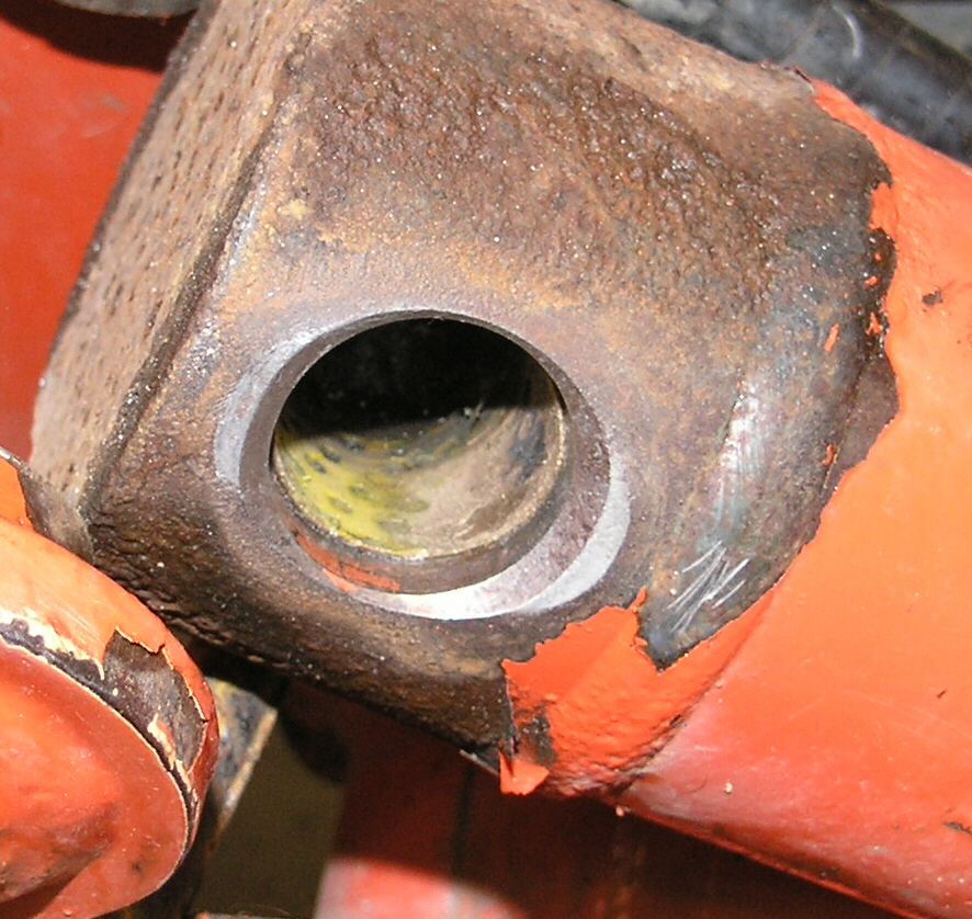

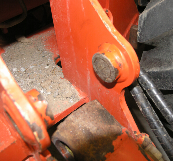

I am doing some repairs on my new-to-me B21. The stabilizer cylinder connections are a little sloppy so I decided to change the bushings - see the photo showing a worn bushing. Can anyone give me a tip for removing the old bushings? They seems to be siezed in there. I could go at it with a screwdriver or chisel but I dont want to score the bore of the cylinder.
Good Morning,
You have a couple of options, bearing/bushing drivers, a Dremel moto tool with long bits to weaken the bushing walls, a large CO2 fire extinguisher, and finally a sawzall which will work wonders; no worries about the bore as long as your slow in working and check your work every few seconds as it will advance quickly-2 cuts and its out- the steel in th ecylinder is harder than the bushing.
Throwing the new bushings in the freezer the night before or in dry ice will aid your repair nicely.
/ B21 - Replacing bushings #6
I've cut bushings out like that with a hacksaw blade. Since it's worn through on one side you'll only need to make one cut on the opposite side like mentioned. A scratch or cut on the bore surface won't hurt a thing if you emery tape it a bit to prepare for the new bushing.
/ B21 - Replacing bushings #8
If its worn completely through on one side it shouldn't take much to drive it out. If you have a big punch, or maybe even use the old pin (I assume you are replacing it too) just use it as a punch and use a good 3 lb. or so hammer. You need to get "western" here. It will come. A screw driver is a pretty wimpy tool for this. A carpenters hammer likely won't be enough either. Leave it in your toolbox. It's likely the bushing (unless its brass) is hardened so cutting won't be easy. Is the new bushing a split spring steel or solid bushing? If its solid walled freezing will make it go in easier. If it is a split bushing, no need to freeze. Make sure you get all the rust and any dings you might raise in the bore cleaned up before going in with the new.

Looks like brass - here is a photo from Messicks.

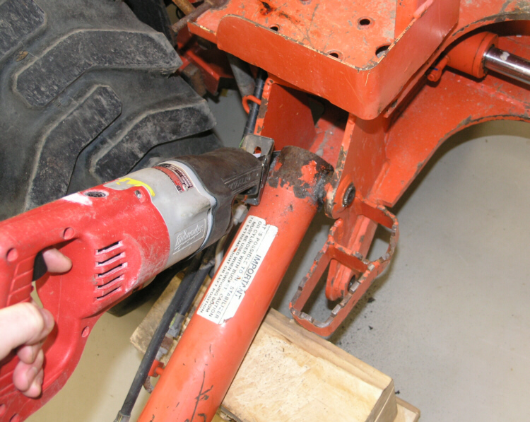

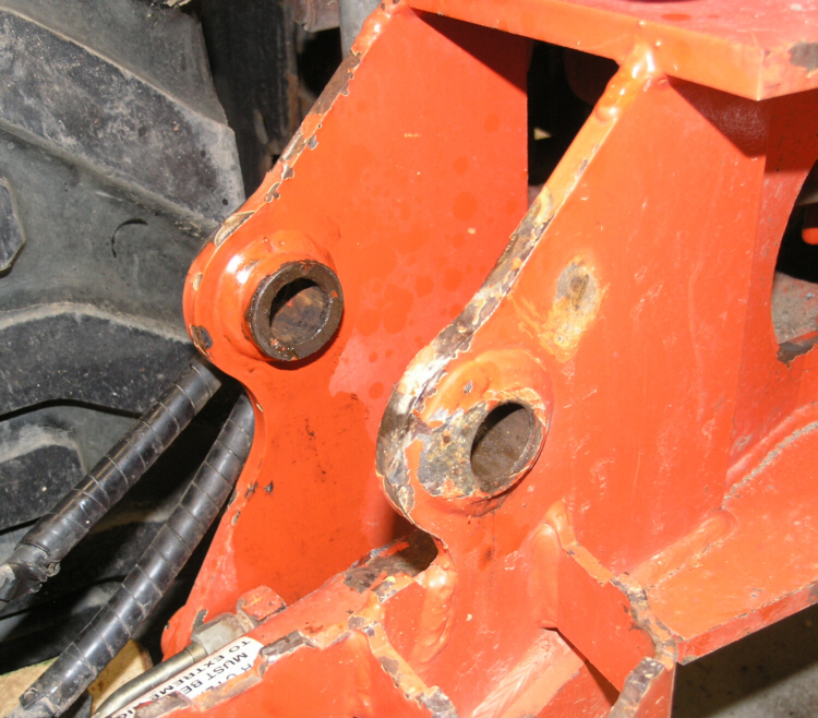

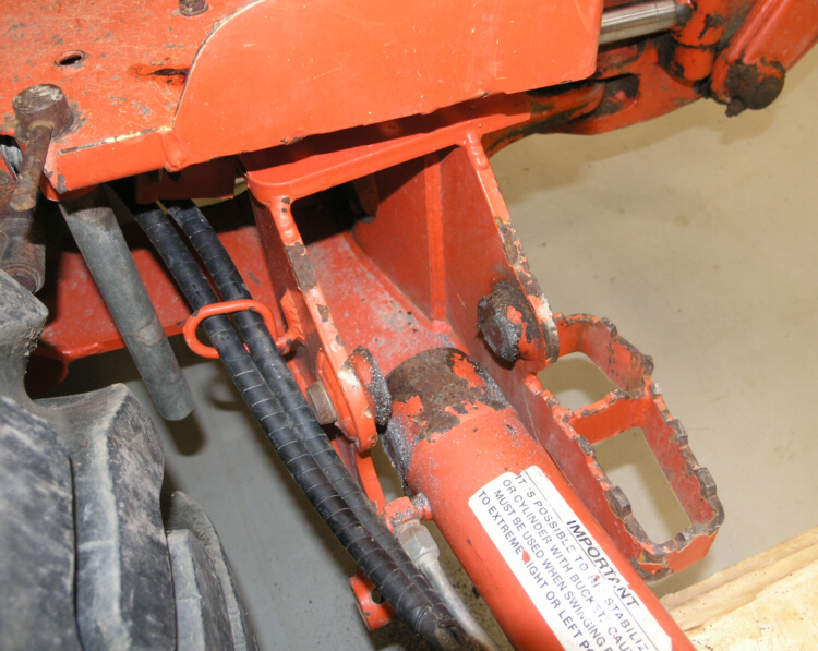

Now I have a related problem. I was unable to remove the cylinder end pin from either stabilizer arm. The cylinder referred to in my original post was disconnected by cutting the pin in 2 places with a sawzall. Two of the 3 pieces of pin came out easily bit the 3rd piece is still frozen into the frame - see 2nd photo. I used a sledge with a piece of 1/2 sch 40 steel pipe as a drift but it wouldn稚 budge. I even got a 3 ft. pipe wrench on the outside end of the pin in an attempt to turn it but no luck. Any suggestions?
(The 3rd photo shows the complete pin in the other stabilizer arm - frozen too).

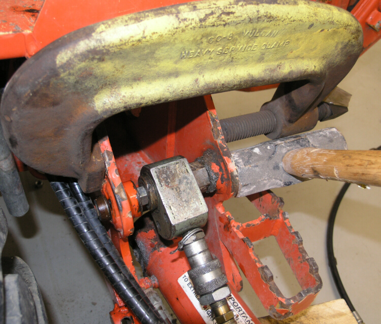

Along the lines that Kwentling mentioned you could get a 6" long 5/8" or 3/4" dia threaded bolt with nuts and flat washers on the opposite side of the cut pin and then turn the bolt pushing against the pin, then with some pressure on the pin, whack the head of the bolt to loosen then push/drive it out.
As mentioned before, heat, C-clamps to keep it from spreading and penetrating oil and you should be able to get it out.

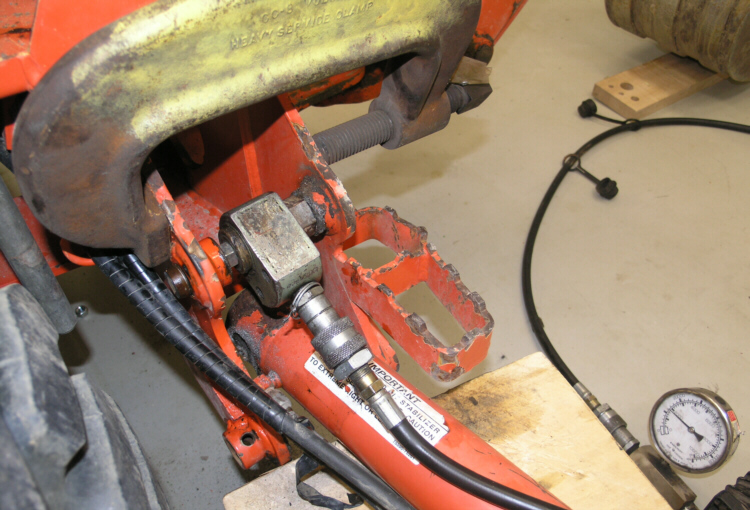

I solved my pin problem:
1) cut with sawzall
2) heat with propane torch then penetrating oil when still hot
3) wait 2 hrs
4) compact hydraulic ram - about 4000 lb force - use clamp to limit frame deformation
5) apply my 5 lb gentle pursuader
Wow that was in there tight.

That is exactly as I would have done it, right down to the exact same clamp and pancake jack! Good job.
Kim
