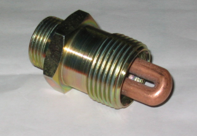

As a follow up to " Block heater location", which was started about a month ago here at TBN, I'd
like to submit these pictures which should leave no further doubt about a typical B series installation.
First pix ..shows the parts laid out before assembly. (Heater kit #73274) as ordered from Tractorsmart. ........ ( $30.15 plus $5 S&H ) ...RayBee

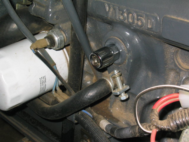

Second Pix ..... Shows the Kubota threaded plug removed (hex 17 mm). A warmed engine
beforehand, will make it's removal easier. (Don't forget to drain coolant from engine block beforehand)
/forums/images/graemlins/smile.gif ...RayBee

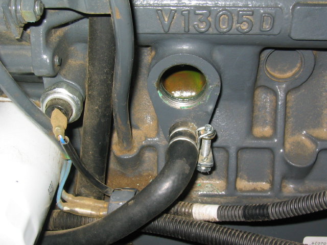

/ B series BlockHeater Install & Pixs
Third Pix .... This shows the business end of the heater that extends into engine block.

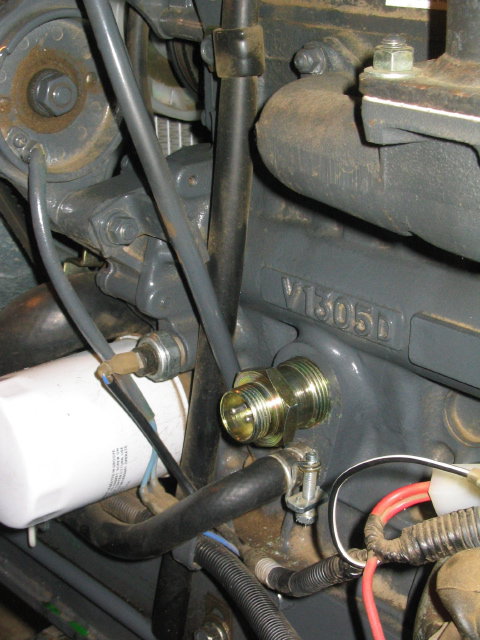

Fourth Pix .... This shows heater, compound applied to threads & inserted into engine block. /forums/images/graemlins/smile.gif ...RayBee

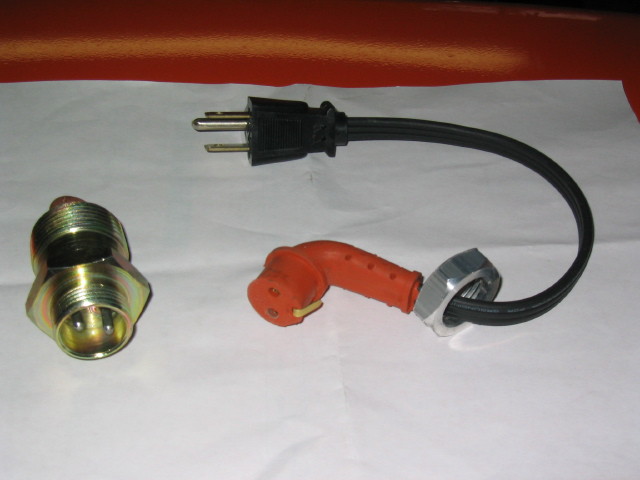

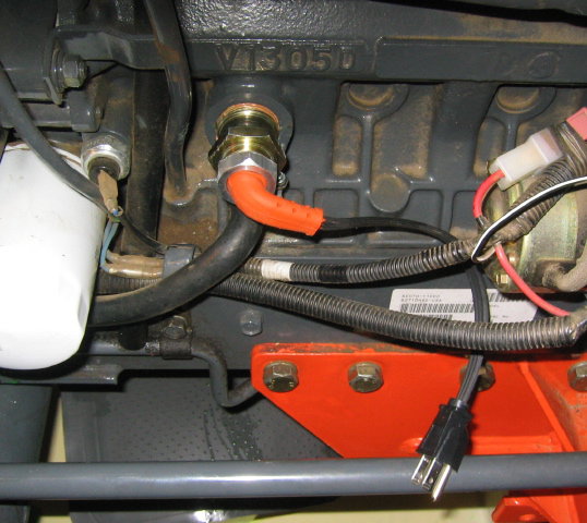

Fifth Pix .... Finally the electric cord plugs into heater and is secured by a captive nut to insure that it won't loosen from engine vibration. My install was on a B2710, and I chose this cord position, but you may rotate/tighten the heater more or less to adjust where the cord fits your needs. (Don't forget to replace your coolant, before starting tractor.)
/forums/images/graemlins/smile.gif /forums/images/graemlins/wink.gif ...RayBee

NY-Yankees-Fan:
I tried removing the 17mm plug with a 1/2 in. drive breaker bar, and a cold engine, it would'nt budge. I warmed the engine to operating temp.
and used the same tools but added a short 24-28 in. cheater pipe and
it moved easily with steady pressure applied. Be sure you get a 1/2in
drive socket. (3/8in will break) /forums/images/graemlins/frown.gif ...RayBee

Thanks for the great pics. I never did install the heater in my b2150. I could not get comfortable about eliminating that second radiator hose. Could you tell from your install what the hose (below the plug) was for?
buzst
#15
buzst:
I admit that the hose has me puzzled, also. I thought of your dilema as
I opened the box and found the extra hose clamp and steel tube to insert
into the hose. I looked at my hose and it led to the bottom of the radiator,
as yours does and seems to be an expansion relief, but I'm not certain .
Sorry I wasn't more help. If KubMech reads this post he probably can shed
some light. ...Raybee /forums/images/graemlins/confused.gif
#16
buzst:
I looked at the schematic for my tractor and the hose in question is called
a drain hose. It attaches along with the drain hose on the radiator to a
common plastic drain cock and I think it's purpose is to drain the engine
block when you change coolant. So maybe if you clamp it off you merely
have to work around when draining the block. ..RayBee
