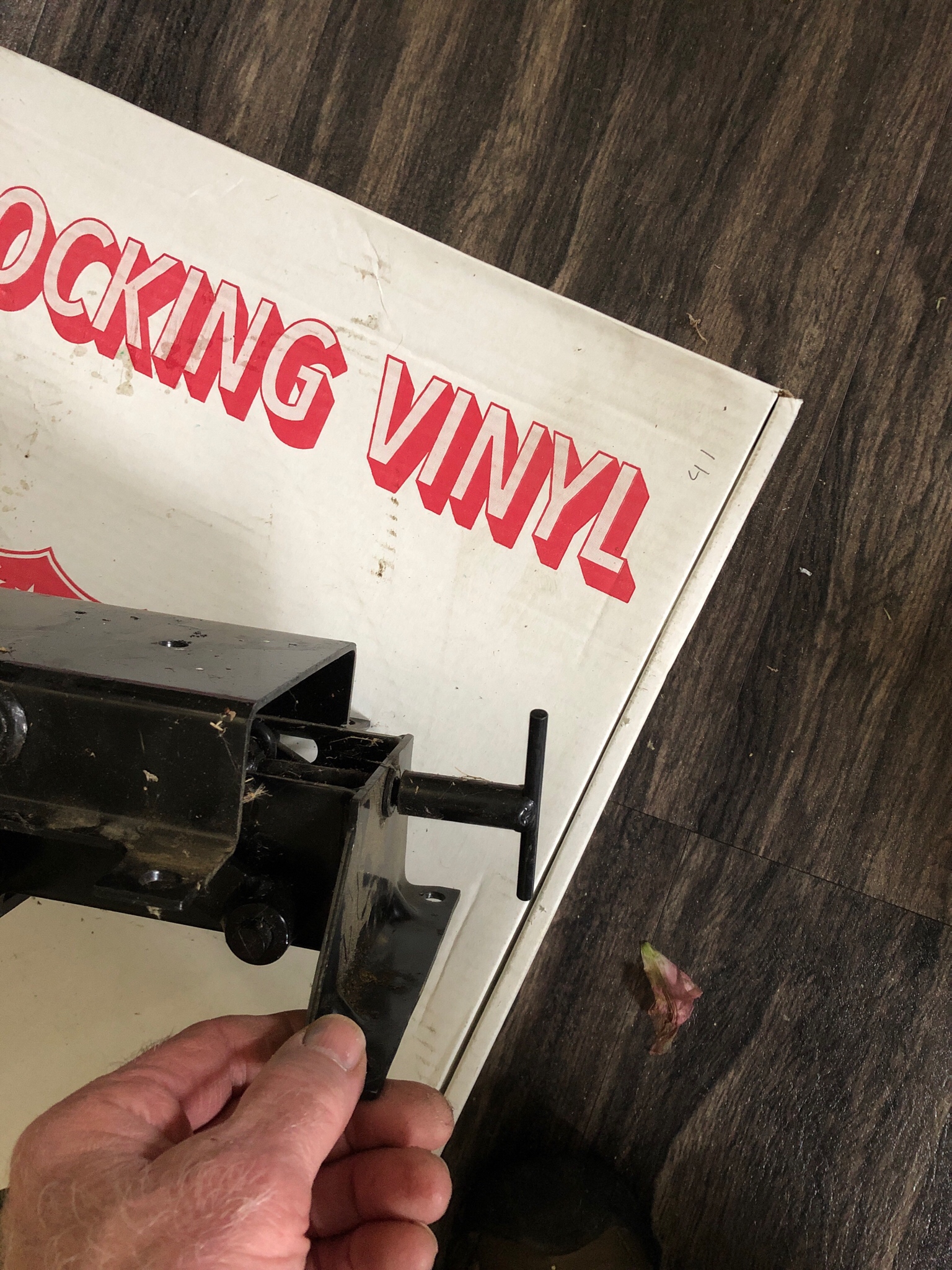

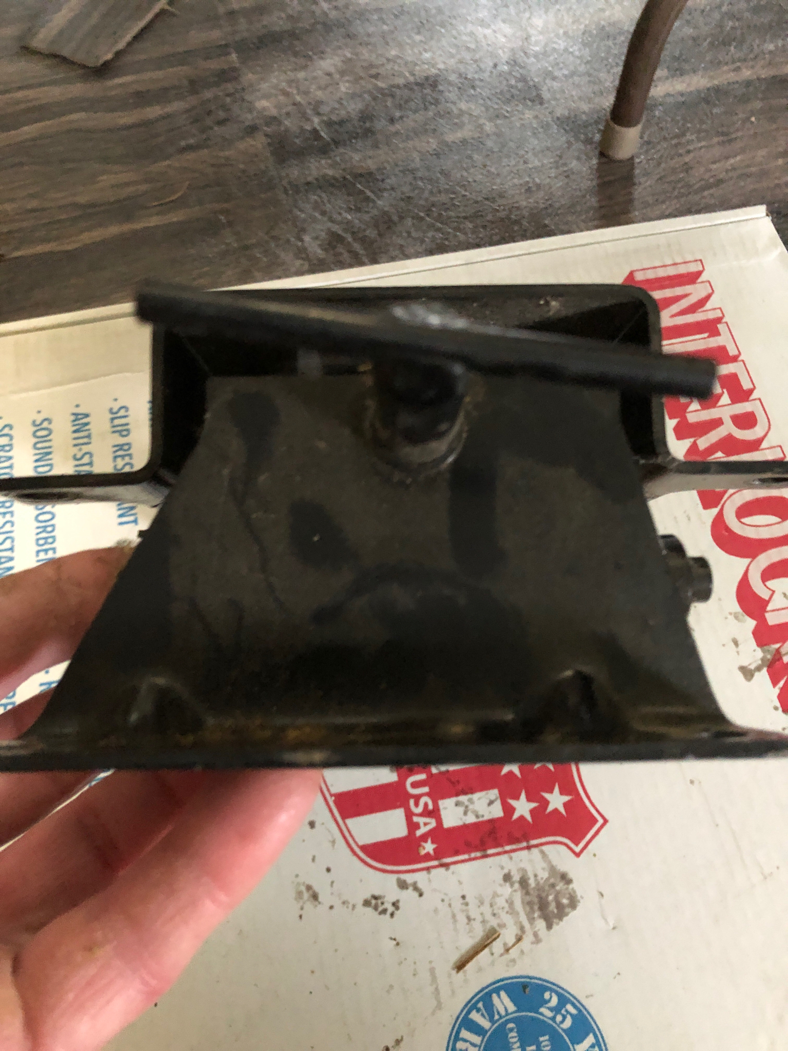

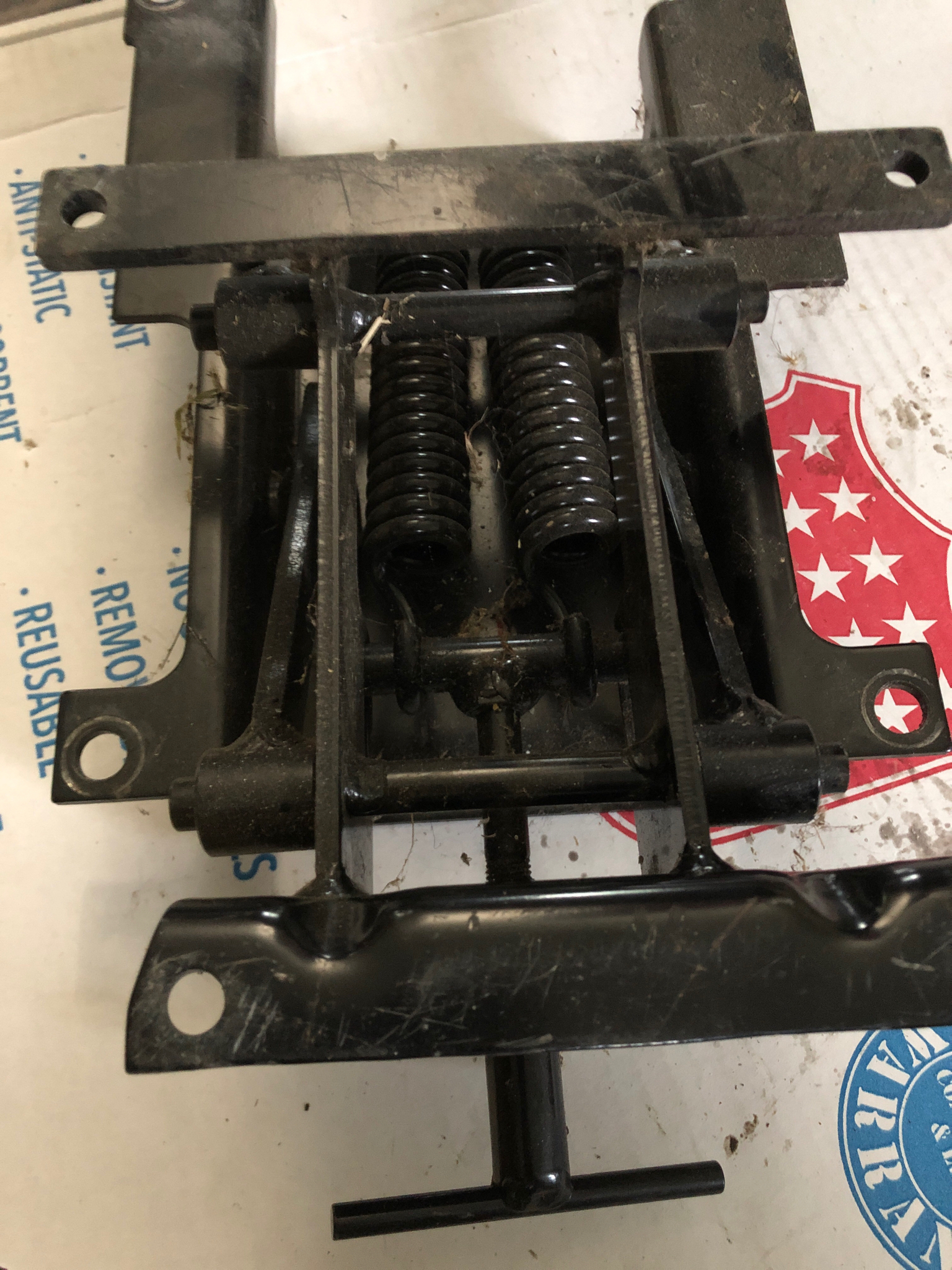

/ B-2650 Seat #12
On the standard seat, on the rear, there is a T handle that screws the dual horizontal suspension springs tighter or looser.
/ B-2650 Seat #13
Here is the T-handle
This is the seat base on the B2650.
You can see the springs in the last photo.
/ B-2650 Seat
#14
Well slap me silly. There it is!. I guess it came with no tension on those springs. I gave the T-Handle 3 turns tighter.
This TBN site is the best...........Thanks Guys.
