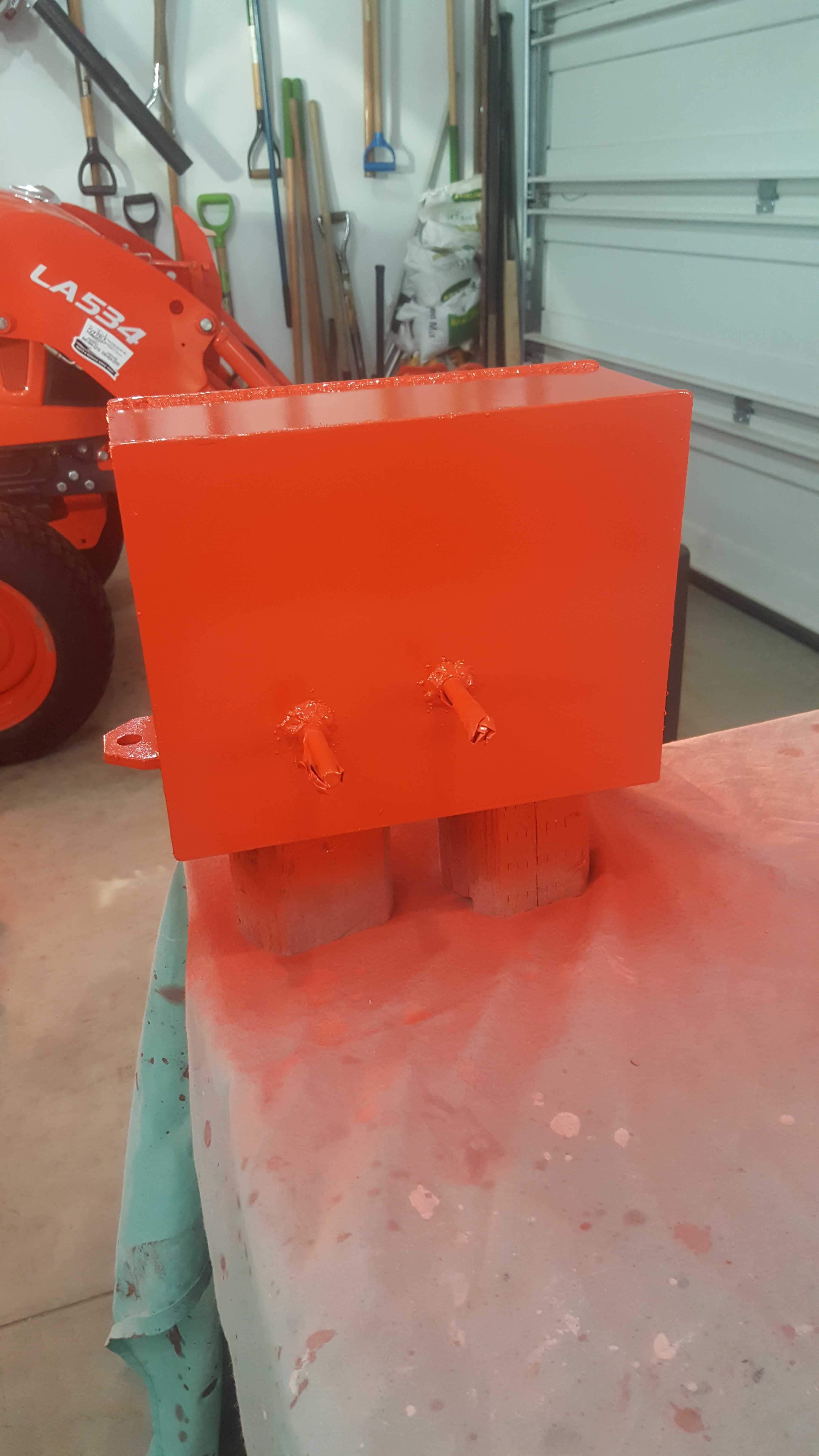

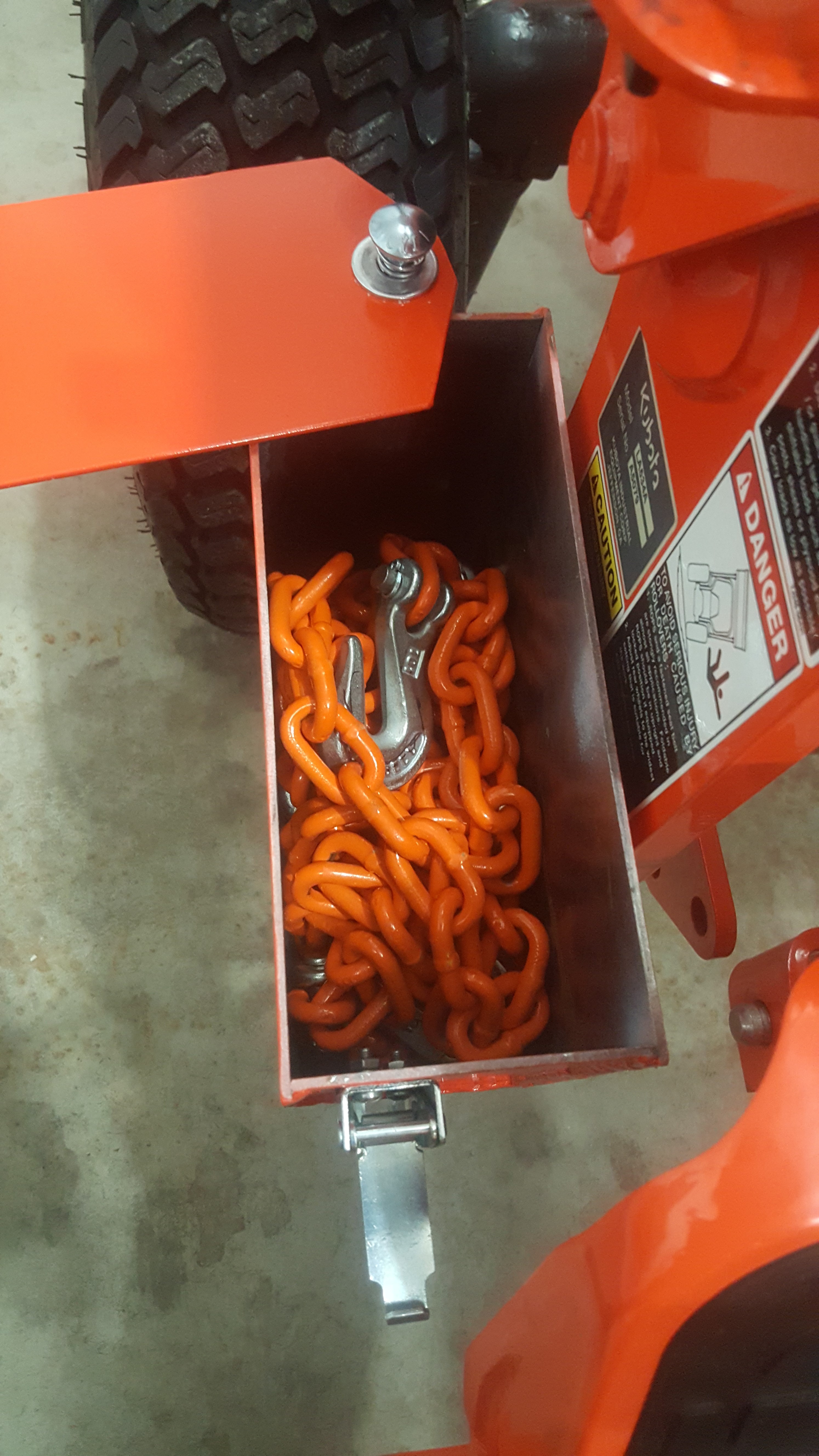

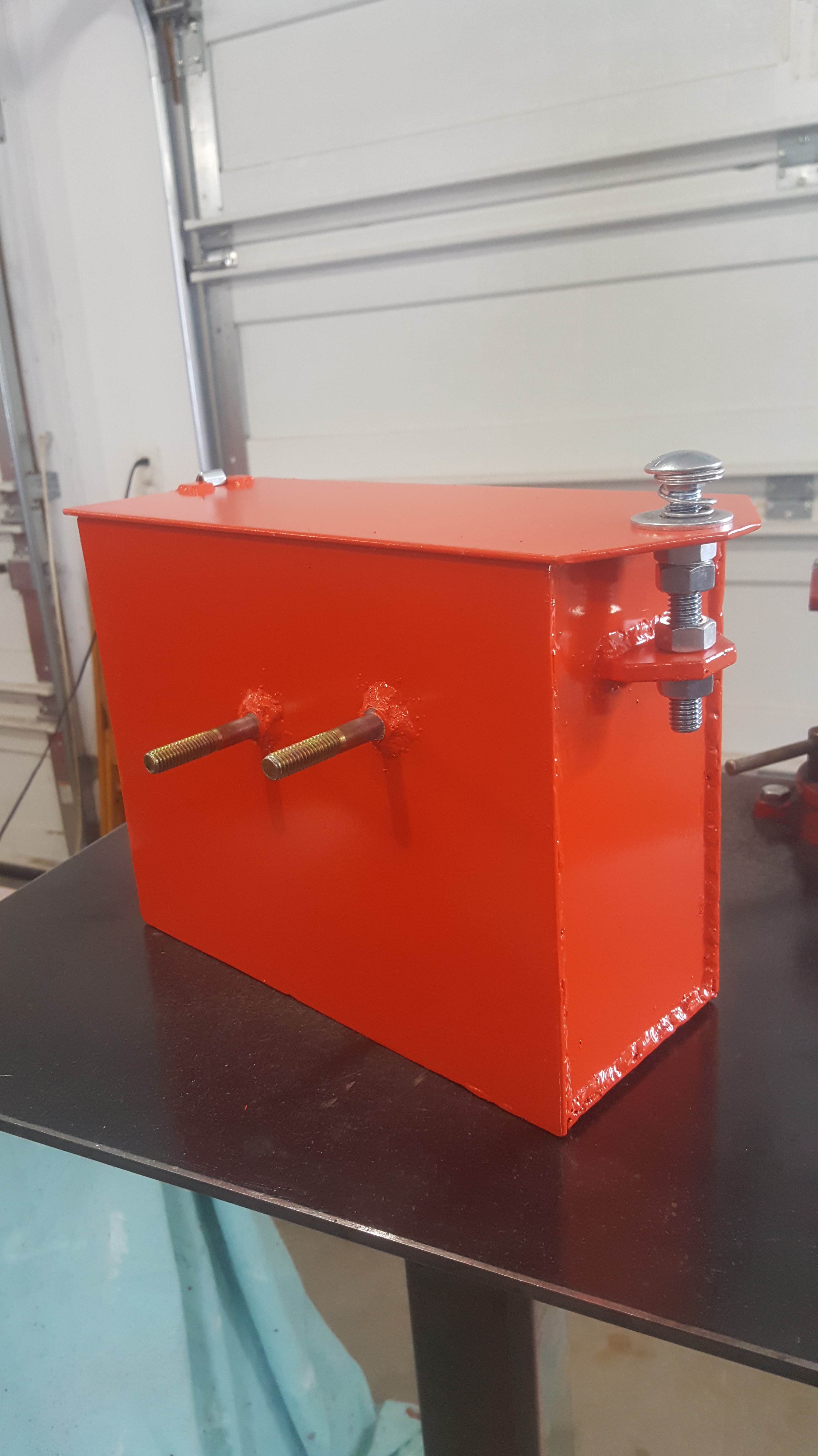

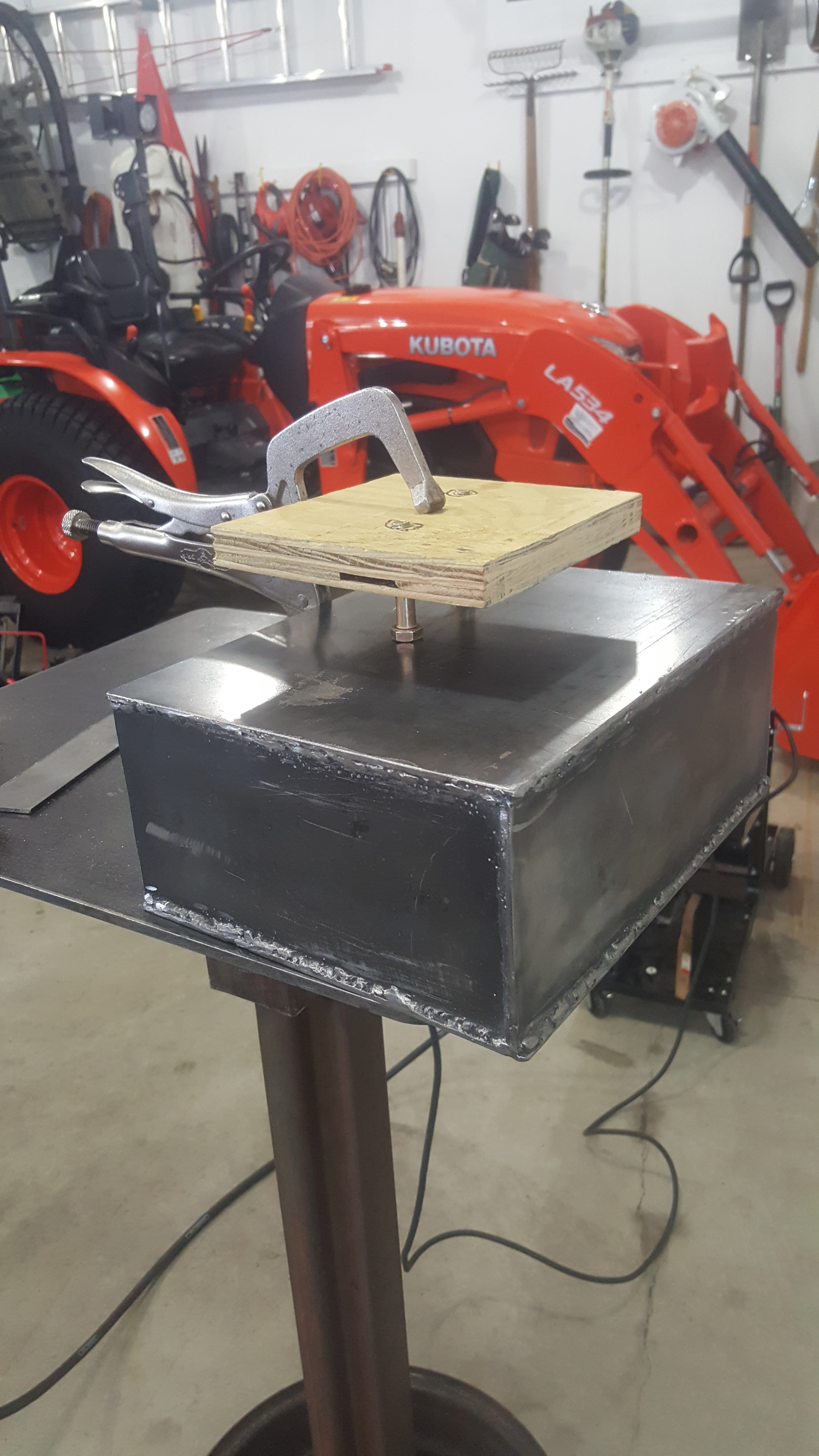

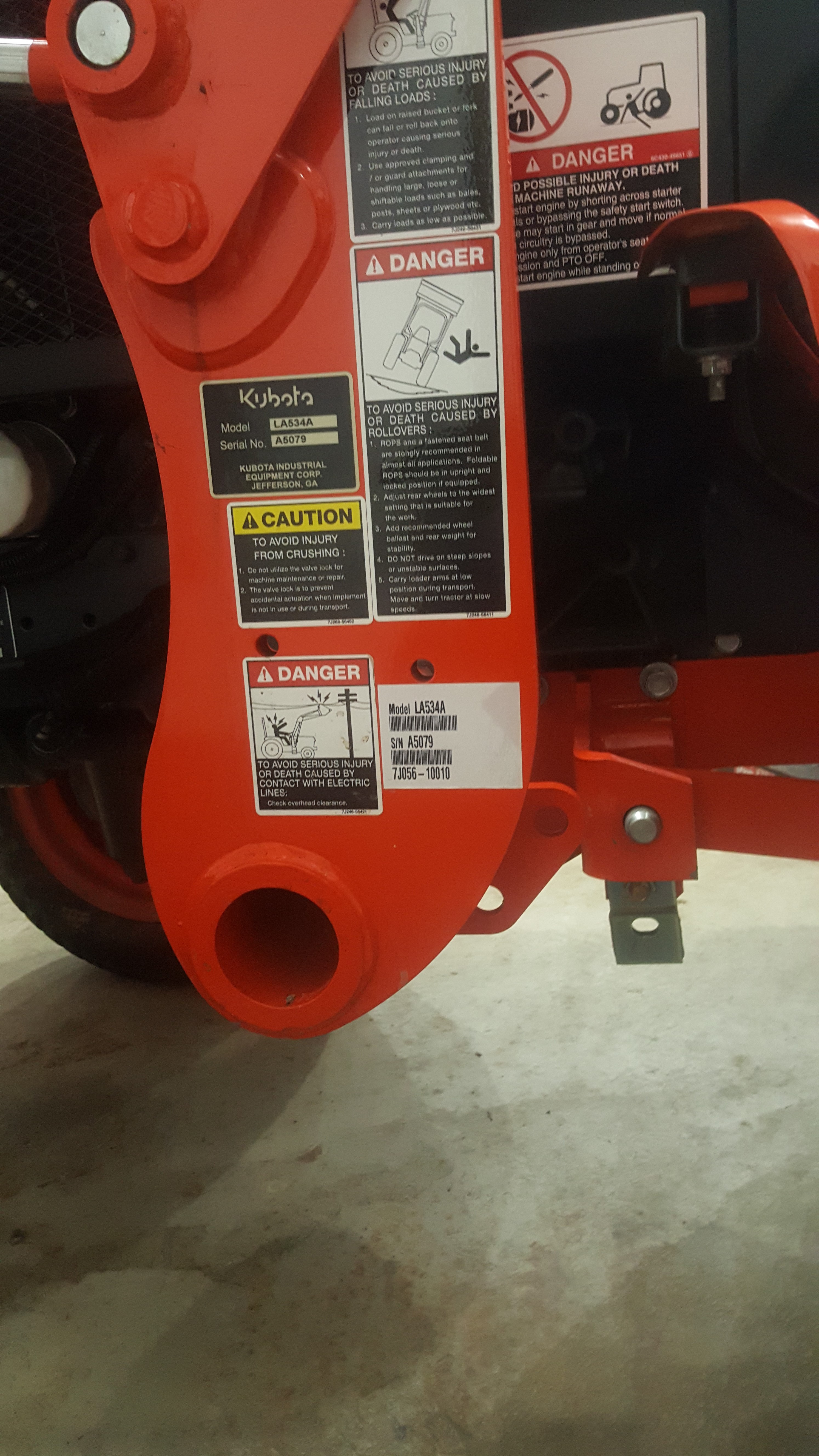

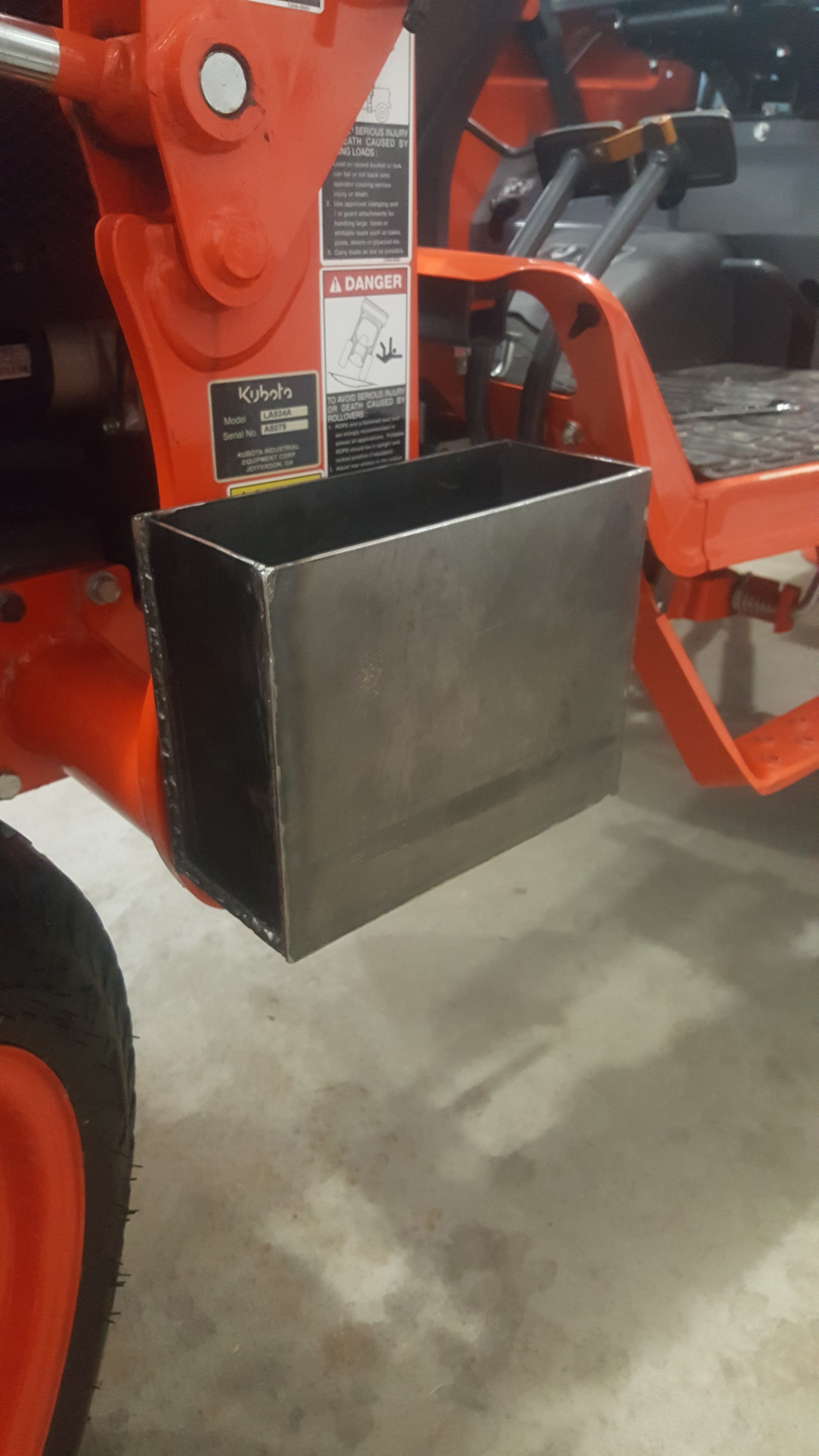

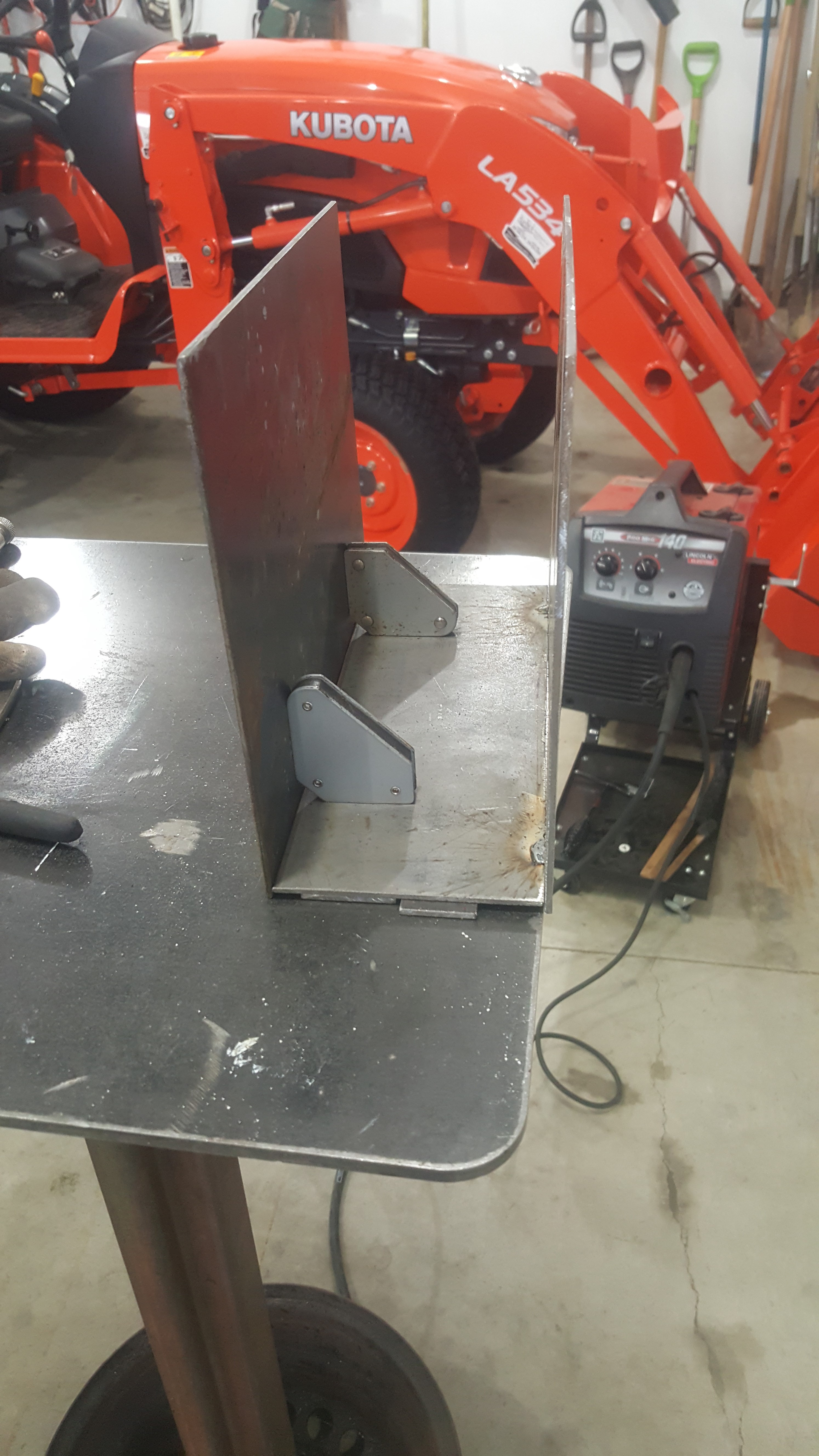

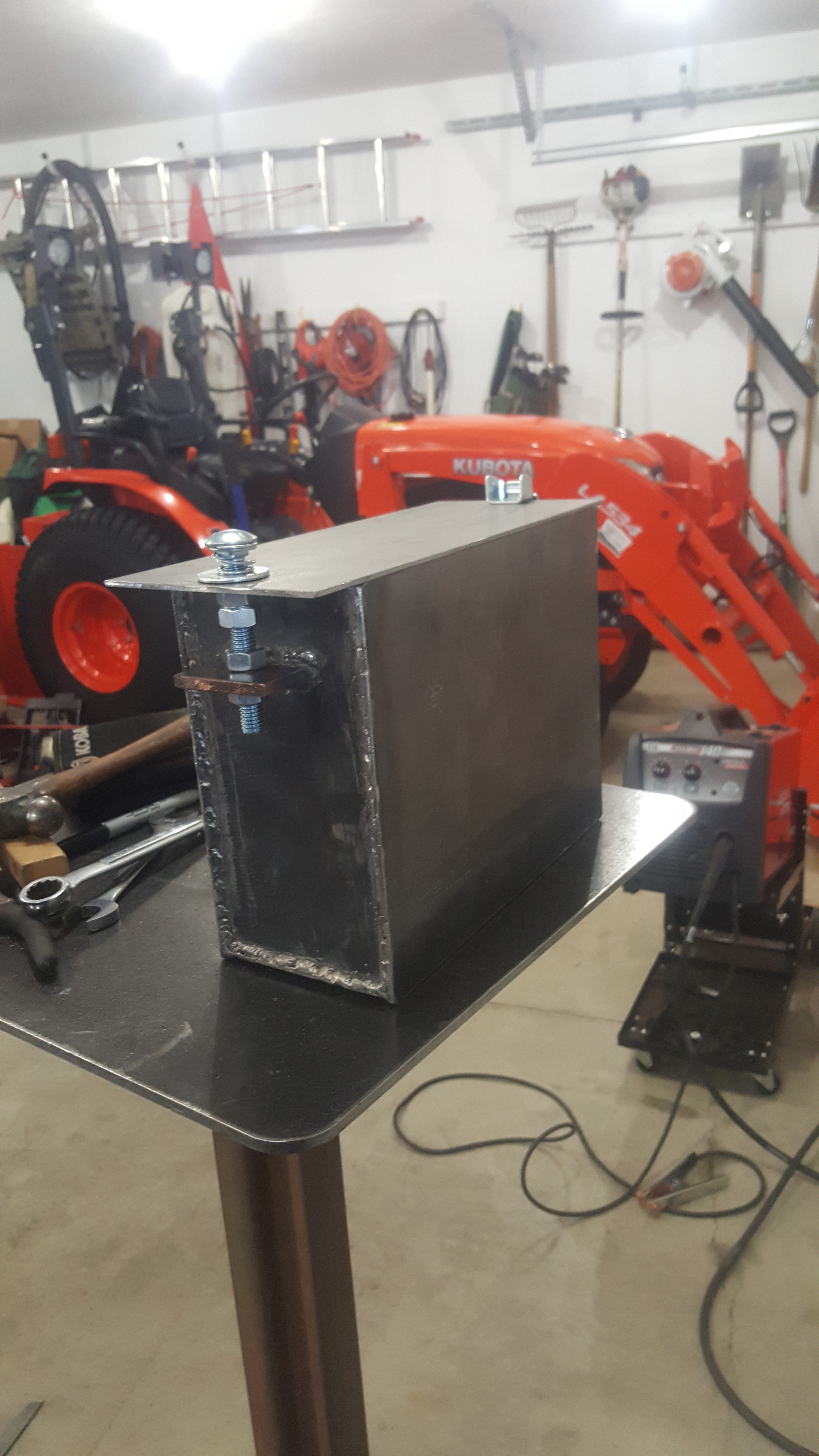

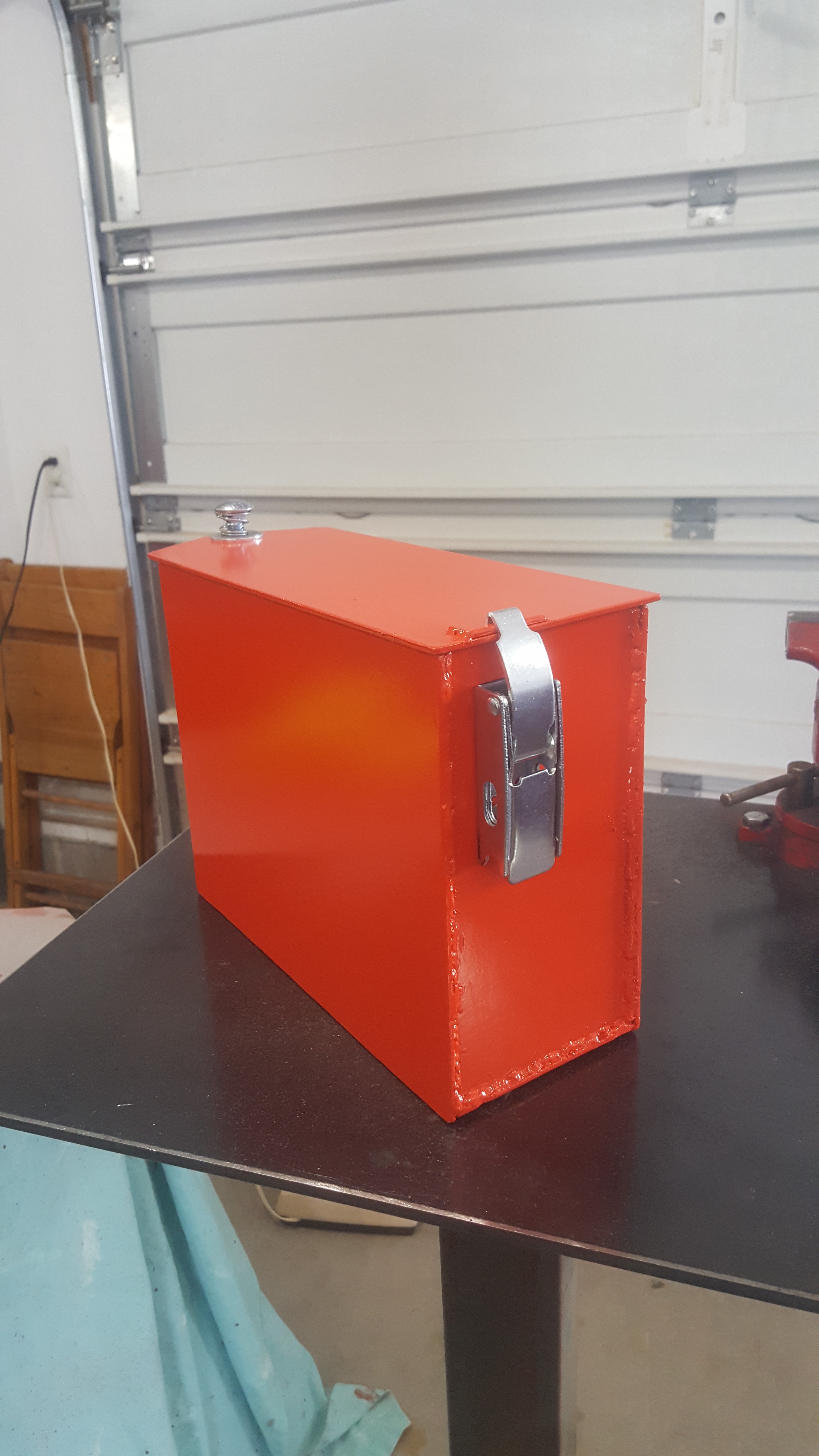

After buying a 5/16 grade 43 12 ft orange chain that I cut in half to have 2- 6 footers I wanted to add to my collection, there is no where to store them on my B2650 to rig or lift things when you need to. I decided I need to fab up a heavy duty tool box to mount to 2 existing holes in the loader frame to store them. I got some 1/8" steel plate and cut it out to make a 10 1/2" long x 8" high x4" wide toolbox. This size fit nicely in the spot I wanted and was not in the way or too low to snag on something. I welded on 2 grade 8, 3/8" bolts to the back of the box to mount it using a jig I made up to make sure they were aligned perfectly. The biggest problem I had was how to mount the lid. I could not put hinges on the inside and open it towards the tractor due to things in the way. I didnt want to bolt or weld hinges on the outside because I wanted a nice clean look. I decided to make the lid pivot and swing open, with a spring in the front and a heavy duty draw hasp in the back to secure it.

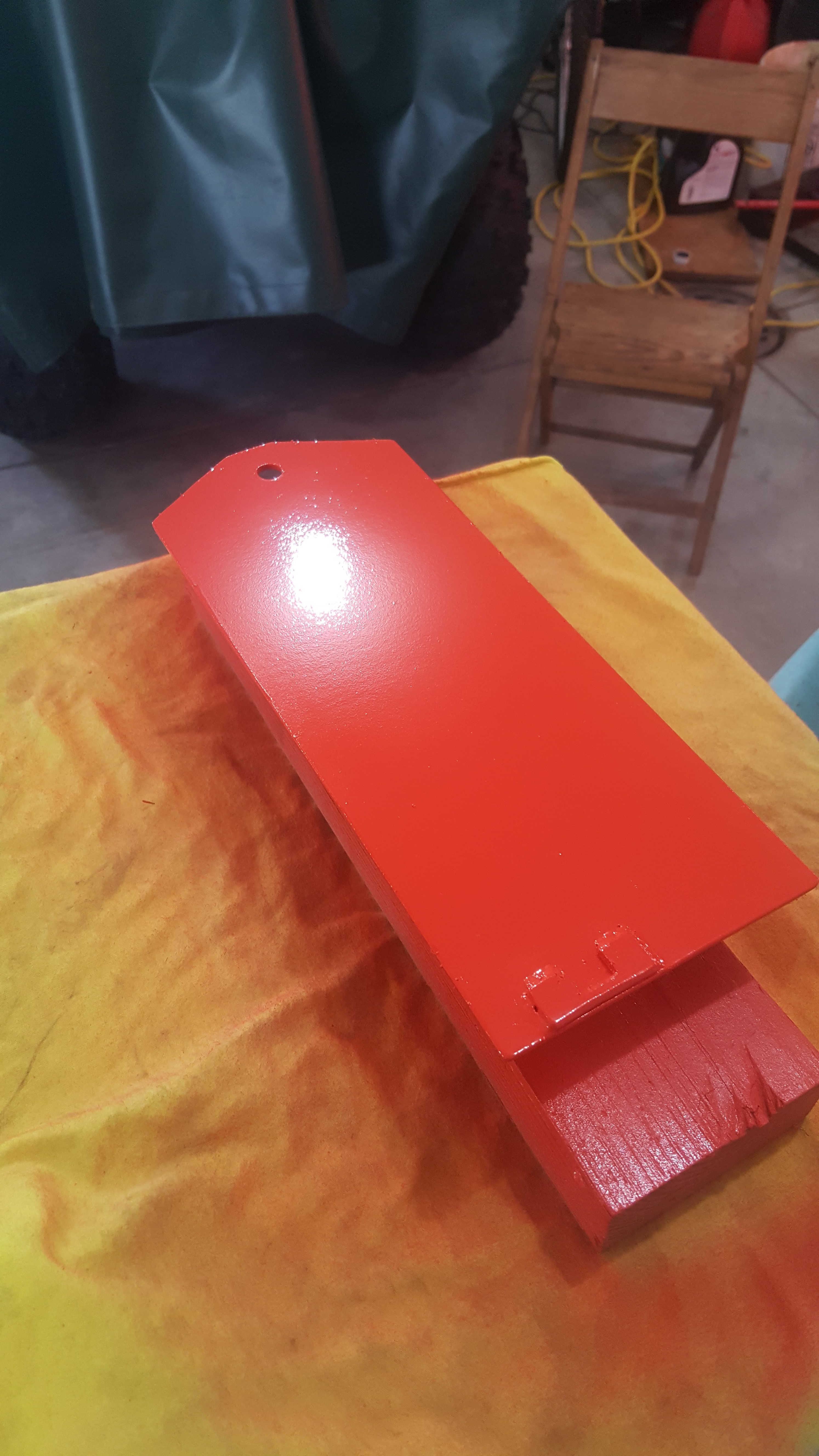

Here is my toolbox after priming, painting, and assembly
/ B 2650 custom tool box.

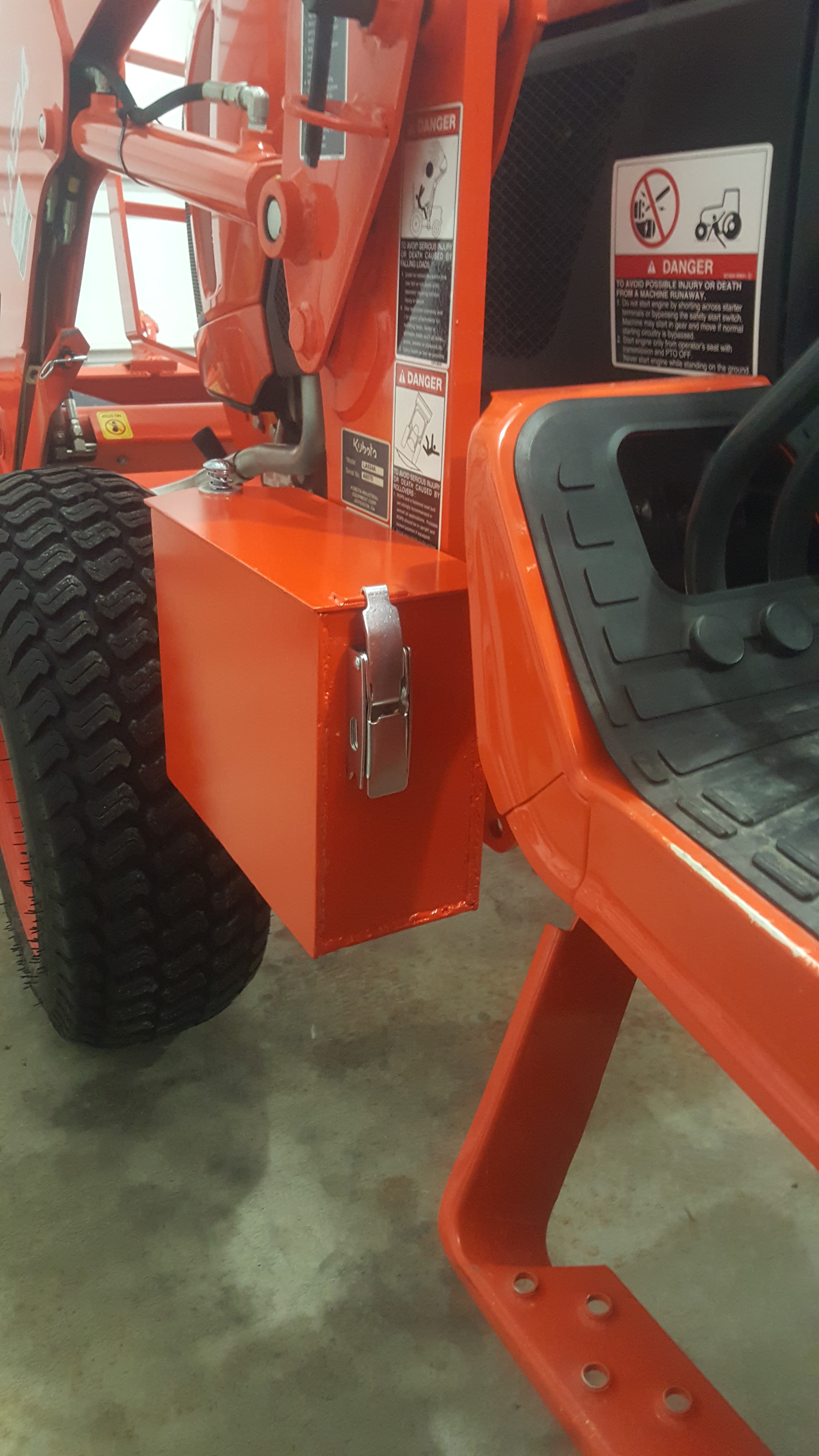

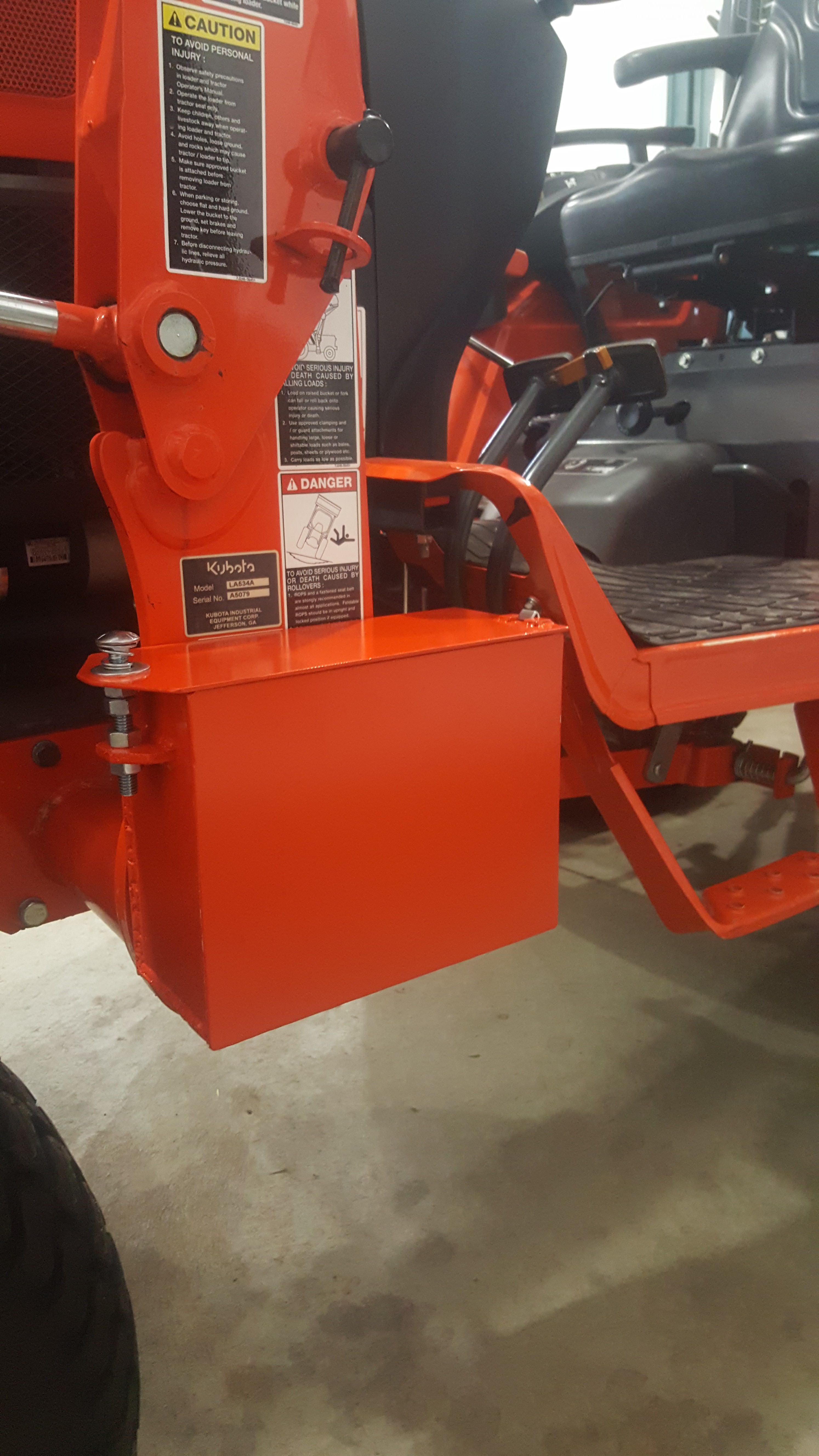

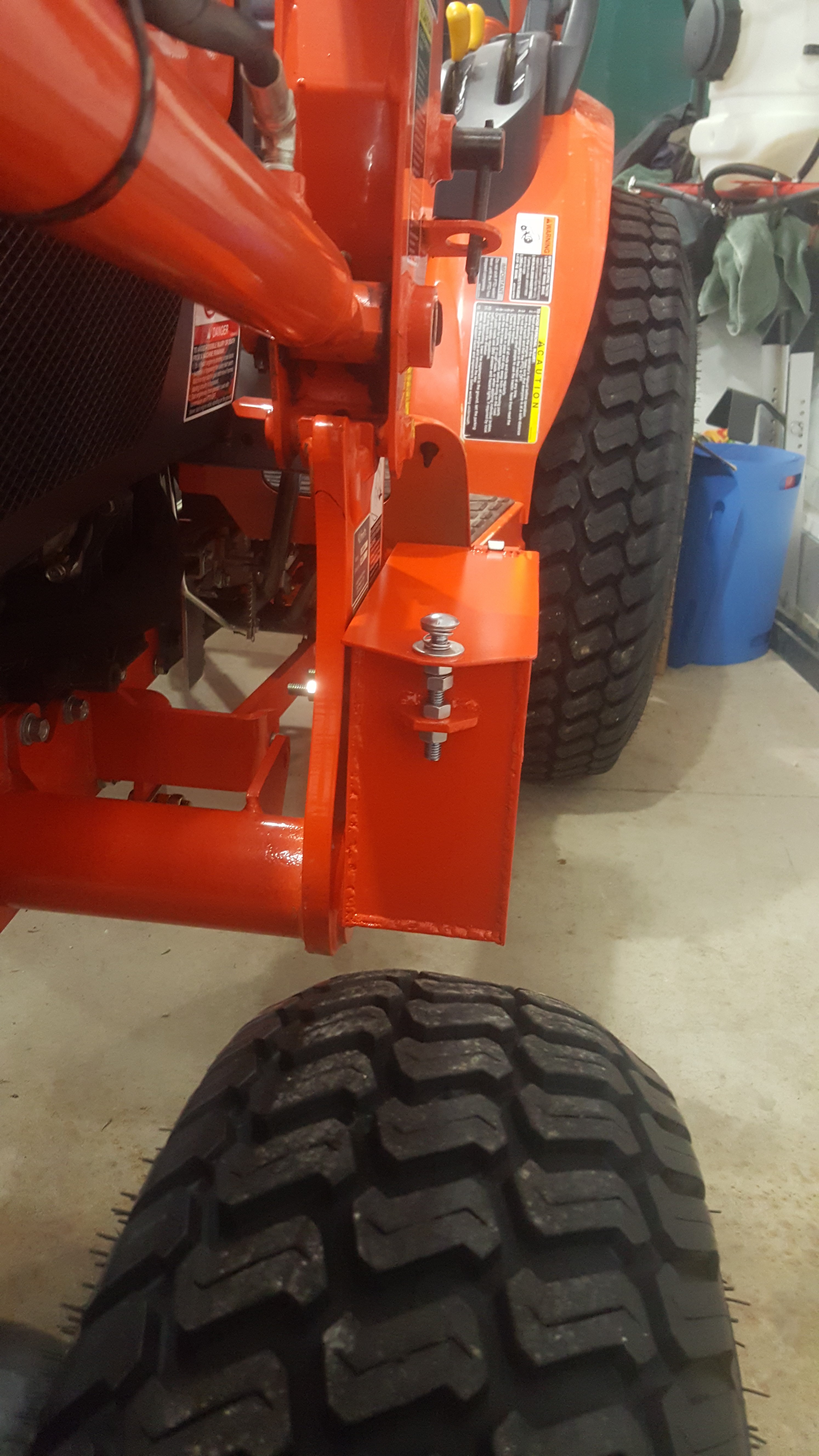

Here is the toolbox on my tractor. Very happy with the way it came out and is super solid. Fun little project.

Did you put anything as a spacer between the toolbox and the loader arm, or does the weld take up that quarter inch or whatever it is?
#12
I used 2 3/8" flat washers between toolbox and the loader arm.
