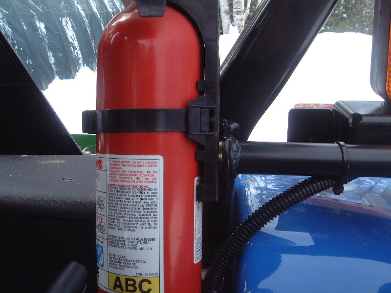

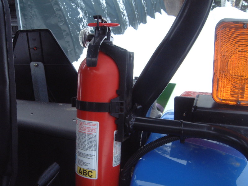

I made the light bracket / extension from some old power pole, cross arm, support braces. There a fairly heavy stock and a real pain to bend. I had to put an offset in them in order to duck under the canopy's edge.

/ Auxiliary Light Project #30
Mark,
Once again you have outdone yourself. /forums/images/graemlins/cool.gif Very nice. I can't quite tell how you attached the brackets for the lights from your pics. The whole setup looks really good and now the mirrors appear "hidden" behind the lights which is nice.
#31
TD,
The bracket / extension are approx. 30" long or so. By design they already have a hole on each end. They are bolted to the canopy support arms, using the front canopy bolt (had to drill a hole in light bracket) and I fastened the back end of the bracket using the exhisting hole and a heavy duty self drilling screw up into the canopy support arm.
The self drilling screws are called Tek Screws, the came with my garage and are what holds / locks all the pipe section together. Awesome heavy duty screws.
