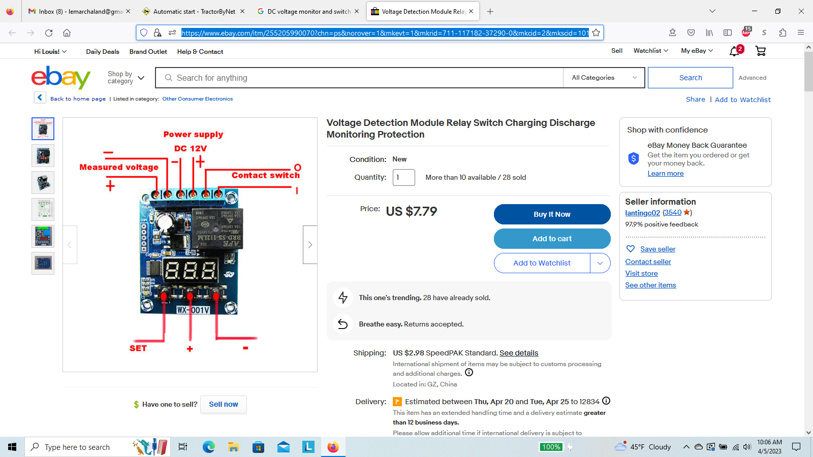

It certainly can be done. I'd expect that reliability would be a driving cost.
Could be as low as;
Voltage Detection Module Relay Switch Charging Discharge Monitoring Protection | eBay

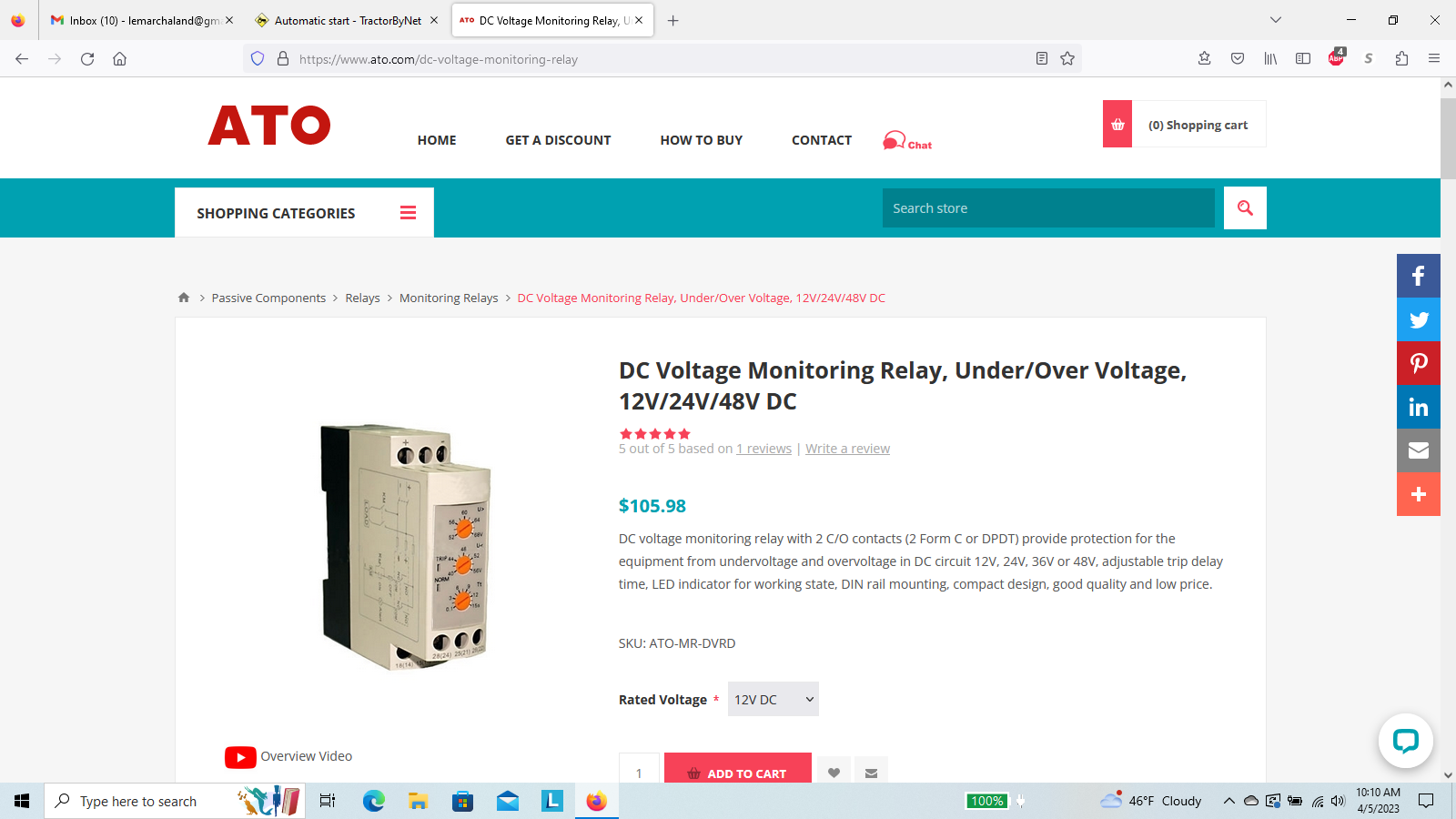

Or a few dollars more;
