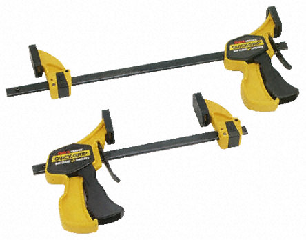

Seems like you could improvise a new version of the tool from a spreader bar clamp. Home Depot and Lowes and Menards have these. Add a compression spring if you need more pressure and/or travel. Cut the bar to length or use wood block spacers to adjust the length.
