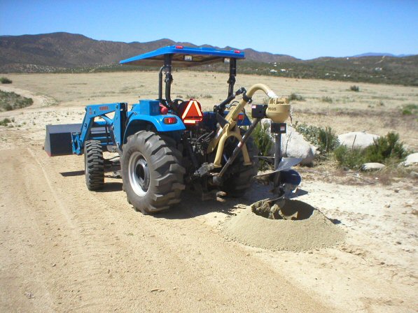

Down pressure units work great. :thumbsup: I don't think that you will find anyone that has one that is unhappy with theirs. I know that for me, what use to be a multi day job with the PHD, between digging, putting water in the hole, letting it soak in and doing that over and over again for hours if not days to digging the hole in less than 2 minutes. I kid you not, less than 2 minutes. :cool2: I am just a weekender, :( so when I go to do something, I need to get it done then, not in 2 or 3 days. After fighting 3-16" dia holes one weekend was when I decided that I needed a down pressure kit. Got it and have not had a problem digging a hole since. ;)
