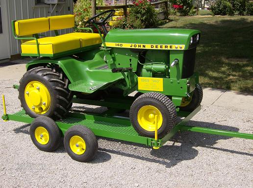

That country mfg design doesn't look right, seems as though it could just fold under? Am I wrong, and it will balance instead?

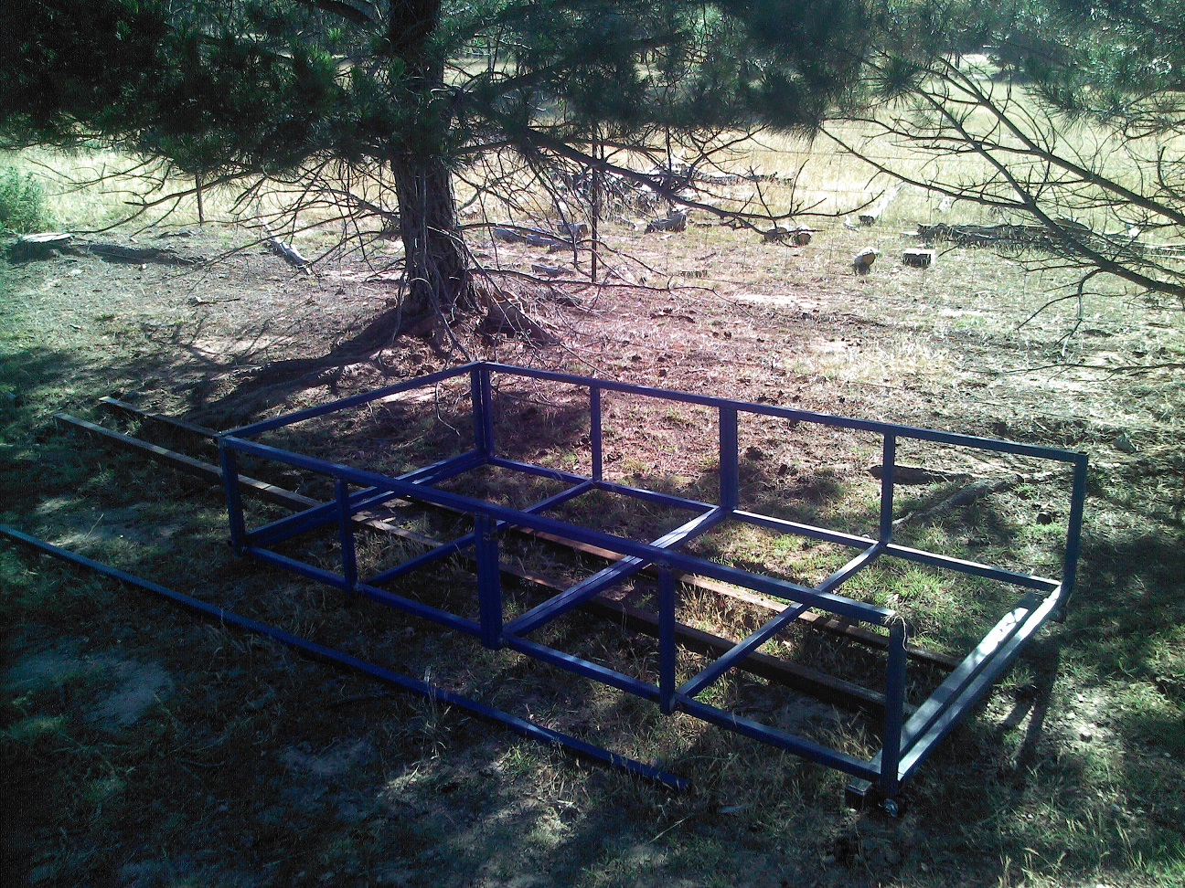

Progress has been a bit slow. I got the base of the bed done a few weeks ago but didn't get anymore done until today. I also welded caps on the ends of some of the main beams. I did the end of one of them and filled it with water... and it held I was pretty impressed considering the 15yo novice welder that I am. Anyway here are some pics of today's progress. IMG_20141118_183919.jpgIMG_20141118_184013.jpgIMG_20141118_184056.jpg

I got the hinges attached and also attached the main beams at one end, sorry no pics yet. I will post pics soon.

Here are the promised pics, sorry they aren't really that good.
/ ATV Trailer Build
#39
I finally got some more done. It is on wheels :cool2:
