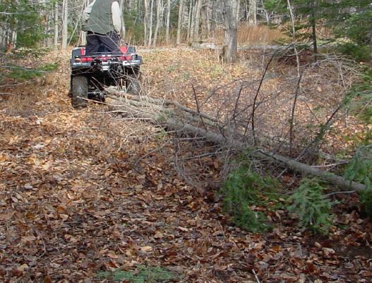

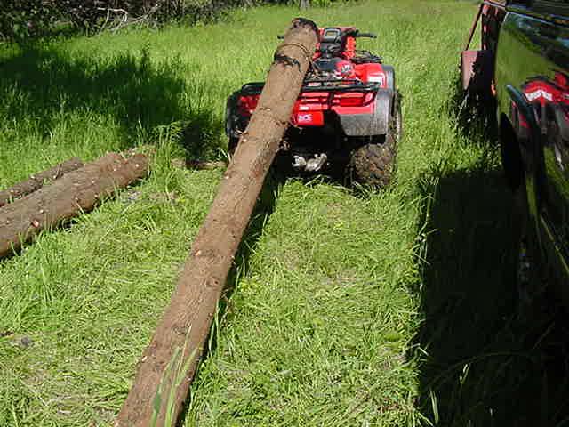

Wondering if anyone on the Board has used an ATV Log Arch or ATV Log Hauler? Would appreciate comments pro or con. I've used my Honda Foreman for skidding out firewood, but the Log Arch sounds like a better setup. Attaching a pic where I hauled out White Cedar logs by placing them up on the machine and also a pic of skidding hardwood with a cable choker - looking for an easier/safer way. /forums/images/graemlins/smile.gif

Using a cable choker. /forums/images/graemlins/smile.gif

It looks like the first picture would put too much weight on the back end and either lift the front end off the round or mae steering nearly impossible.
The second picture is the safest way, but not how you are doing it. I would never use a cable to drag something, it snaps and acts like a whip in both directions. A chain is so much safer.

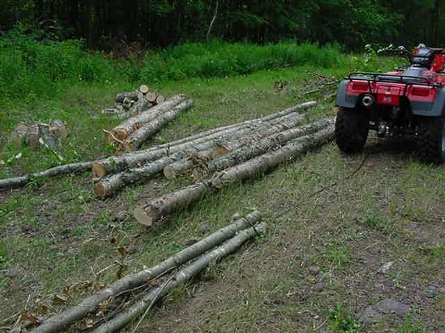

iv'e got a winch mounted to my rear rack.
it works well on lighter trees.
