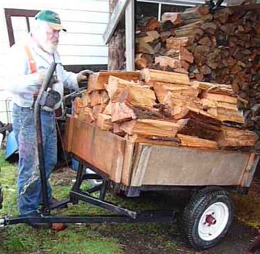

This works for me. I don't mind getting off to manually use the winch, a small electric one would do the trick nicely in the place of the boat winch.

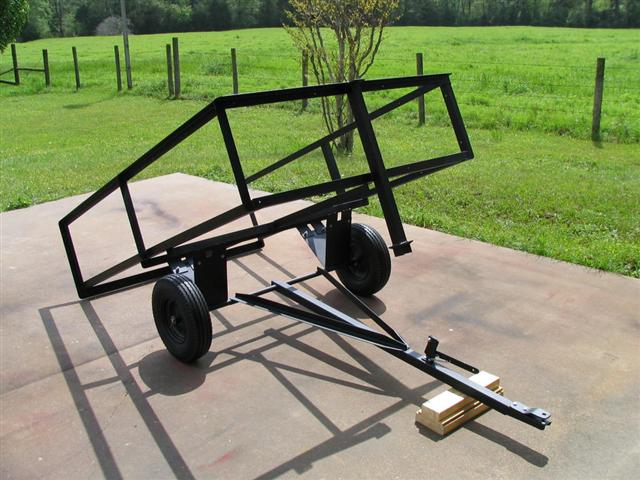

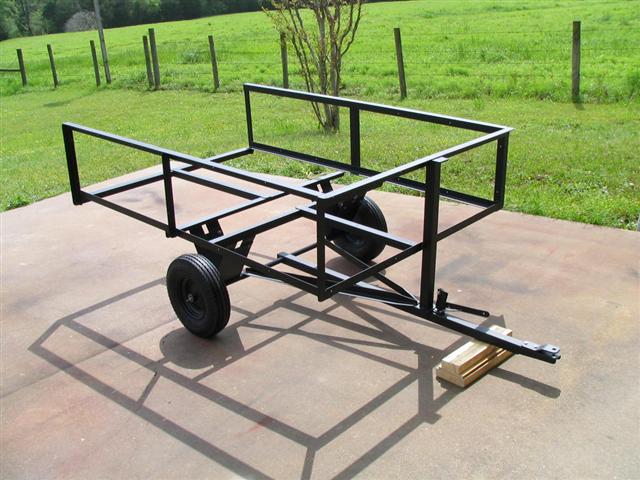

Here is a trailer I fabricated. I had the wheels and the V axle supports from an old trailer. It is 4x6 and about 18" (???) sides. Since it sits up high I get a good dump angle. The box is well balanced and I can raise the load fairly easy. The box is lined with exterior plywood. Since it is sheltered when not used, it will last a good time. The tailgate slides vertically on the back or I could just leave it off. If anything, I could have used a bit more tongue weight. I use my Honda FourTrax as the tow vehicle.
Talk about useful, it is. I have added folding tool racks on the side to hold the equipment I may need. It is manual lift but it works for me.
