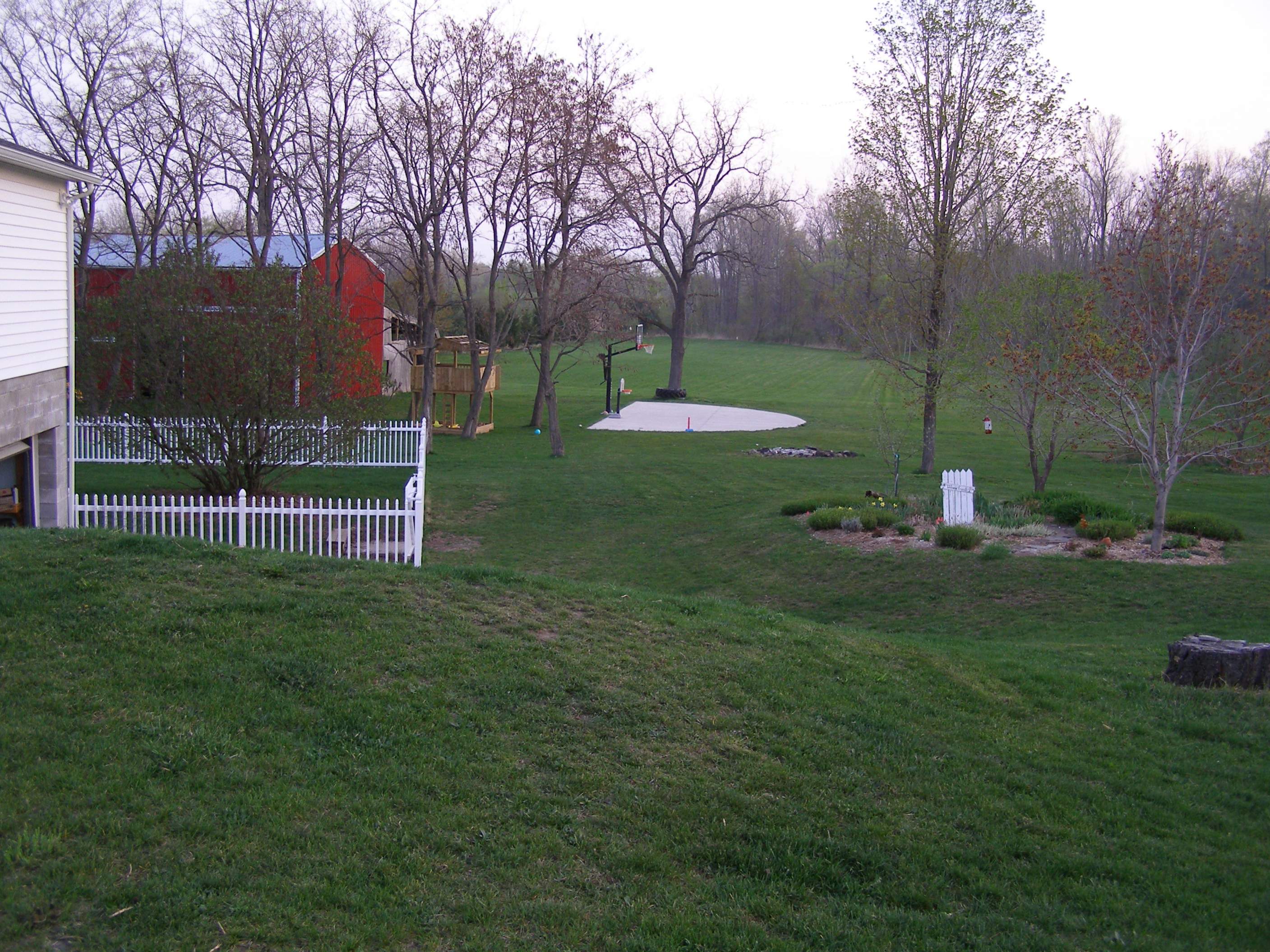

When I did my lawn behind the barn in September 06 I used the following for about 2 acres which is much less than the recommended quantity for new lawns, but it was more than sufficient. I wish I new where I got the recommendation from, but it was somewhere online. I bought the seed at WH Rhineharts in Middleport, NY at a cost of about $65.
Birdsfoot Trefoil Leo - 7 lbs
Timothy - Climax 5 lbs
Orchard Grass - 7 lbs
Kentucky Bluegrass - 3 lbs
Perrenial Rye - 10 lbs
Total of 32 lbs for 2 acres or 87,120 square feet.
/ Attachments for lawn restoration #36
Wow, I put down about 25-30 times as much as did you per square foot. I'm surprised that 0.37 lbs per 1000 square feet did the job based upon the guidelines on the tag on the stuff I bought. I put down about 10 lbs per 1000 square feet (150 lbs for 15,000 square feet) per the recommendation. It's nice to know that I might be able to get away with a lot less than that. Grass seed is expensive :eek:
