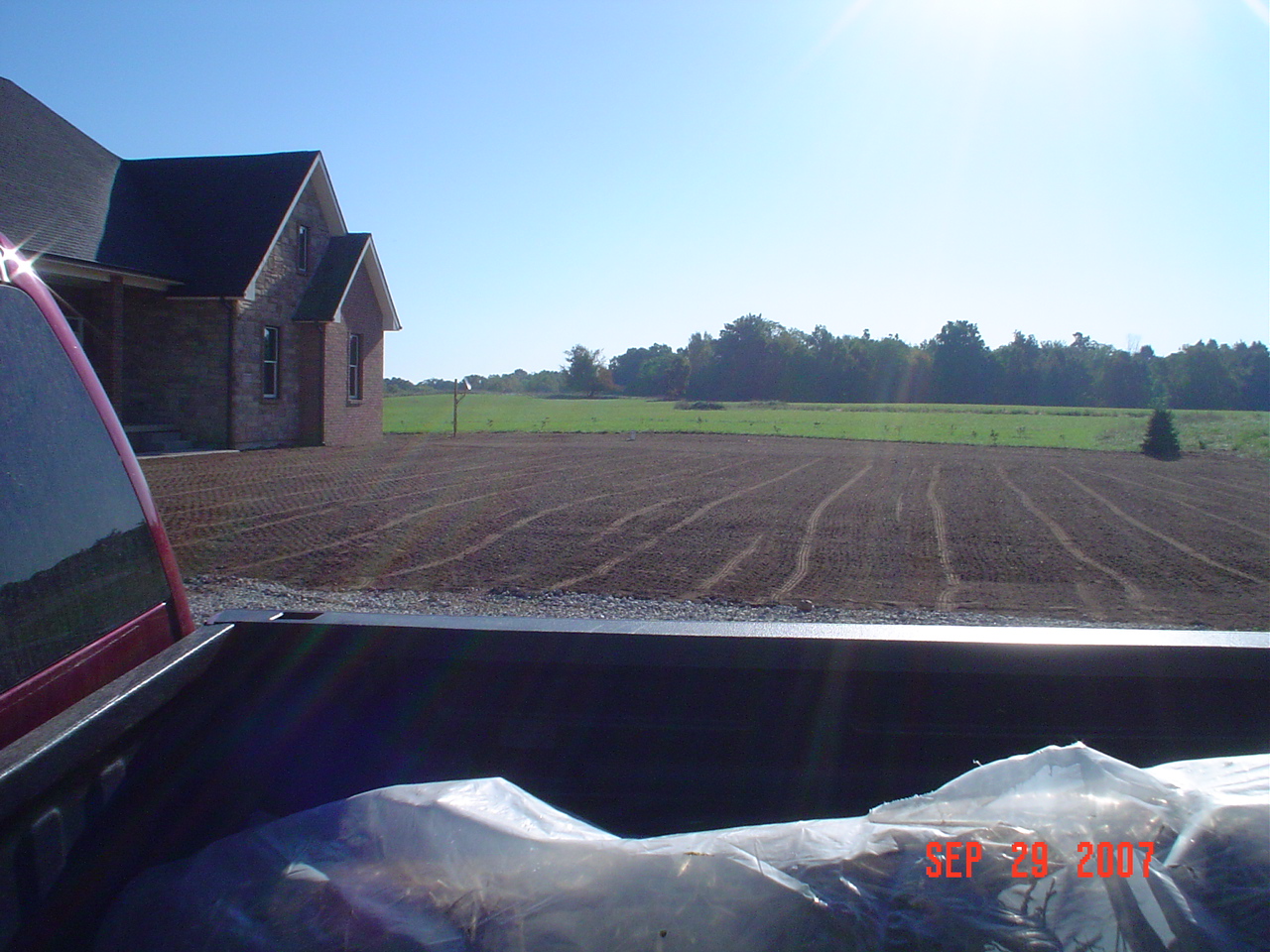

I have a lawn of about 5 acres. 2 years ago I had a friend plow, disc, and cultipack the back 3 acres. It came out nice except the ridges the cultipacker left make mowing a little bumpy when going in an east west direction. I just bought a JD 4400 tractor, and I want to get a couple of attachments for the sole purpose of redoing the remaining 2 acres of lawn that is close to the house. I don't know whether to buy a rototiller and box blade or a 2 bottom plow, a disc and a box blade. Or should I be buying a landscape rake in combination with some combination of the above. I guess I'm not sure what attachments work best. I basically want to till up what is there, then level it off nicely and reseed. Some parts of the soil are rather gravelly. Grows great grass though. Any advice would be appreciated.

Here's what I did. I'm in the process of redoing about 5 acres myself, and I plan on taking 2-3 years to finish it off. Horses used to run in the areas I'm redoing, so it's really rough and the soil needs to be worked and smoothed off.
1. Spray with roundup and wait 2-3 weeks
2. Respray as necessary
3. Scalp with mower and rake off excess vegetation
4. Till
5. Pulverize (to break up clods, pack/firm and level)
6. Rake, if needed, to remove rocks, tilled up roots, excess vegetation, etc...
7. Flexible tine harrow, aggressive direction, as final seedbed prep
8. Seed (I used an older Landpride overseeder, but a broadcast seeder would work too).
9. Apply starter fertilizer
It seemed necessary to pulverize after tilling because the ground was too soft and spongy for seeding in most areas, and other areas had chunks and clods of dried, balled up clay that didn't till up very nicely.
There are probably unnecessary or redundant steps in there, but it seemed to work pretty good for me. It gave me a lot of seat time anyhow :)
Now, we're just waiting to see how it turns out. It's got to be better than that bumpy plot of nasty weeds that I've been mowing for the last 6 years.

Get the tiller and a landscape rake. I have done this same thing and it comes out nice and smooth. After I seeded I pulled a section of chainlink fence over it to keep the seed from blowing away in the wind.

I did most of my lawn (3/4 of an acre) three years ago. At the time, I had both a skid steer and a tractor. I have since sold the skid steer. I did not do one section of the yard (over the lateral field) then, as I thought I had other plans for it. This year I decided to plant that remaining area in grass, too.
First time around I rented a Rockhound for the skid steer, I spent hours and hours with a box blade, followed by hours and hours with a landscape rake. It was a pretty poor excuse for a lawn when I started, but it looks great now.
With a few more years' experience and some other landscaping projects coming up, this time I decided to buy a tiller. What a difference! I set it deep and chewed up all the existing weed cover. I let that set for about a week, while the chopped up vegetation dried up. I dumped on some sand and topsoil, spread it around just a little with the FEL, then went back over the whole area with the tiller, incorporating the amendments with the base soil.
Another poster in this thread mentioned bed compaction, which seems like what you "don't" want, but as a matter of fact, grass wants a firm bed -- not compacted like a brick, but firm. The tiller leaves the ground very fluffy, and not quite as uniformly level as I wanted. So, after the incorporation tilling, I used a section of chain link fence with a log on it. It smoothed everything out beautifully, popped out the biggest of the rocks, and firmed up the bed just right. After that I spread the seed and rolled it with a 250 pound roller.
Sure wish I had bought the tiller 3 years ago.

I was thinking more in terms of what jeffinsgf indicated with the fluffy topping the tiller leaves. If you don't compact it, I would think that as soon as you drive over it with something fairly heavy, you'll have a rut. Also, with a tiller, I'm wondering how difficult it would be to separate the remaining sod to leave a nicely graded topsoil without clumps of grass and dirt.
/ Attachments for lawn restoration #18
This is exactly why I bought an old pulverizer. After tilling, I would've made a real mess of the seeding if I hadn't packed/firmed and leveled the soil somehow. The pulverizer worked great for this.

The patch I fixed (about 5,000 sq ft) was chock full of field fescue clumps, foxtail and crabgrass. When I started, I hadn't even knocked the tops off the weeds for almost 2 months. It was standing at least knee high. After two passes with the tiller, you couldn't find a complete "weed" anywhere. After a week, you couldn't even tell it had ever had anything growing on it -- the vegetation all dried up and turned brown. When I used the chain link drag I pulled a half dozen dried up root balls to the surface, which I just kicked out.
Don't be concerned about "clumps", you won't have any. I am amazed at how completely the tiller works the soil.
That pulverizer looks like just the ticket to follow the tiller. However, my chain link drag cost me all of $30.
