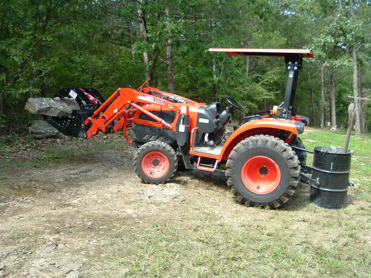

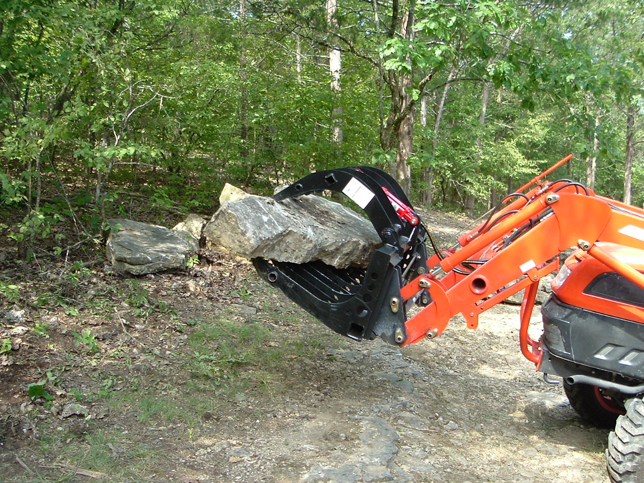

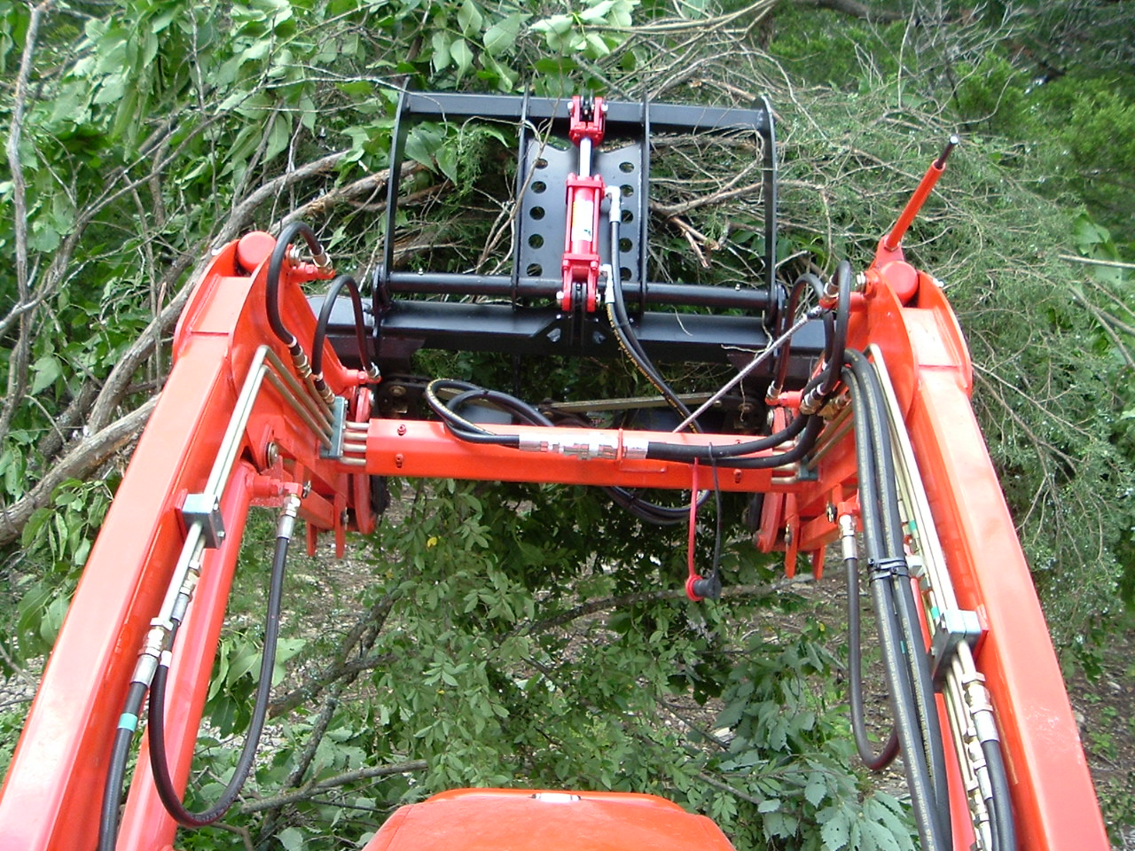

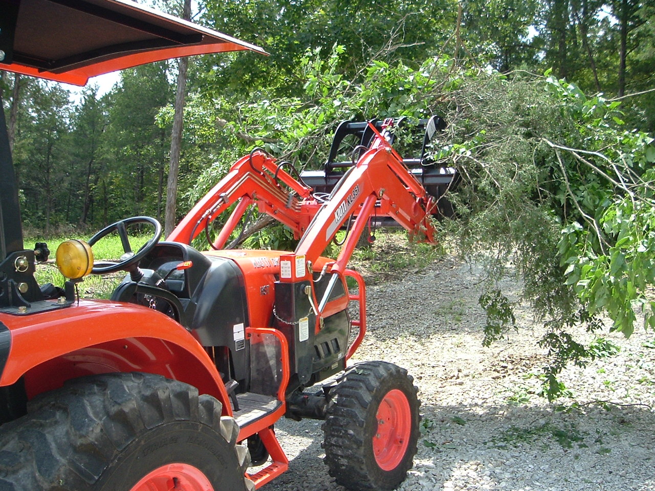

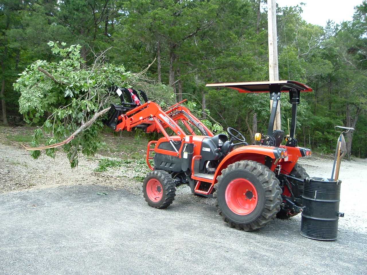

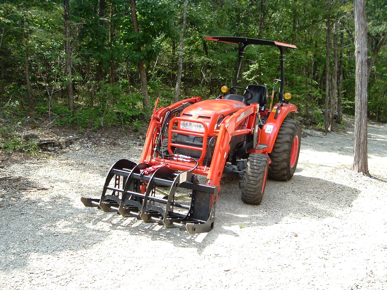

Yep, you definitely need a grapple. Life can be lived without a grapple, but some would question the reason to do so.:)
I Have the Everything Attachments single lid 50 inch Wicked. It would be a good fit for the OP's machine also.
As Homer Simpson would say, "umm grapple"..
IMG_20140401_161949_520.jpgDSCF0550.JPGDSCF0548.JPGDSCF0547.JPGDSCF0551.JPGDSCF0555.JPGDSCF0554.JPG
/ Attachment Wishlist....Whats everybody think? #14
SWEEEEEET grapple you got there KOua. Great buy!
It is a pretty cool grapple. I made an offhand comment about it's ability to pickup small objects because the teeth come together. I said I thought I could pickup a pencil with it and drop it into a 5 gallon bucket. So I was challenged by another member into making a youtube video of myself doing just that. I haven't made the video yet, and I haven't even tried to pickup a pencil with with it. but I am seriously thinking about doing it.
