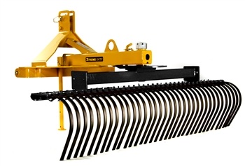

Based on the implements you already have, my vote would be for the 7-8' landscape rake. But I would suggest you get one that can spin 360° so you can reverse it at an angle and actually plow snow with it, as well as rake up branches, roots, and redistribute gravel or dirt on your driveway or trails. I use mine a bunch. I have a ¼ mile gravel road to maintain, plus a 600' driveway to the house. I'll take the rake over a box blade any day.
Just my 2¢

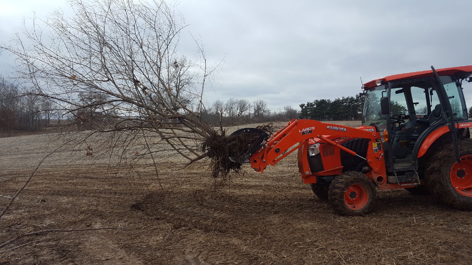

You asked what is my go to attachment?
My EA 55" Wicked Root Grapple is my most used attachment. I have a toothbar added onto my bucket, which is nice and makes digging in hard dirt easier. Based on my experience with my grapple and our needs, I wish I hadn't waited to by the grapple. The grapple acts like that extra strong arm that you wish you had. It has done everything from tear down buildings to move equipment to rip out brush.
So far me, the grapple is my go to attachment.

...... I'll take the rake over a box blade any day.
A rake is a one trick pony (I had one), the box blade is the go-to implement for doing anything with soil, dirt gravel, etc. For grooming driveways go for a land plane.

How big are these "sticks"? Sounds like your not making hay so why don't you pick up the big one's and just bush hog the rest? Even with a landscape rake you'll break them up and maybe make them into a pile- that you still need to pick up. Can't see you being able dragging them very far without screwing up your pasture.
I've been somewhat absent here for a while (for no particular reason) and John the last thing I remember reading of yours was you selling your Deere and getting your financial act together. Cheers and respect to you for that brother. Personally imho, a rake has very limited purpose other than "touching up" a dirt road. You sound like you've gotten things under control and :thumbsup: for realizing that renting a phd made much more sense than buying for a handful of holes. Rent, borrow a rake and see if it does what you want, I'd be surprised. Some jobs are best done the old fashioned way, manually.
Thanks. I did get the finances in order, took about 19 months to be completely debt free besides the house.
Not having a loader tractor was driving me nuts so I bought another one and sold the Ford 960 I was using. The Mahindra is the only thing I owe on now and will be aggressive on paying it off. I really like the Mahindra so far, I figure I’ll have it paid off in two years or less.
I thought a landscape rake would be more useful, maybe even replace my rear blade but now I’m not so sure based off these responses lol. I was picturing clearing sticks from my pasture, clearing trails where I hunt etc. maybe I’ll hold off on the rake. The toothbar I pictured ripping out saplings, scrubs and aiding digging.

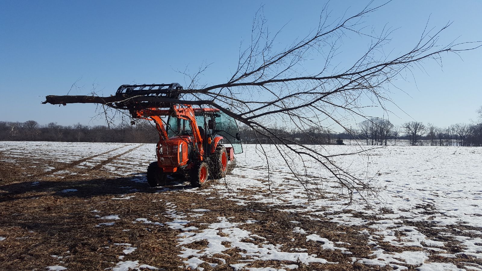

Re: What attachment to buy next thatç—´ most beneficial?
Your tractor is the ideal weight to utilize a clamp on Bucket Spade. A toothbar is not very useful for digging on a wide bucket.
MORE: https://www.tractorbynet.com/forums/attachments/328798-bucket-spade-today-fel-bucket.html?highlight=
Consider a Ratchet Rake bucket attachment for tearing out brush during your commercial mowing jobs. I almost always have Ratchet Rake attachment on my bucket when mowing Florida jungle. It is much easier to mulch vegetation with a Rotary Cutter when vegetation is flat on the ground.
Ratchet Rake may serve for corralling sticks on three acres. Good for minor grading.
MORE: https://www.tractorbynet.com/forums...ratchet-rake-today-fel-bucket.html?highlight=

Thanks, I’ll read up on those and see if they are more useful than what I had in mind. The spade is new to me, the ratchet rake i have seen but forgot about. I’ll have to read up more on them. I remember doing a little research a year or two ago about the ratchet rake vs piranha tooth bar, for what I do leaned to the piranha which is why I was interested in the wicked tooth bar.
The spade on my forks may be pretty useful concept.

In my experience sticks get caught up in the tines, well at least roots sure do and then it doesn't grade evenly as the tines don't contact the ground evenly. Then in your wood's trails, unless the full width sits flat on the ground, your going to leave or miss "stuff". See if a local rental center has one and give it a try, if it works it can be a "cheap date" in terms of tractor implements. I have other better options (now) but my old 3pt. rake hasn't seen the tractor in years. The last time I used it was pulling all the leaves out of the edges of my long drive in the fall. They get mixed in with the gravel and give me crappy results in the springtime dressing up the drive. (leaves bunched up in the gravel)

Maybe I’ll find one to rent first, the rake I had in mind is $1250 plus the $350 gauge wheels. Would be an awful expensive mistake if it wasn’t as handy as I think it would be. I bought my BB new and have been really happy with it.
