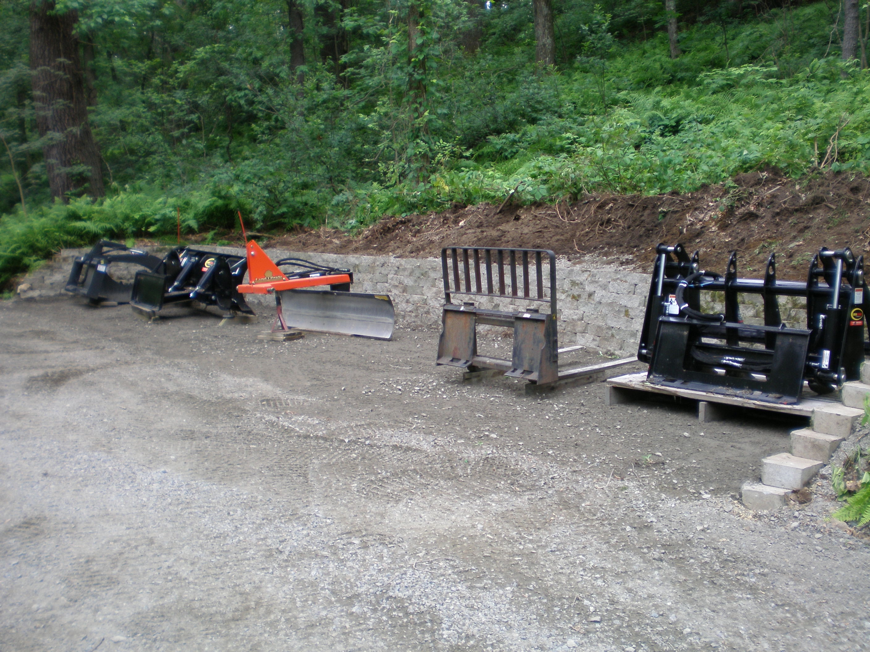

I store my tractor with grapple and rear blade under cover in a carport. The chipper & mower are in another stall in the carport. The plow, bucket, LPGS, disk harrow are all in a row on pallets out on the far edge of the lawn. Thats the best I can do with what I currently have. Powered stuff under cover - non-powered stuff outside.
