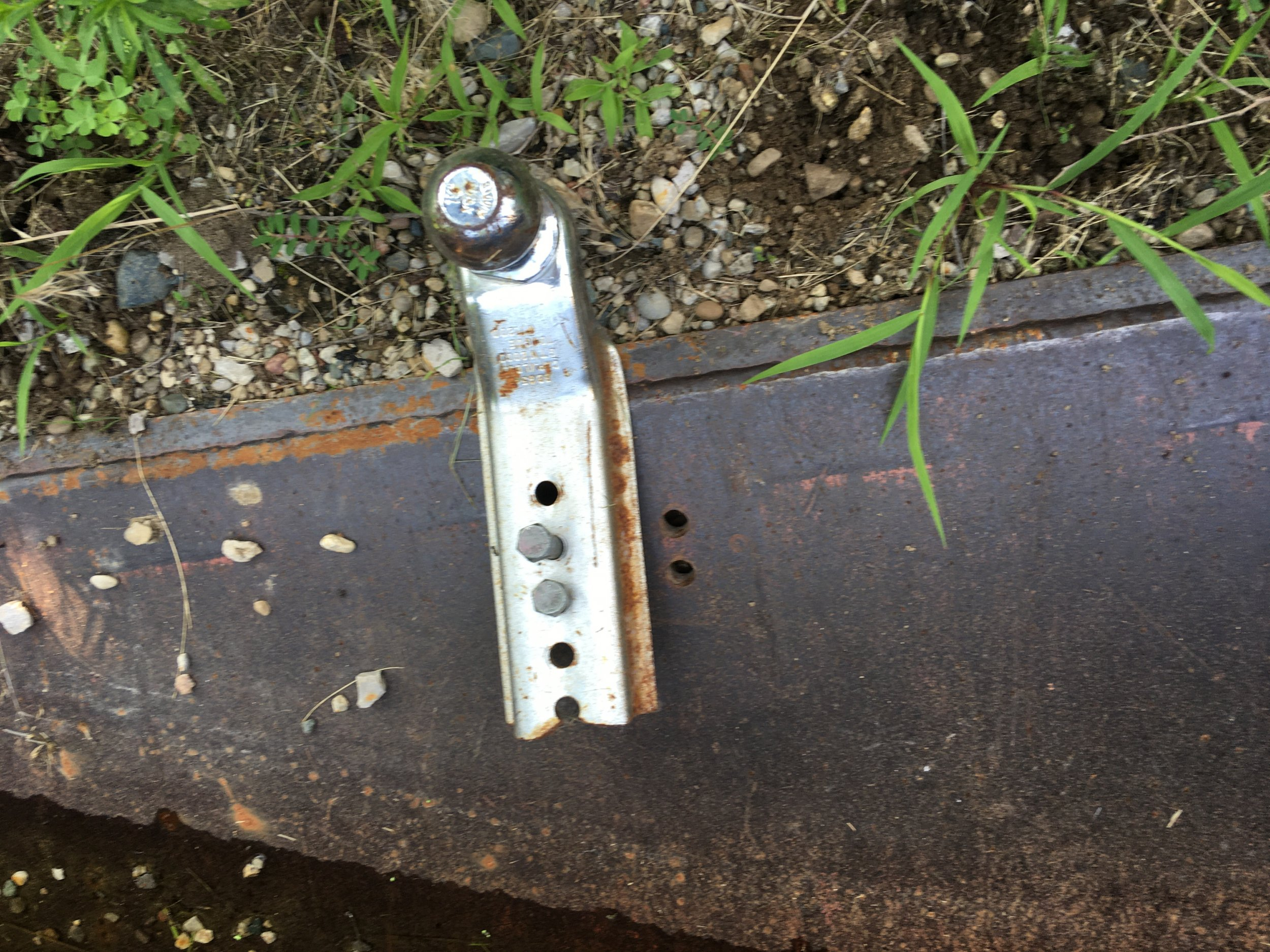

Does the BX have position control on the 3PH? I use my smallest CUT (<2k lbs) for hostling trailers. (FEL cap <800 lb) None (car/tractor hauler, 6x10 ramp-gate, etc) have a tongue weight that tips the tractor with LR or blade on the 3PH vs a serious counterweight. Need at least something for using the FEL anyway and the LR stays on 'Red' for grading vs swapping out for a draw-bar.
I drilled two holes in the bucket and bolt the balls to short extensions so trailer tongues don't foul on the lip and I can tip the ball up to line it up to connect when looking over the hood. (Actually have two b'cuz I keep losing one) Two 7/16" bolts to attach. All trailers are hitched to the towing vehicle when loaded or unloaded. Here's the one I could find. (second attempt at pic upload)
