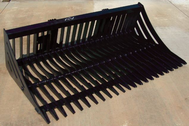

Skeleton rock bucket will work nicely.
I found them to only work in very dry soils with no vegetation otherwise it will clog up and not let what little soil that I'm dealing with fall through. It also required vigorous fast shaking on my SS that most tractor loaders can't do.
Yes. I'm able to shake mine okay to get the dirt and duff cleared but I also have the benefit of five months of no rain every year, reliably. Our soil - like yours in Maine probably, is mostly rock - ours is all volcanic though.

As others mentioned you need the right conditions for a rock bucket to work. Two of my neighbours tried clearing with rock buckets with no success. Our soil is glacial till with lots of vegetation. I use a tough cultivator and landscape rake to clear our areas. The cultivator will pick out softball-size rocks and loosen up to basketball-size rocks. Then I have to pick the large ones out by hand. The landscape rake is good for collecting the smaller rocks and finishing the surface.
This will work. It will be slow though. You'll need a passes thru though. He first digs things up, lays out clumps and let's them dry. You'll also get big rocks on this pass. The second pass shakes out the dirt and removes the dried up vegetation. On the third the ground will be broken up enough so you get the screen action to separate the rocks.
A few passes with the teeth down with the box blade will really help.
All it takes is patience and time.

I bought a rock bucket years ago and found it does not work as well as I expected. I have considered adding a hydraulic powered shaker to it. That would help get the dirt to fall through but would still require dry conditions to work.
