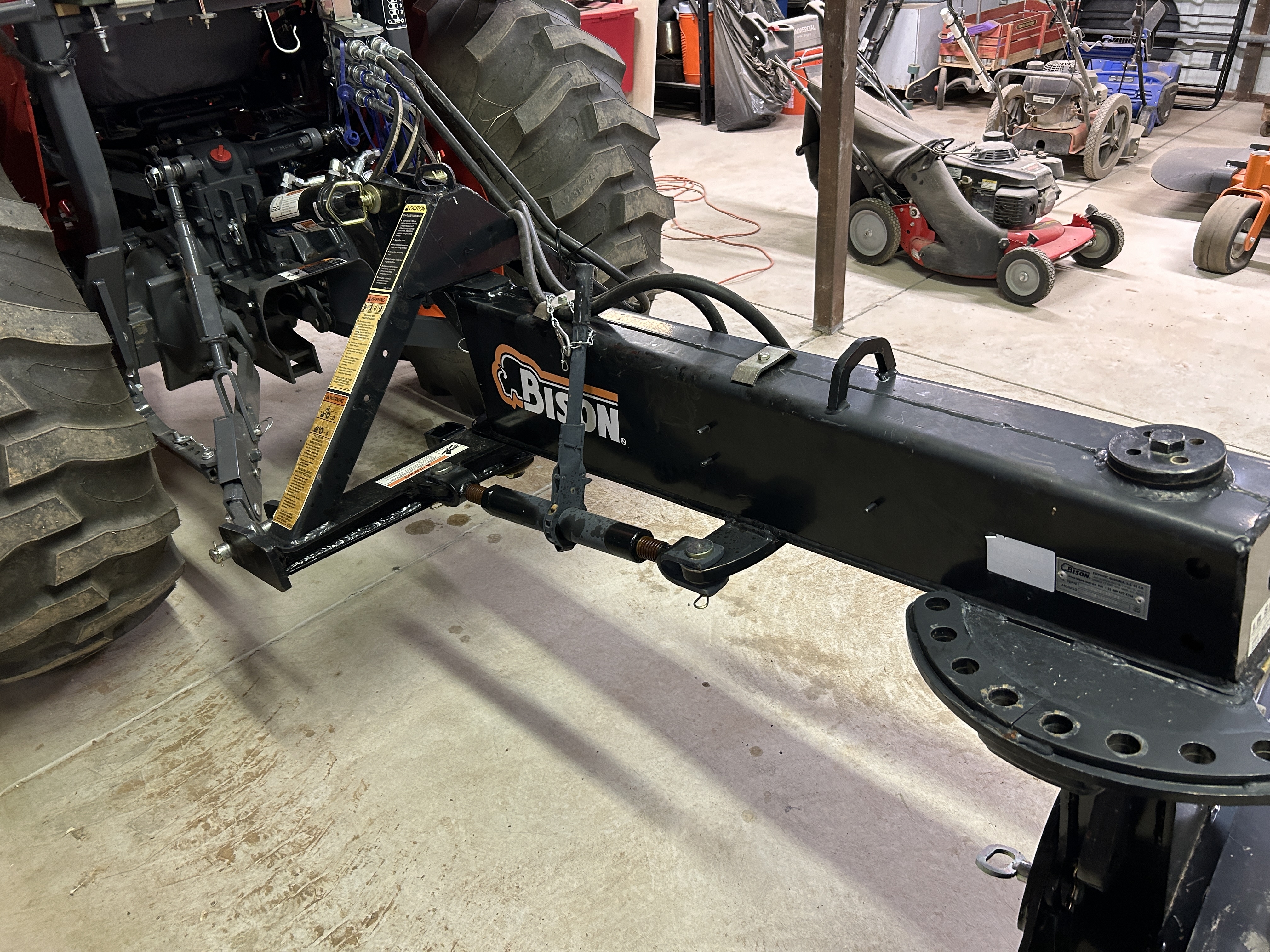

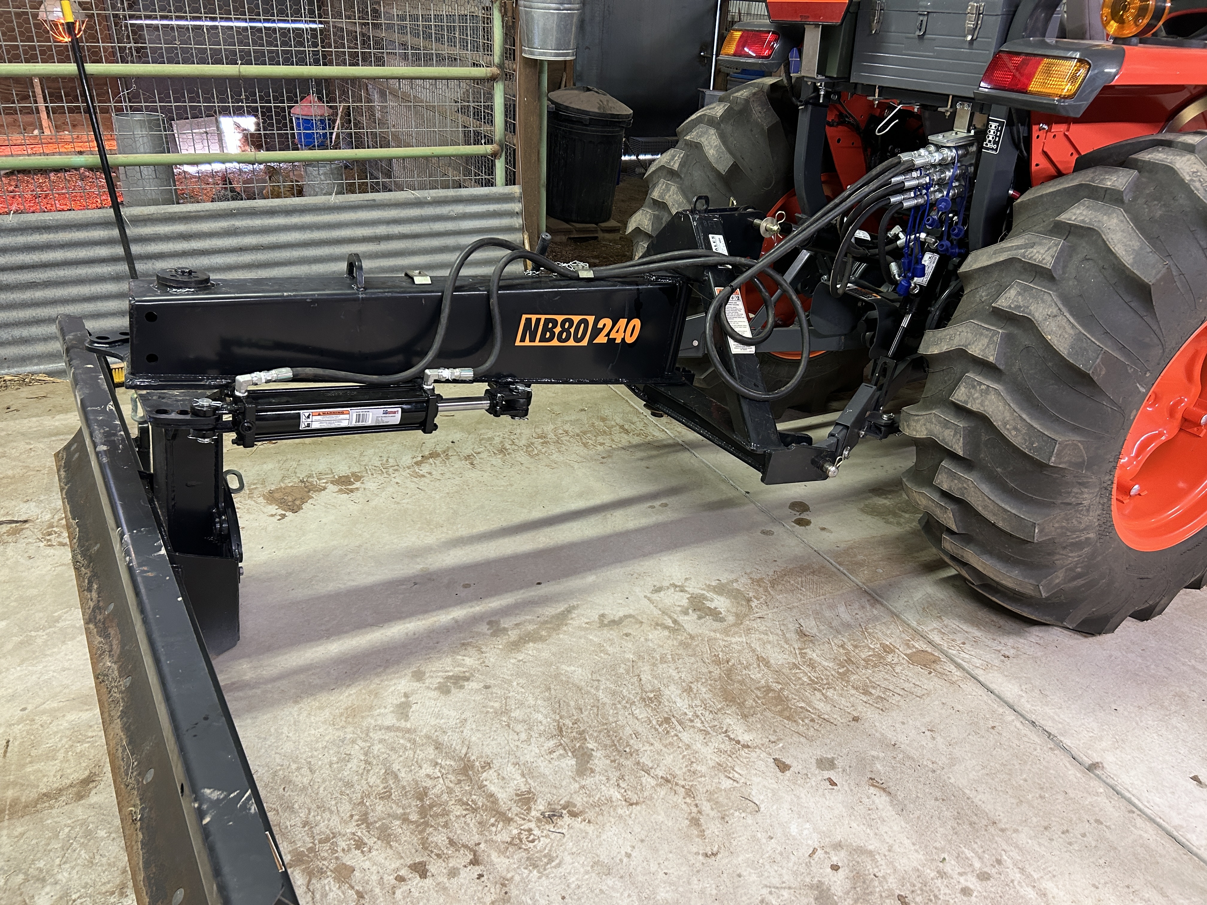

I clean and grade my ditches. I have a mile long gravel driveway. My Kubota M6040 with grapple and rear blade weighs a tad over 10,000 pounds.
My first tractor - Ford 1700 4WD - did an adequate job of clearing and regrading the driveway ditches. I had a 450 pound Land Pride rear blade then.
Your 1920 NH is the same as a Ford 1920 and weighs around 3000 pounds. With that front weight and being 4WD it should do the job for you. Now to find a rear blade that will tilt 25 degrees.
If you plan on clearing snow with the rear blade - offset, angle and tilt are a real benefit. Honestly - if a rear blade has tilt - more than likely it will also have offset and angle.
I agree. And this is actually why I bought a larger tractor and heavy 8’ blade . I have the same situation with needing to maintain a fair amount of road with ditches. The key is a blade that will offset a long way, tilt, and has weight, especially if there’s any drop off on the ditch side. I just completed adding the hydraulics this week, so things will get easier this year for snow plowing.
