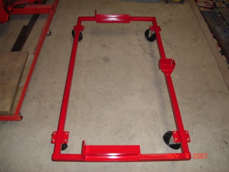

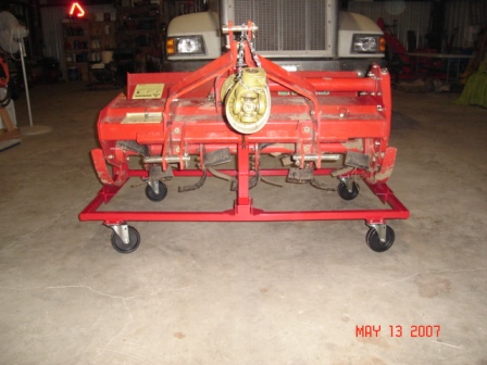

/ Attachment dolly #2

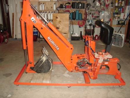

Here are the two I built, the BH stand was my very first welding project with a Hobart 125, that was the first and only project the Hobart did, my MM175 has done everything since.
Some here use furniture dollies, pallets with wheels and other custom wood dollies.
Hooking up cannot be easier.

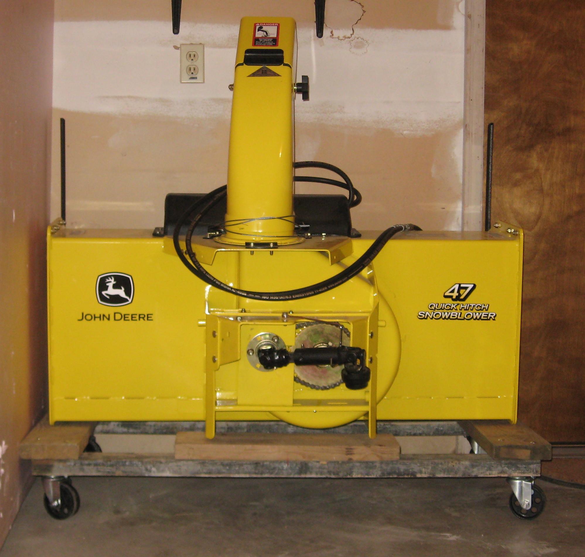

I made a couple recently. Basically just big furniture dollies except I used cast iron casters. I actually do keep my loader bucket on a regular furniture dolly.

Search my posts from a few months back and you will find descriptions and photos of what I made with 2 x 4's and OSB. . I can roll around my 1000 lb tiller and 950 lb Brillion seeder easily. Hookup is a breeze.
Don't use too big a wheel or it makes hookup difficult.

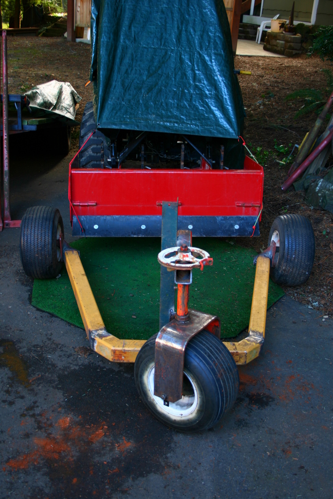

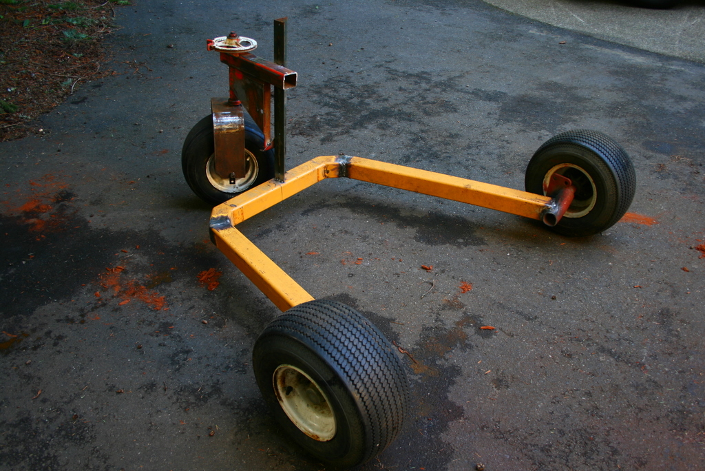

Interesting this should come up just now.
I have just this afternoon finished the major assembly of my Attachment Handler, although the attached pix are from a few days ago. (more pix will follow in a few days when I get it more completed)
I needed something to pick up attachments, and transport to a storage area that is both awkward (small) and fragile for my tractor to operate in. So far I need to handle a ballast box, a box blade, and a rototiller.
The concept is a "rough terrain engine hoist" using golf cart wheels and tires, one of HF's long hydraulic jacks. If all goes as planned, I should be able to pick the attachment, place it on the arms, and wheel it to the tractor for easy hookup, and visa-versa to tuck it back out of the way on our rather small property.
Not too far from the first test run, keeping my fingers crossed. :D

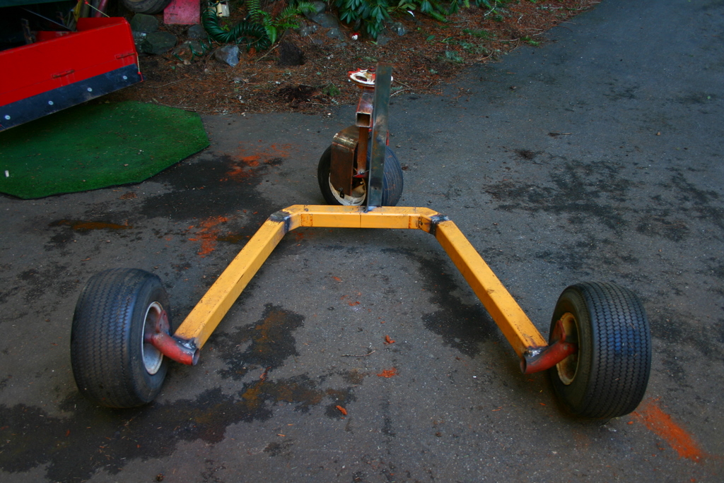

Here's the latest update.
Another wild hair (I have lots of those :D)
It would be pretty easy to add a bolt on lifting frame to utilize the tractor forks as a rough terrain pallet jack, although this particular rig would need narrower pallets. I personally don't have any need for this, just another passing thought.
Now working on the final lifting arm and hook details. (I did try a temporary lashup and test with my 400+ pound box blade which went very well indeed, but I didn't take any pix just in case the safety police were watching :eek:)

Didn't intend to hijack this thread, so here's the final test result.
This poor old rotovator came with the tractor, and I haven't had a chance to mess with it, so it's been sitting in the weeds waiting for some love. Today as a test of the (guess I should call it a dolly) dolly, I dug the rotovator out and moved it to where I could simply hook it up to the tractor. Slick as could be.
Also in the "wild hare" department, I realized that I can easily set the rotovator up on some sturdy work stands to give my old bones some respite during reconditioning, as well as reposition if needed without firing up the tractor.
Another thought would be, stacking attachments at least two high (with proper stands) to save even more storage space.
The only thing besides paint for the "Dolly" is a simple brake of some sort because it rolls so easily that even on an almost imperceptible grade, it wants to sneak off before I can throw a chock in front of the wheel.
A Happy Camper

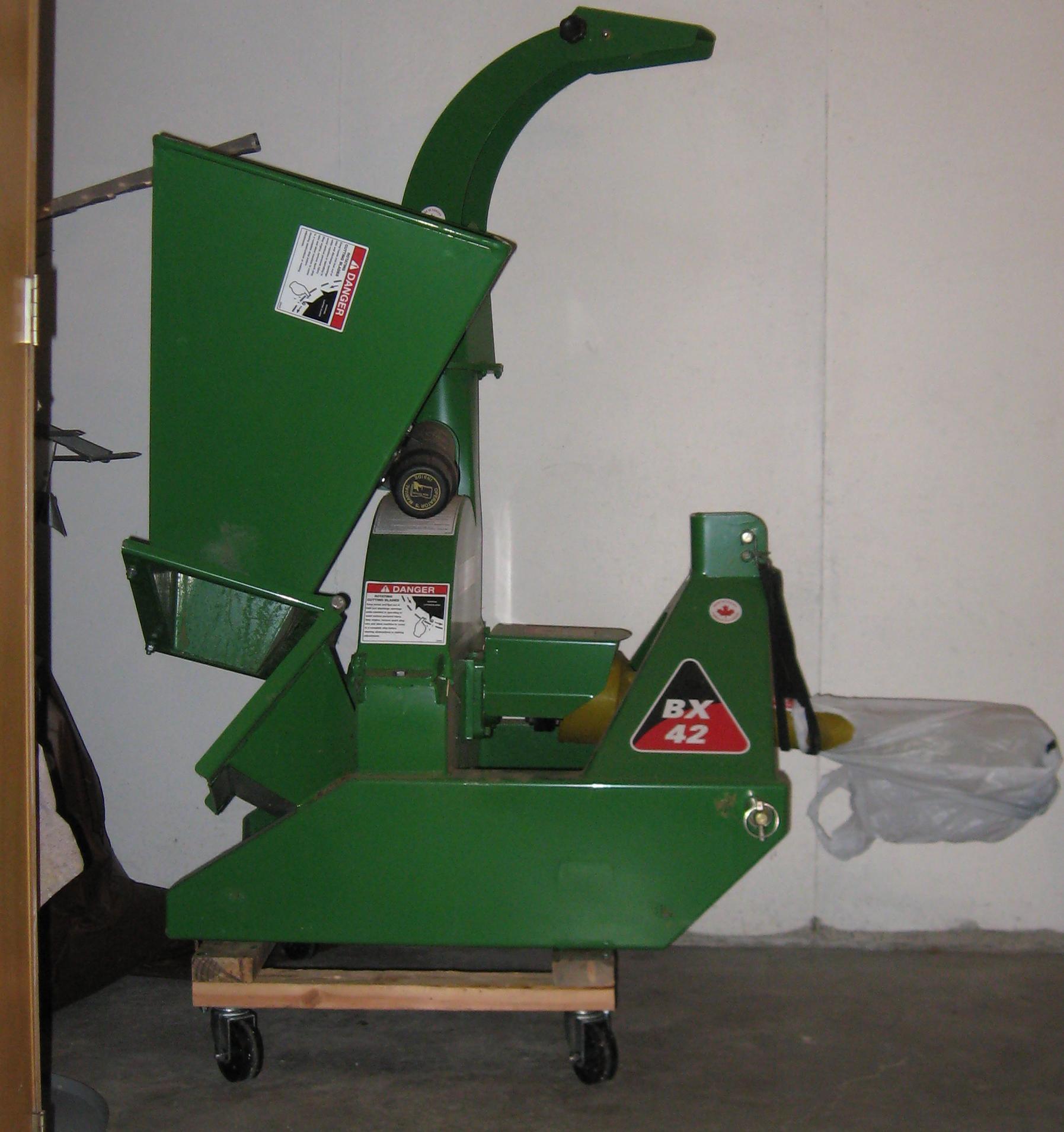

/ Attachment dolly #20
I built two different sized dollies to store my ballast box and BX42 chipper in the garage. I got the idea from the guys on this site and what a great idea it was. I had almost a full sheet of 3/4" pressure-treated plywood sitting around from another project and it ended up being just enough to build two substantial dollies to hold these heavy items. I doubled up the plywood for each one, screwed the two sheets together, drilled and recessed holes for the carriage bolts and bought some hefty casters at the local Tractor Supply Store. I also put a few coats of polyurethane on each dolly just because I felt like it. I think I could probably put a lot more weight on each dolly based on the capacity of the casters times 4 and the capacity of doubled-up 3/4" plywood but that's how I like to build things. It's great to be able to just ease my 400 lb. chipper around the garage if I need to move it for some reason. Money and time well spent.
