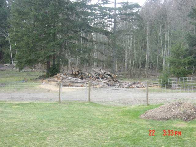

That wood isn't much of a work out for the splitter. It looks like the Alder we have here. You can cut these Adler trees to length. Let them lay for about 3-days, walk through with the blunt end of an ax and split them.

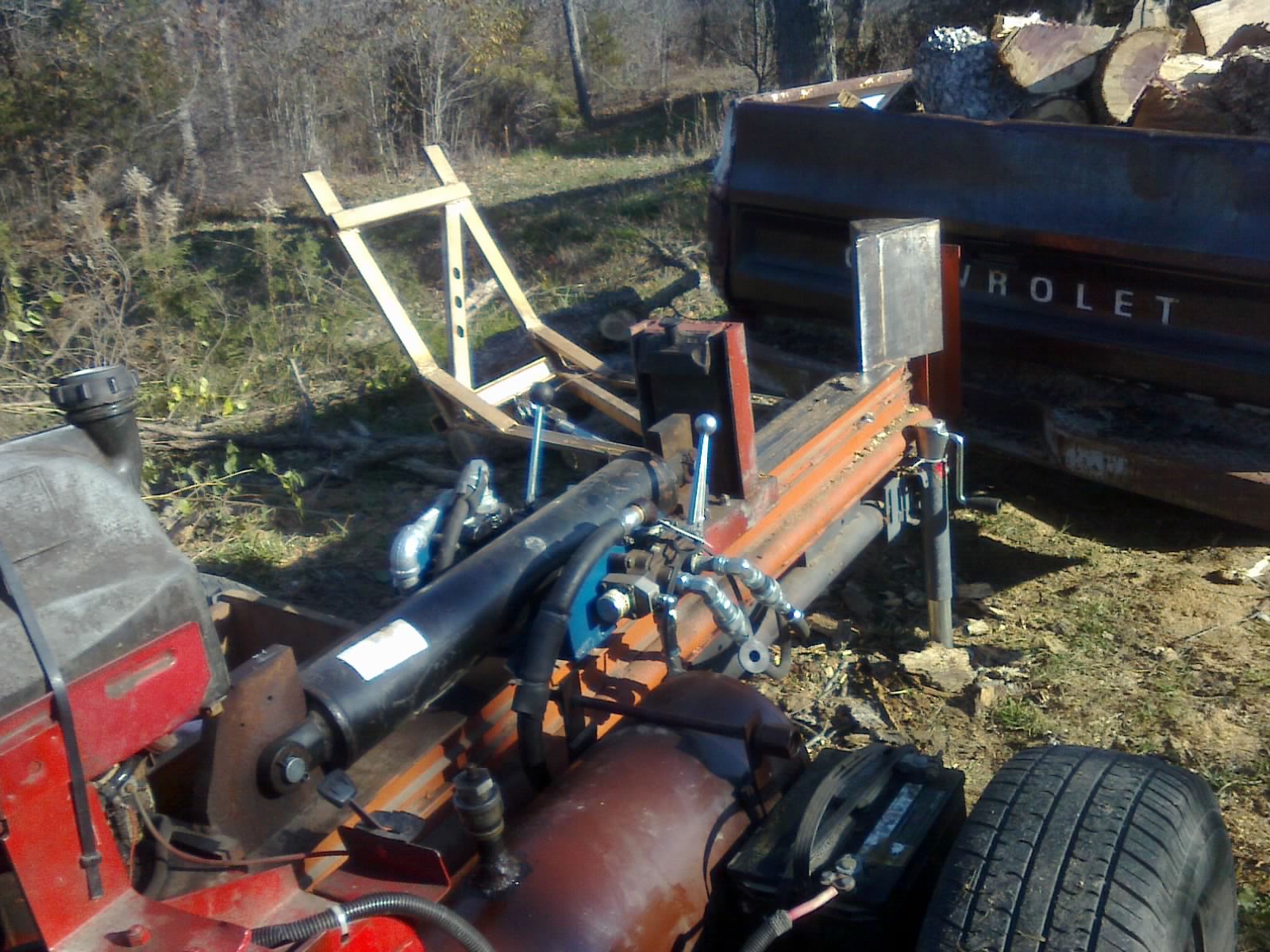

This wedge is sitting on top of the beam at the end with another piece of I beam standing up behind it and welded to the wedge and the end of beam and to the tongue of chassis. My friend and I build this about 4 yrs ago and added the log lift last year.

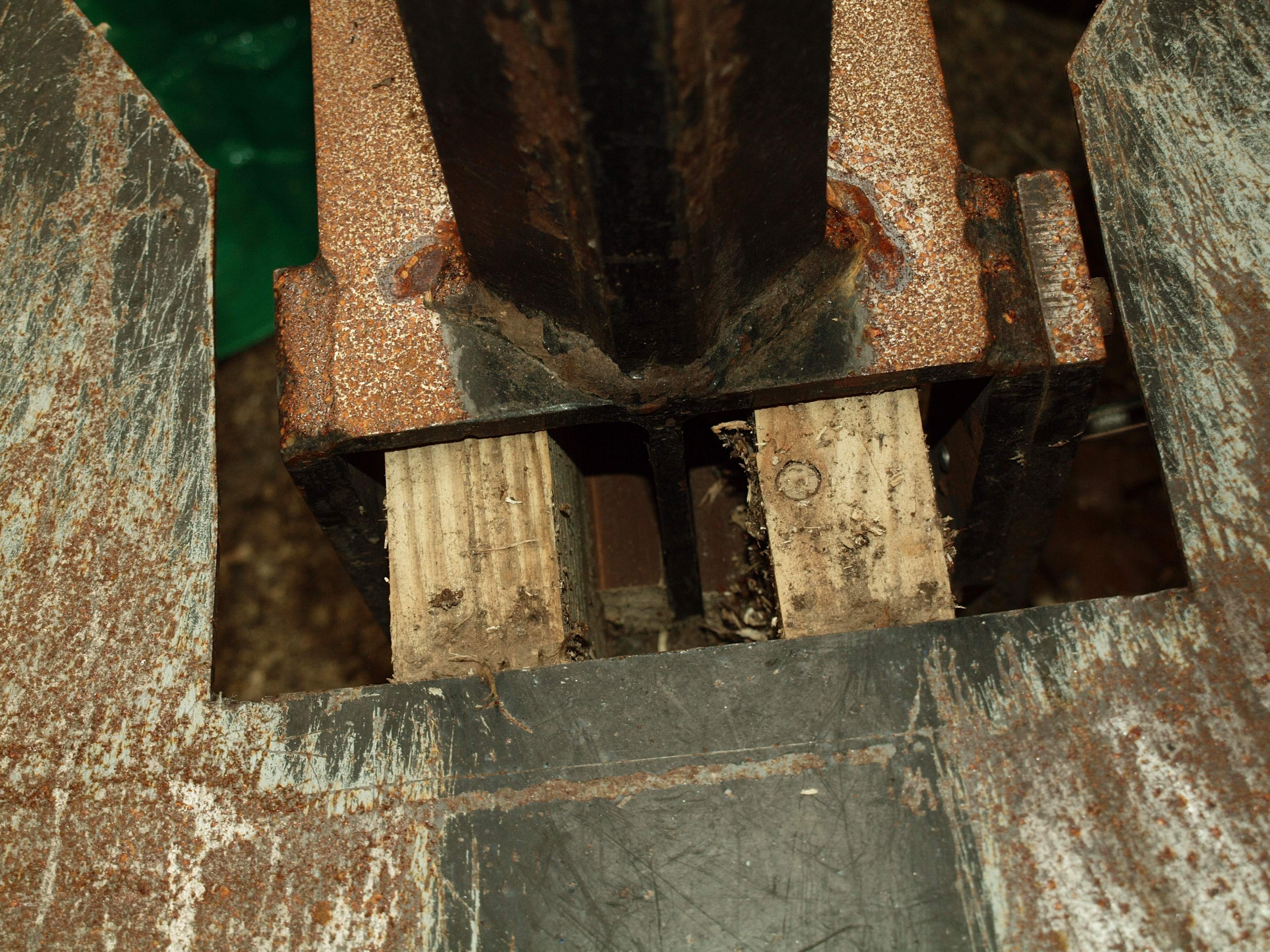

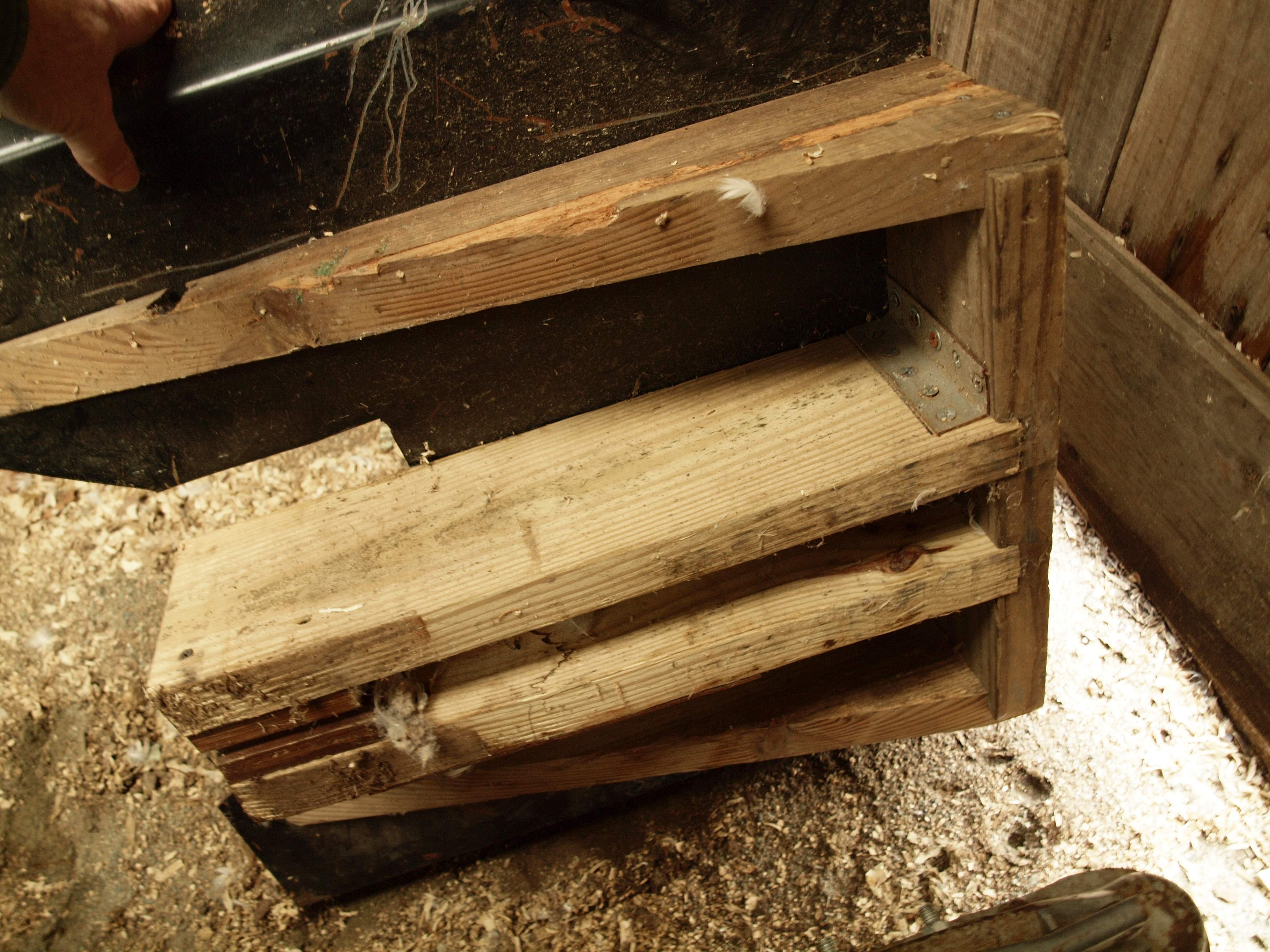

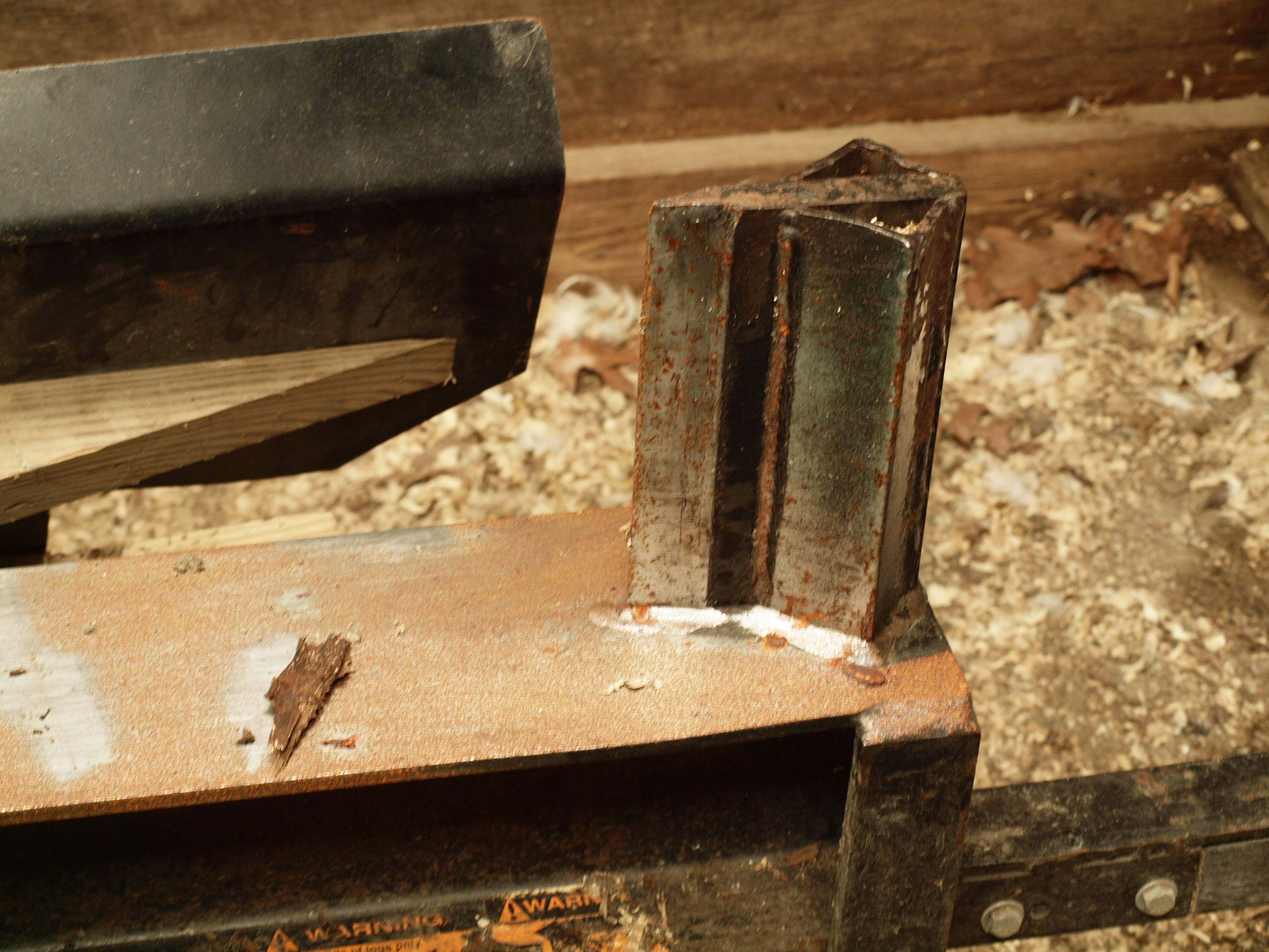

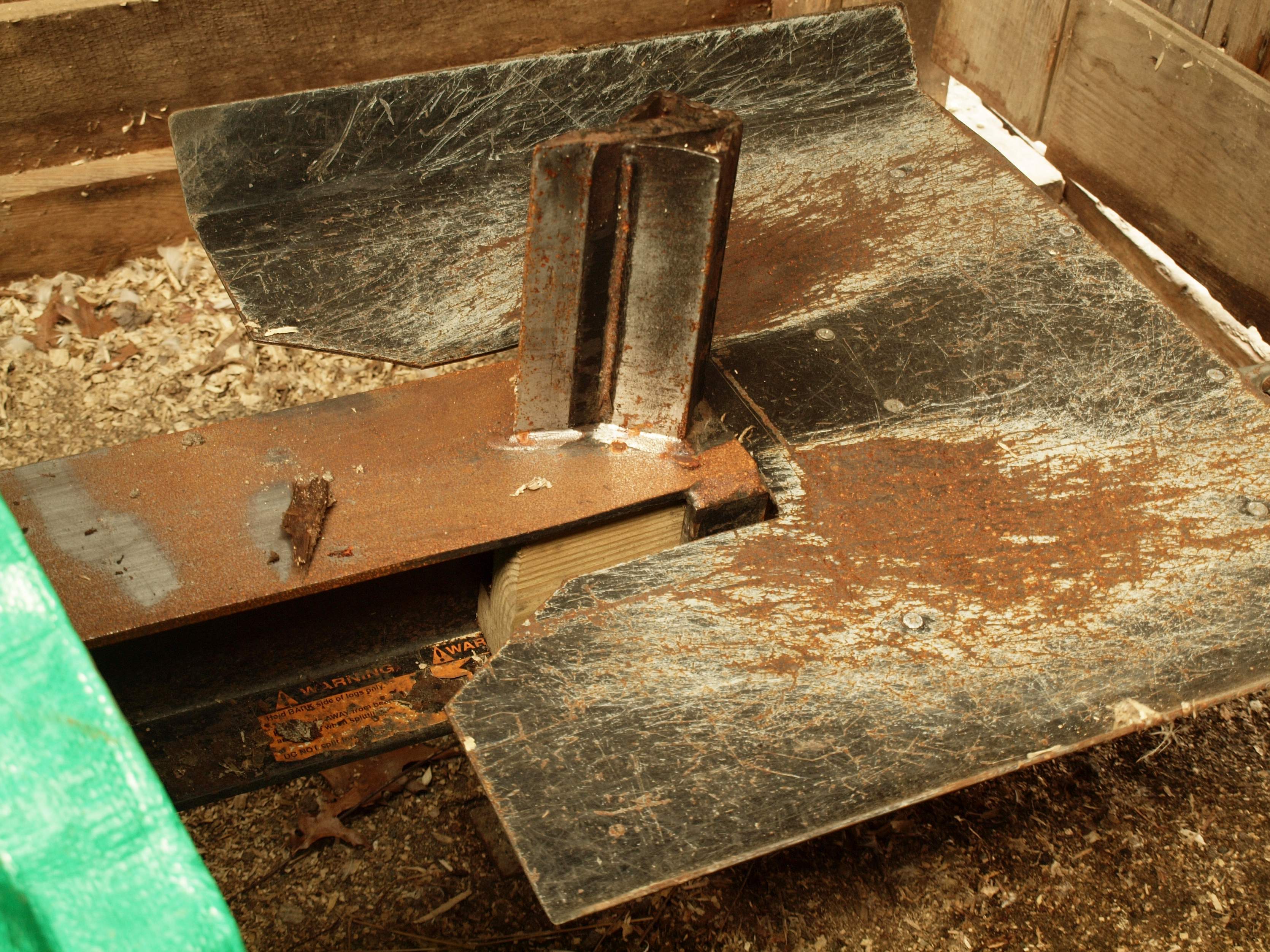

How I did mine

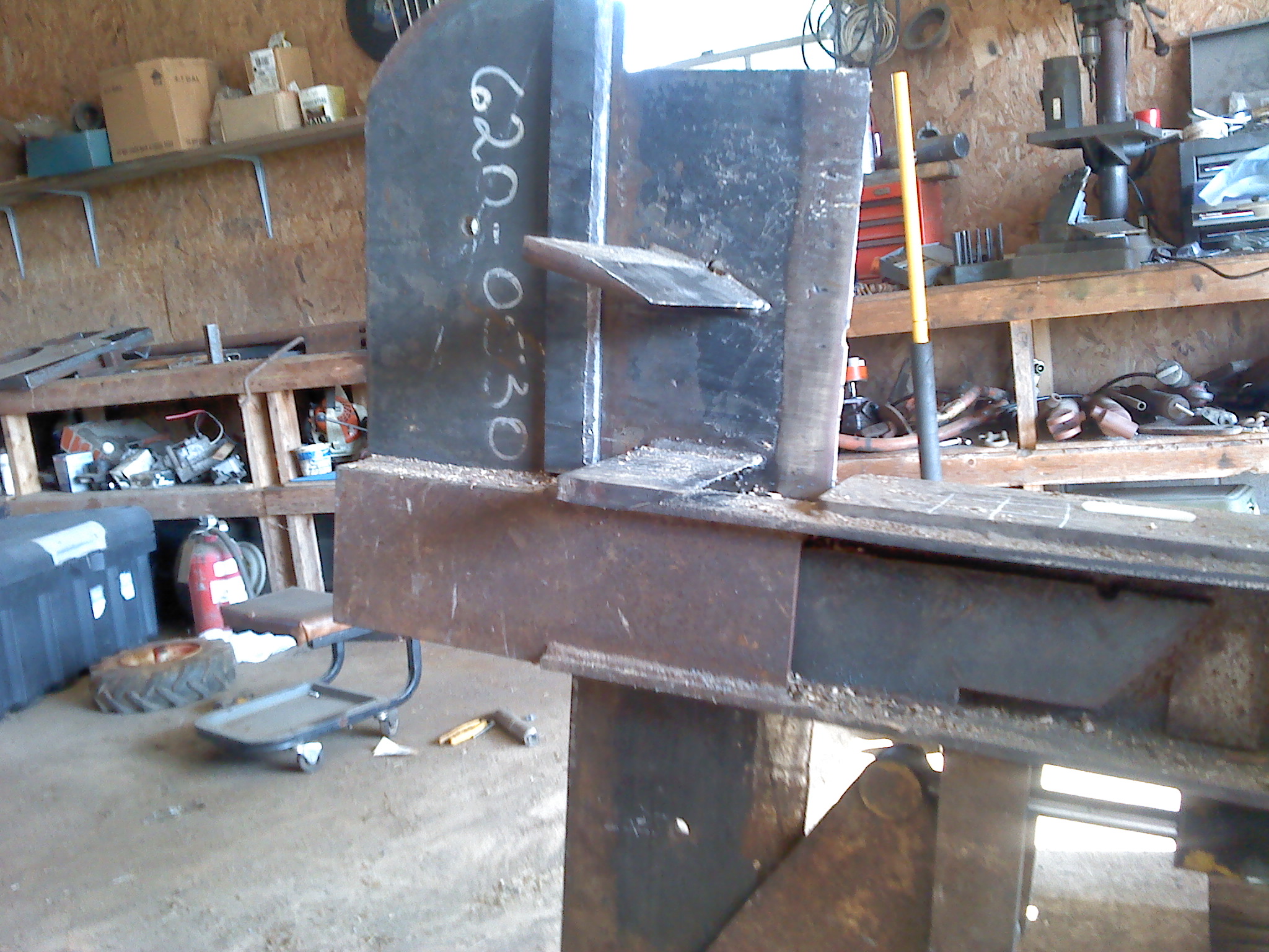

Got the wedge done.
Now to find time for everything else...

How I did mine
I know this thread is pushing a year old but do you have any more pics of your wedge from other angles? And how you connected it to the cyl? I've been having a similar thought to what you did for an up-coming processor build. Anything you'd do differently?
/ Attaching wedge to beam: Best method??
#29
I can probably take some more pictures tomorrow, but what are you looking for specifically that isnt pictured?
The cylinder is just a pin. The base end had two "bars" welded to it that are on either side of the anchor block. Kinda like a yoke but not a forged piece.
There isnt anything at this time that I would change.
/ Attaching wedge to beam: Best method?? #30
I was actually looking at muddstopper's adjustable wedge. Seems like a simple way to get 2-4-6 options.
I do like they way that you've got your wedge and cyl mount tied into the beam. You already having asked the question saves me from even having to consider it. :thumbsup:

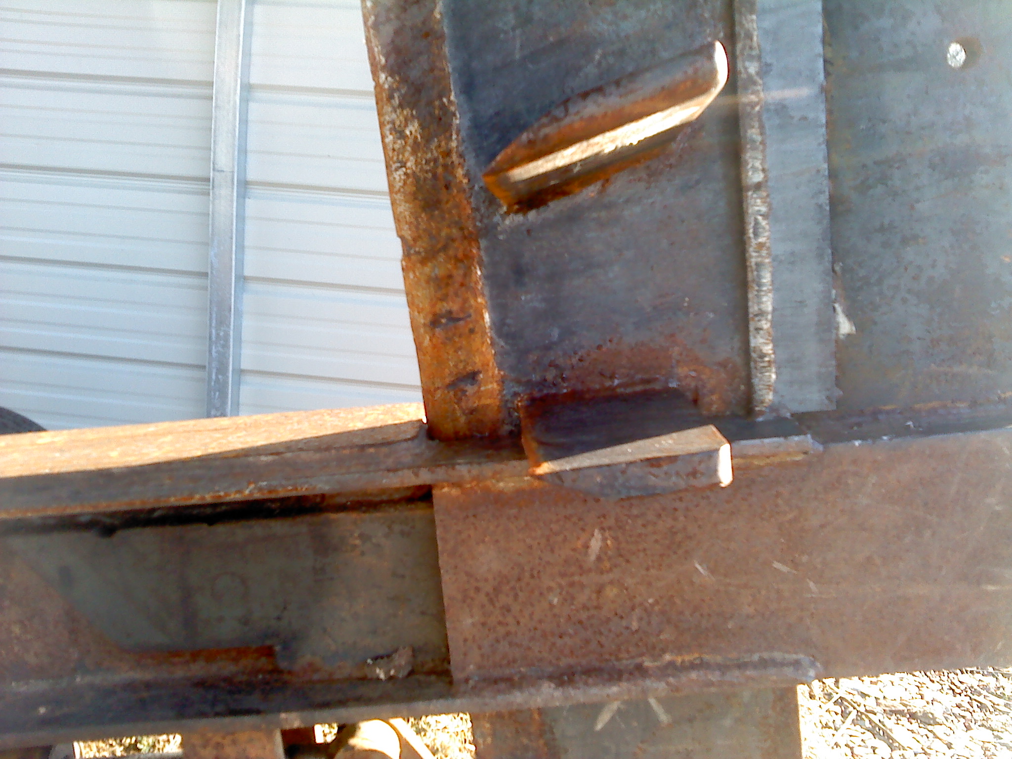

these are all the pics I have uploaded of the wedge. You asked what I would do different, well I did make one change. If you look at the wedge support, I welded a guide to the support for the wedge to slide up and down in. I figured this would help keep the blade lined up with its backbone. What it did was become a catch for every little splinter that slid by it. Slivers of wood would get wedged between the blade and the guides and keep it stuck all the time. I removed those guides and welded them to the blade, Now the splinters cant get wedged and no more stuck blade. As for the 2-4-6 way split. The blade will raise 12inces. The bottom wings sits at the top of the hbeam so that the top wing acts as a 4way. I can raise the wedge up 6 inches and now have a 6 way, or I can raise it 12 inches and slide a 12 log under the wings for a 2way split. The bottom wing in fully raised postion will be in the center of a 24in dia round and require resplitting the bottom two halves, but most wood I just center the blade for 6 even splits and dont have to any resplits. My processor will have a 12way blade and function pretty much the same as my current 6way. With wedge at bottom lift, 12in and under round will pass thru the center circle for a 4way split. Depending on the size of the round I should be able to center up on up to a 27in dia round and have 12 even size splits. Anything over 27in wont pass thru the saw frame so it wont make it to the wedge.
/ Attaching wedge to beam: Best method?? #35
Thanks mud, very helpful. Especially that first pic. I had noticed that about the side guides being on the back and you confirmed what I thought. With it a truly floating wedge, it would be easy enough to swap it out for an 8 or 12 way if the logs were big enough to need it and avoid the resplits.
