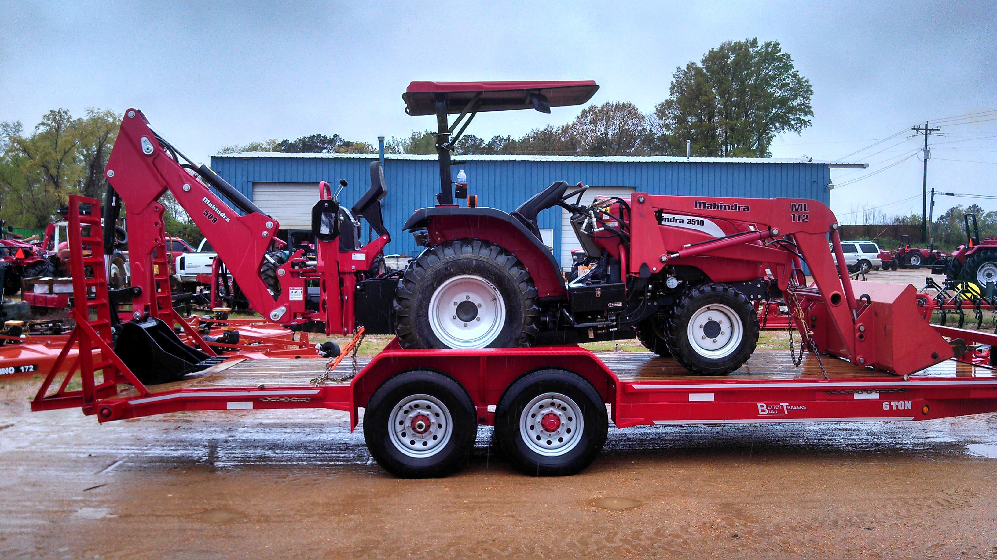

ive got 1700 ft of water line to dig. root bound septic line to replace, and a footer for a cabin. just for starters. im gonna be logging with it. in fact im building a log arch as we speak. so i dont want no sissy backhoe. what could i exspect from a 35 to 40 hp would that give me enough grunt?
Tough as a old boot

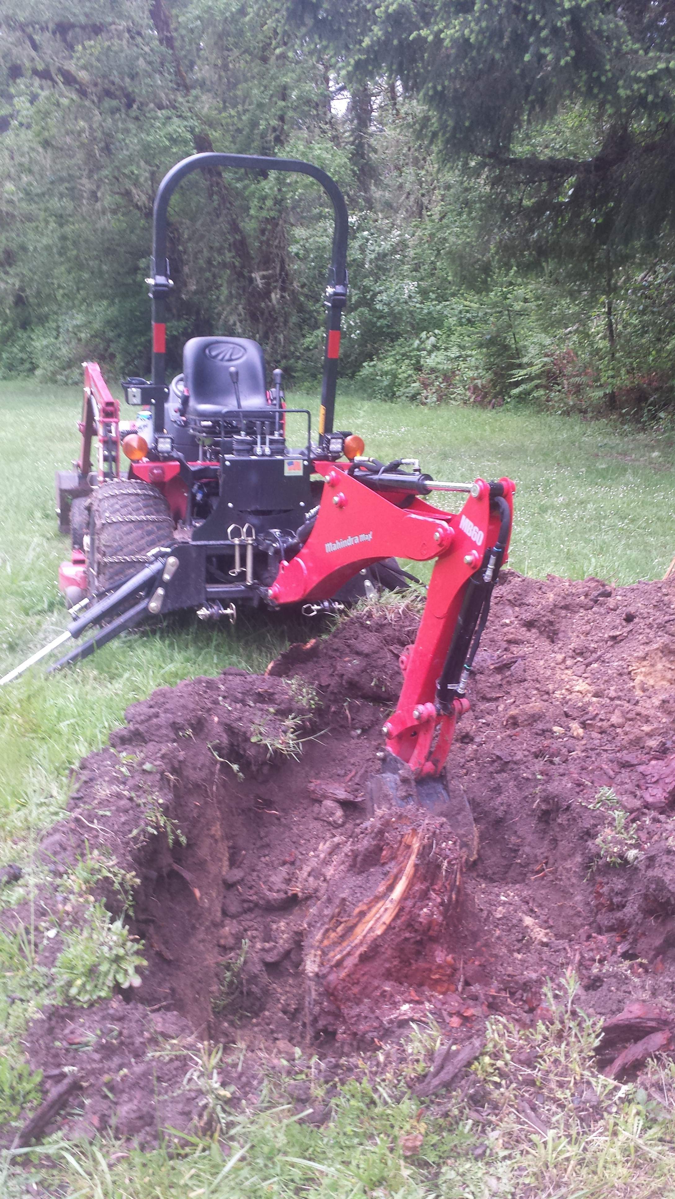

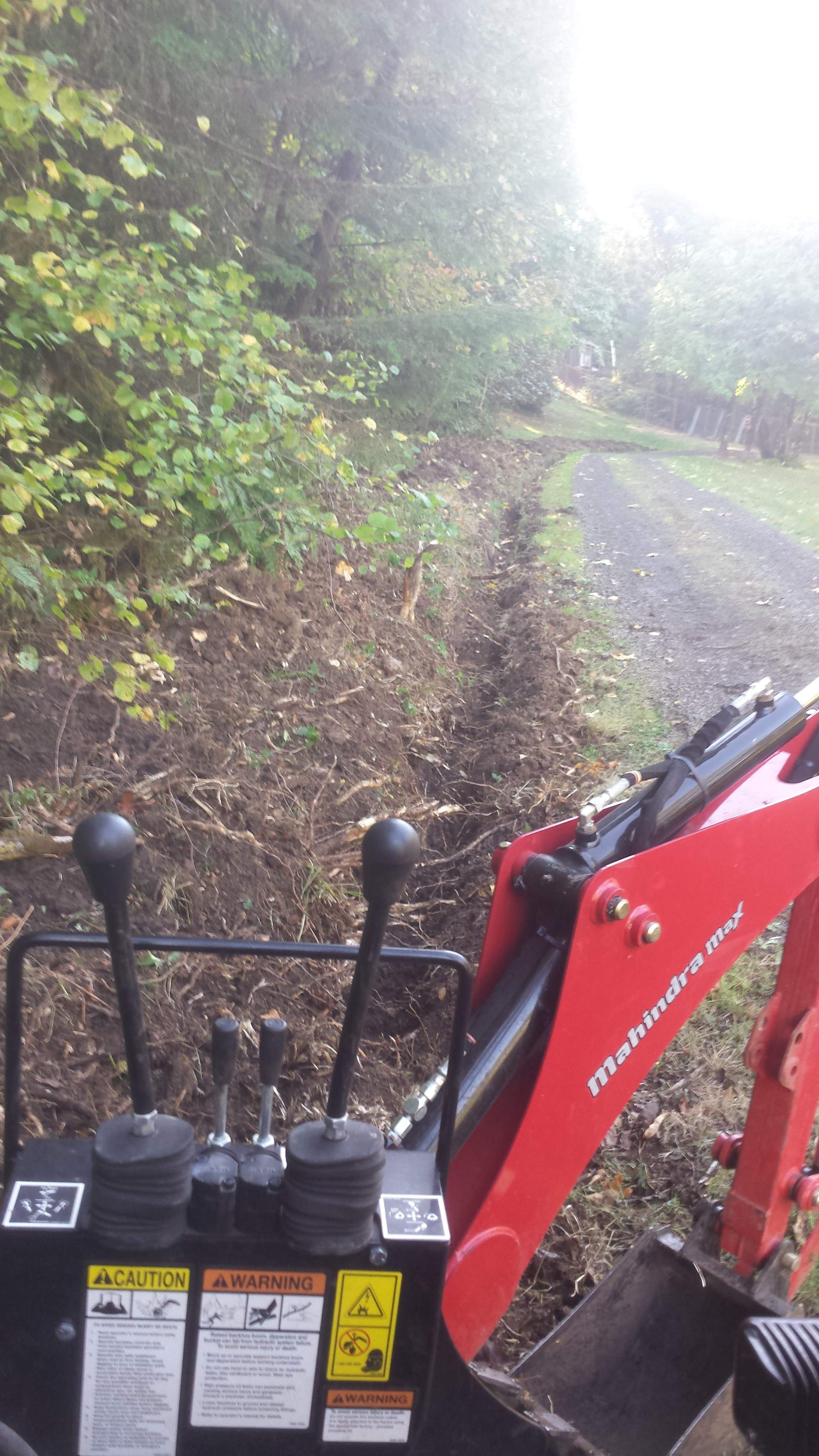

When I was backhoe shopping my local Mahindra dealer told me they would not stand behind failures because of a non-frame mounted bh. These guys are selling these practically in my back yard and was tempted by the price for sure. Backhoe - Value Leader Implements
I ended up buying a sub-frame Mahindra bh. I put her to work. Shes not the biggest or most powerful of a big hoe but she does what I need it for. After using it, I can understand how hard on the tractor a backhoe is on a tractor, especially how hard this little MAX works for its size.
