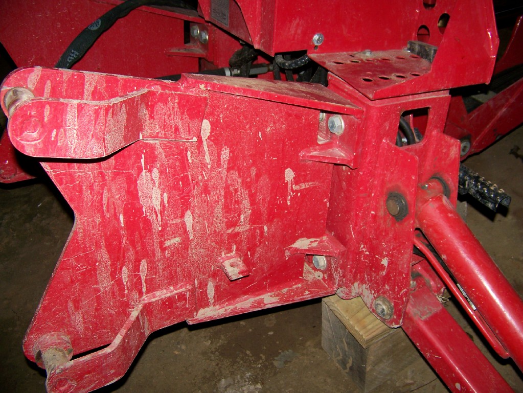

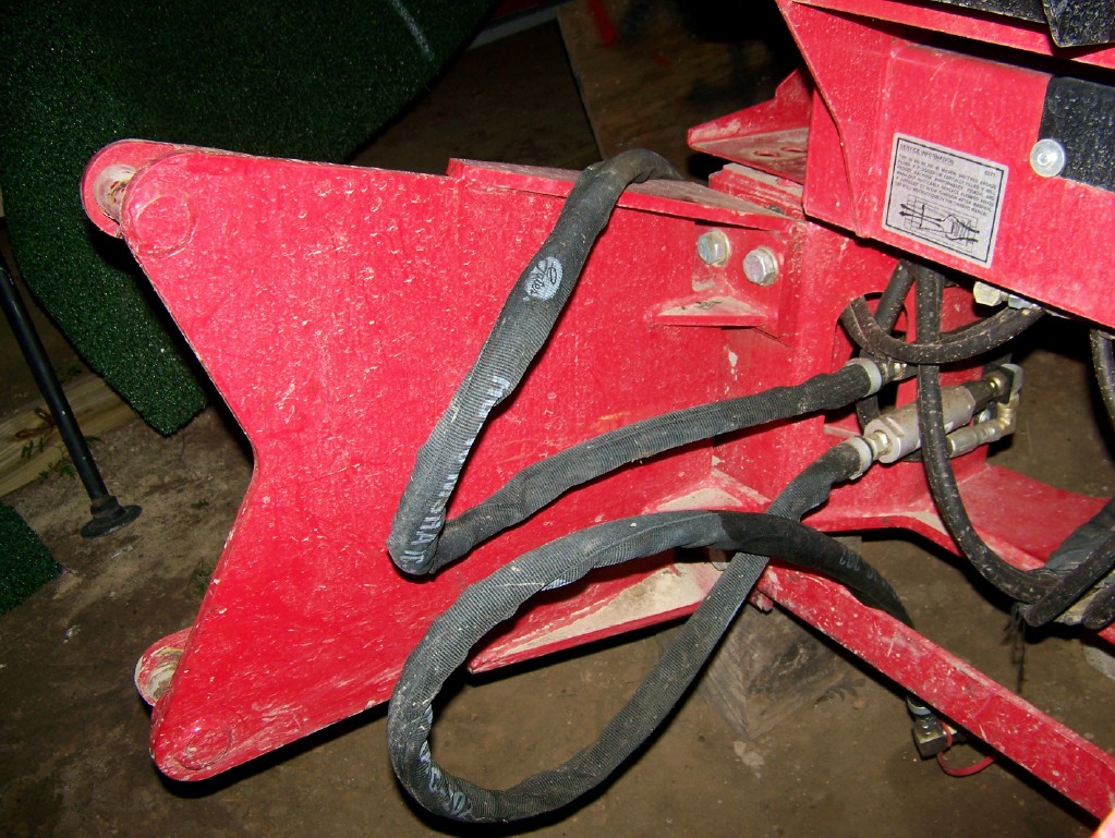

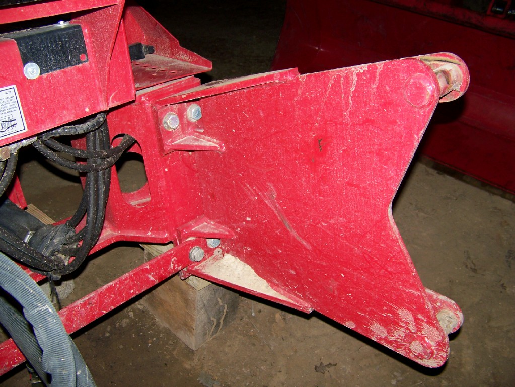

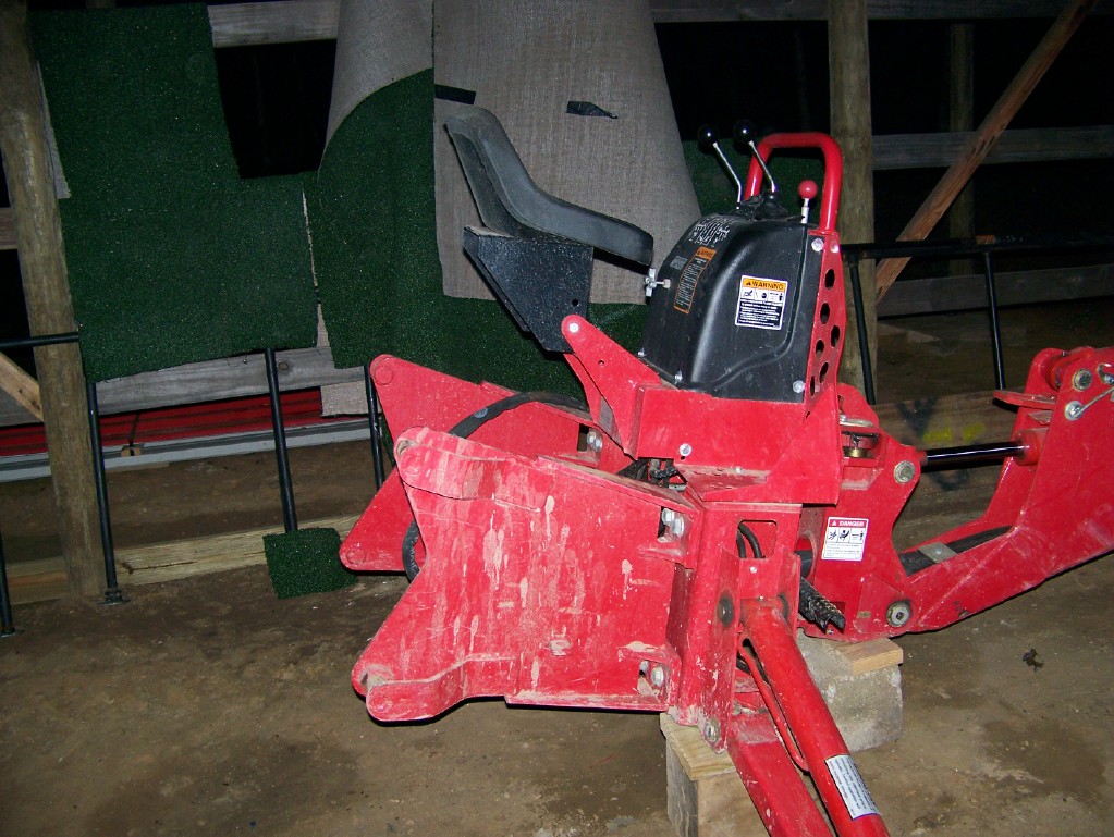

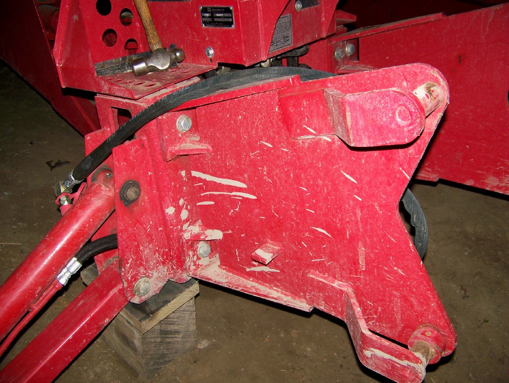

Do any of you guys have a picture of an aftermarket subframe for a mahindra 4035? I bought an old case backhoe for a skid steer and want to mount it on a subframe. The factory mahindra subframe would be hard to duplicate, hence looking for pictures of aftermarket ones.

What your dealer is calling a subframe is just the rails that stiffen up the loader mount. Usually thick angle or tube. These rails come off when the subframe goes on. My subframe has 3/4 inch think beams, 6 inches tall..........running all the way up to where the loader is mounted.

What backhoe brand is it? Did the subframe come with it or is it custom?
   / Attaching a Backhoe to the 3-Point Hitch #38
It is a Bradco 511 backhoe branded for Mahindra. The subframe halves on the tractor and backhoe were designed for my 6520 4WD by Mahindra and/or Bradco.
hugs, Brandi
   / Attaching a Backhoe to the 3-Point Hitch #39
Here are some photos I dug out of my TBN file, of the backhoe half of the subframe. 511 subframe right outboard half.jpg511 subframe right half.jpg511 subframe profile.jpg511 subframe left inboard half.jpg511 subframe left half.jpg
