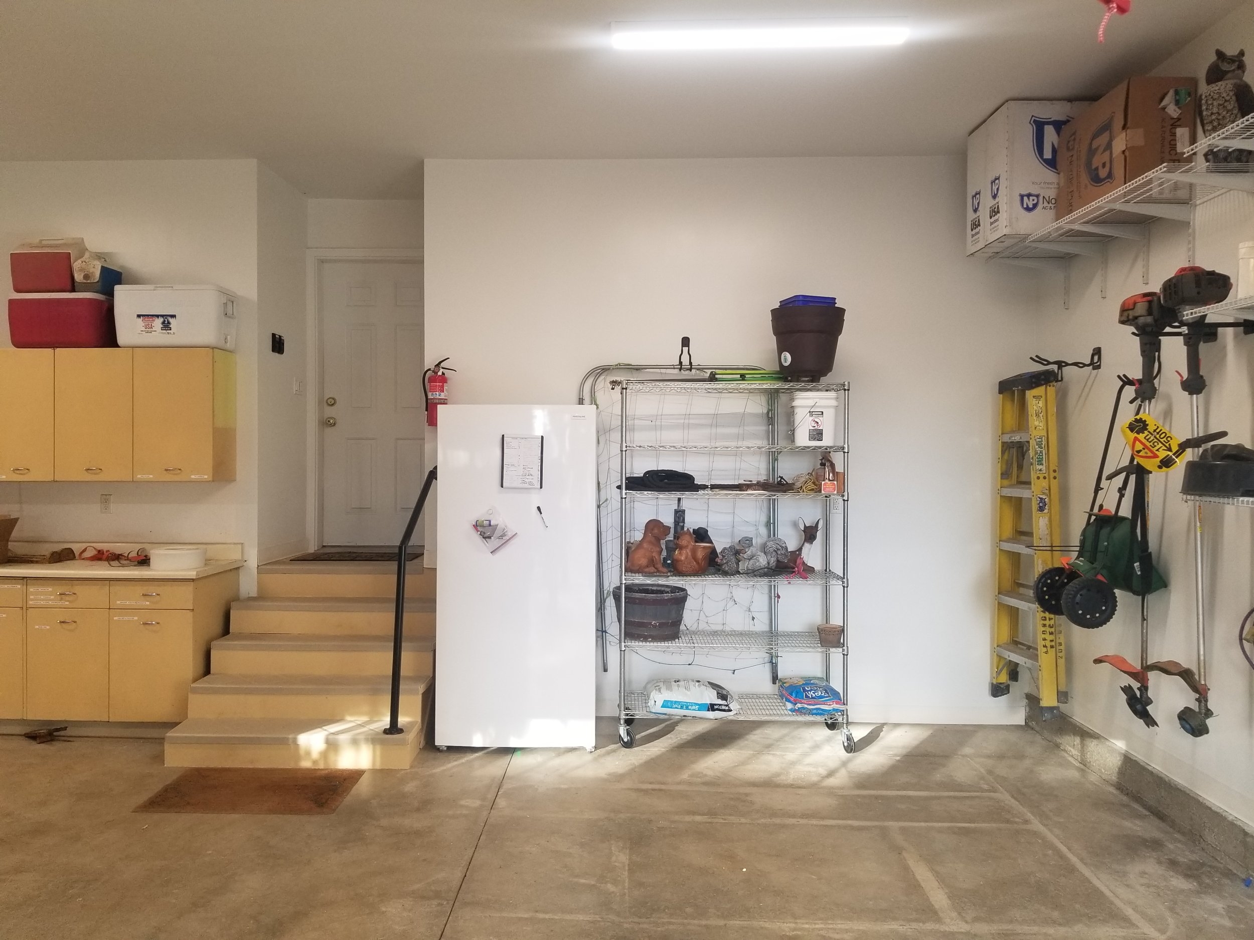

Well, The question in the title kind of sums it up! Lets dig deeper.....
Say you have a full size truck and regardless if you live in the country or suburbia, your truck seems tight in your garage! I am looking for those folks who have trucks that manage to park in the garage! What size door will fit that 3500 chevy, or the 350 ford? I know that situations change when you own a dual rear wheel truck. However, it seems that garages are shrinking and trucks can't fit in there. What are your thoughts, suggestions? Do you live in a house that you gotta park it outside, or were forced to build a barn/shop to park your vehicle? I am thinking that (9' overhead and 8' wide "will fit" a full size truck? Is this too small....Or?
Pic is for reference:
10’ wide x 9’ high work well for my truck and 3500 van. 10’ wide is also the minimum to allow my boat and utility trailer to back in with some clearance, and there are times that I park them in the garage for different purposes.

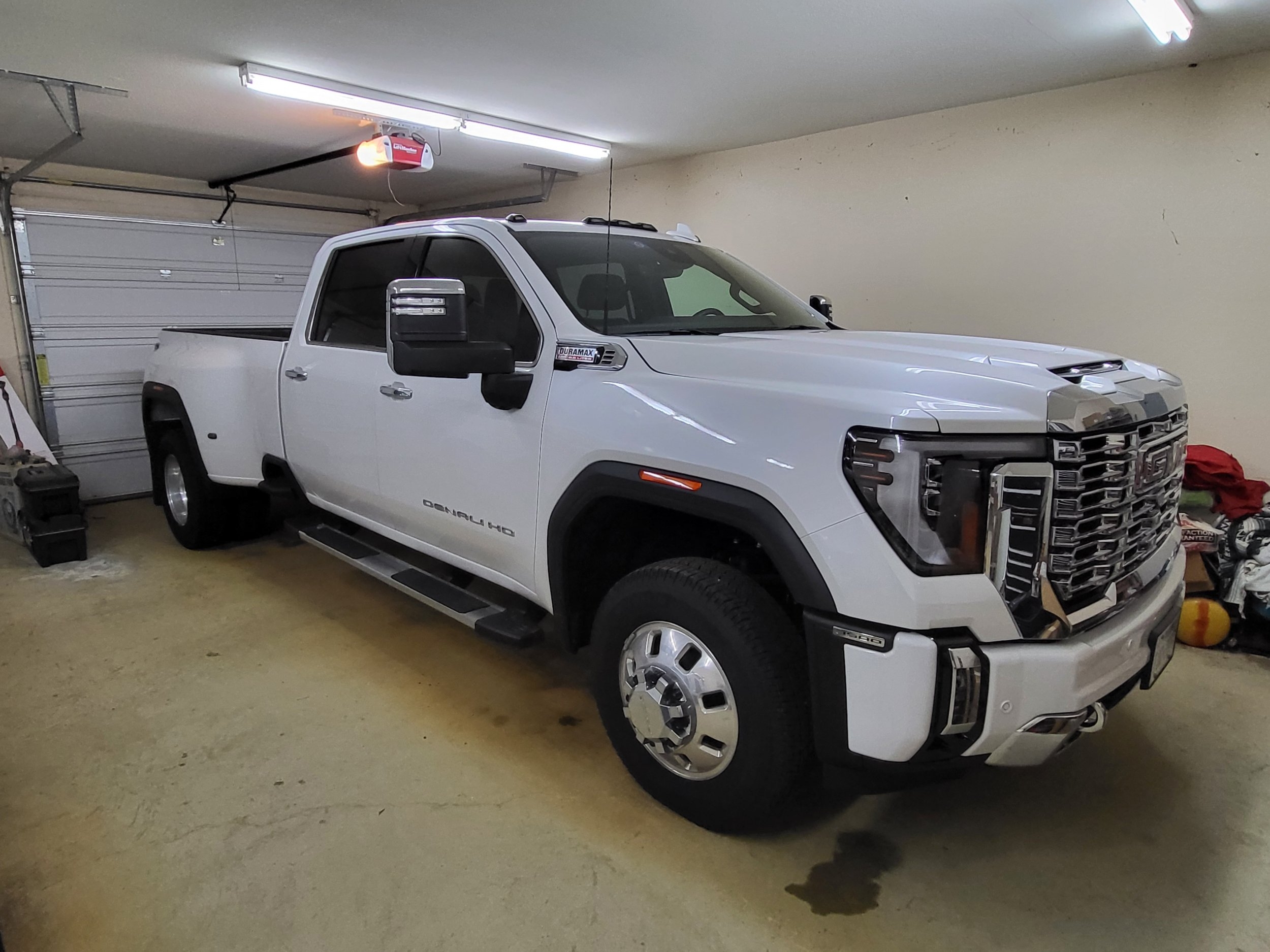

When i built my house in 1996, i made sure garage was overtall so i could use 8’ high doors. I have 1 - 16’ door and 1 - 8 foot wide door. I did ok with the height, but i should have designed it to use an 18’ and a 10’ wide door to fit modern rigs. Its plenty deep to allow full sized extended cab rig, but really not wide enough door wise. It only took me 28 years to drywall it. Did the drywall last winter. Its not too fancy, but i have a 30x40 and a 30x60 shop to work out of. This is strictly for rigs and wifes gardening junk.

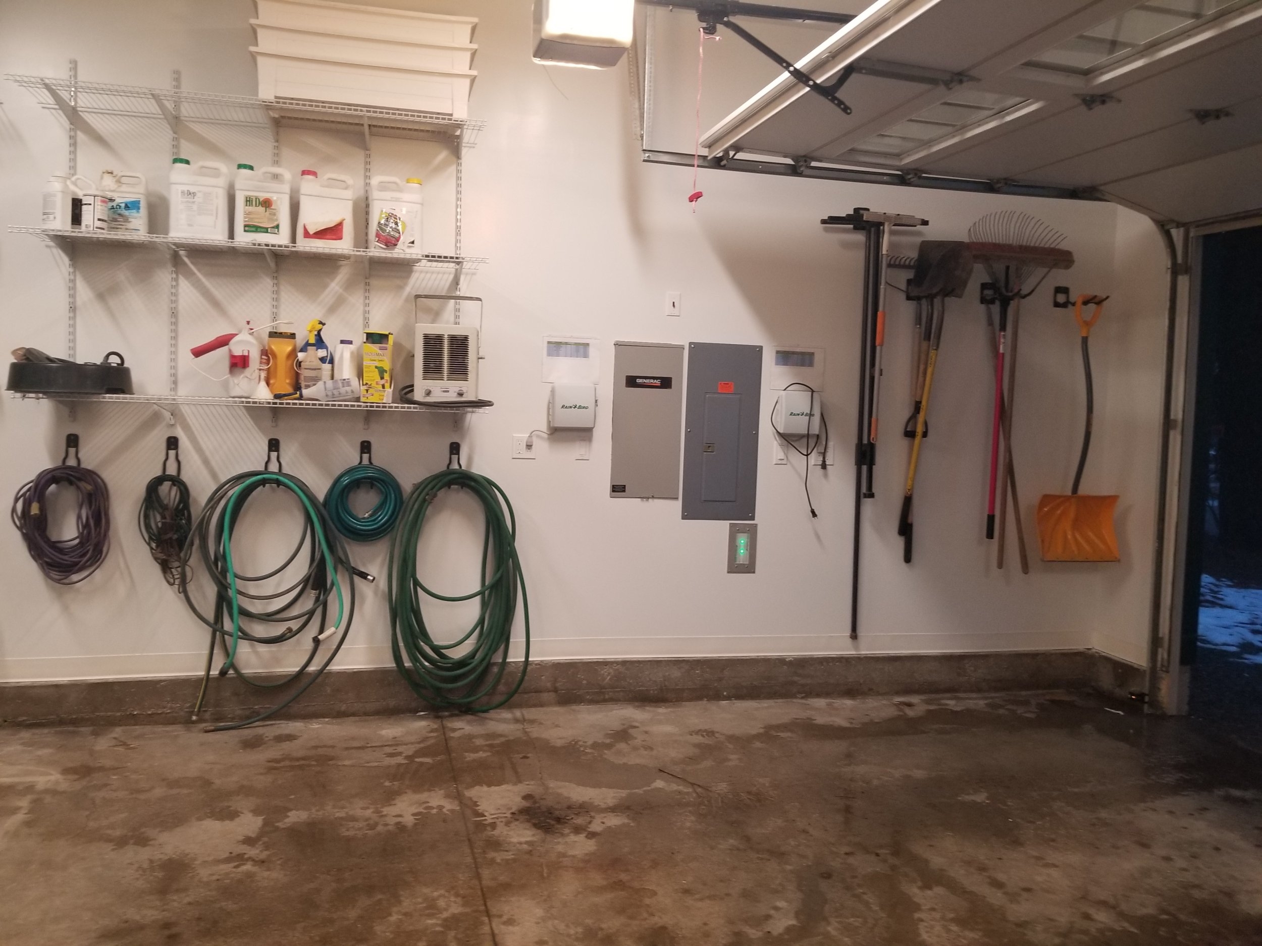

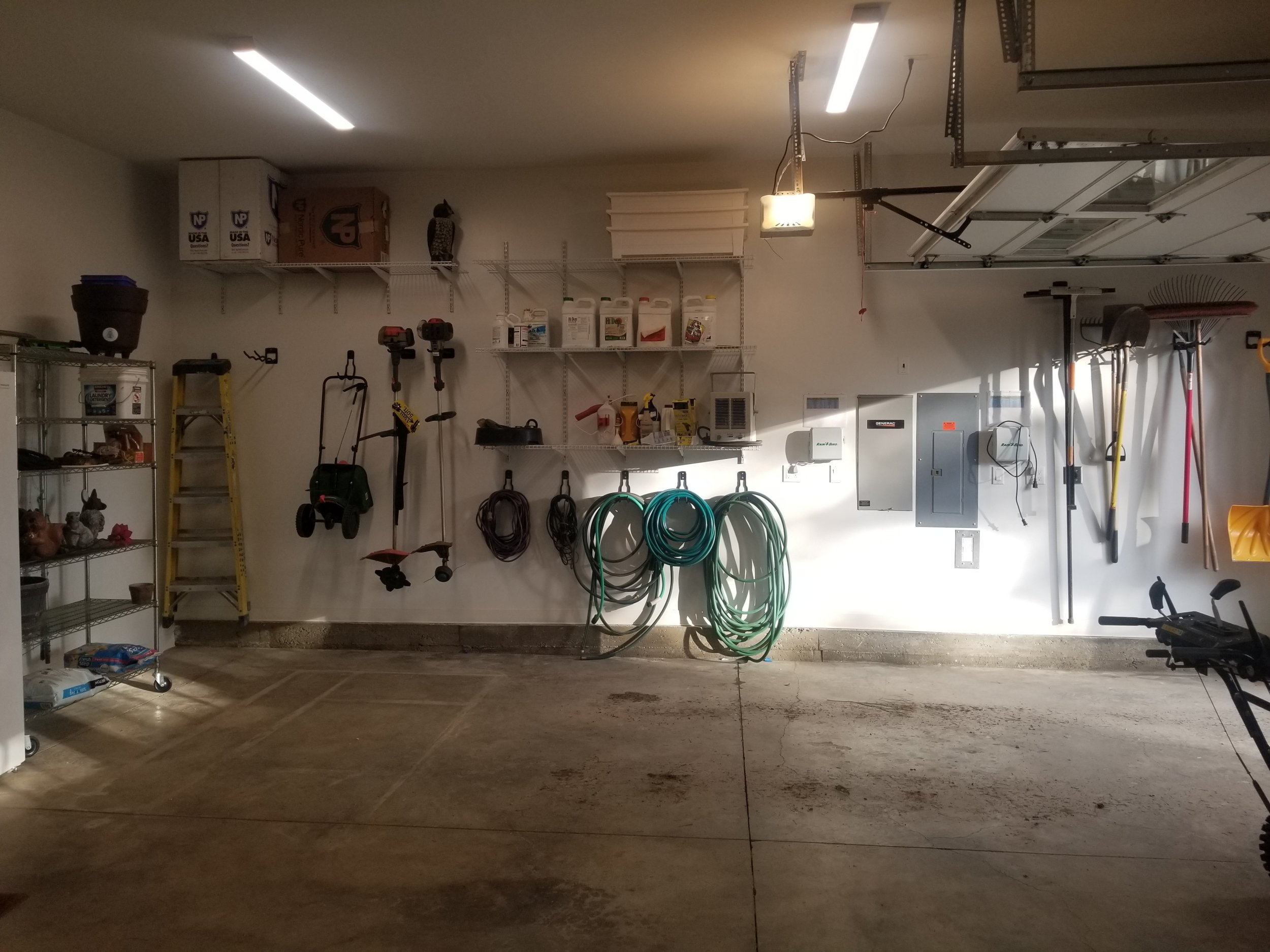

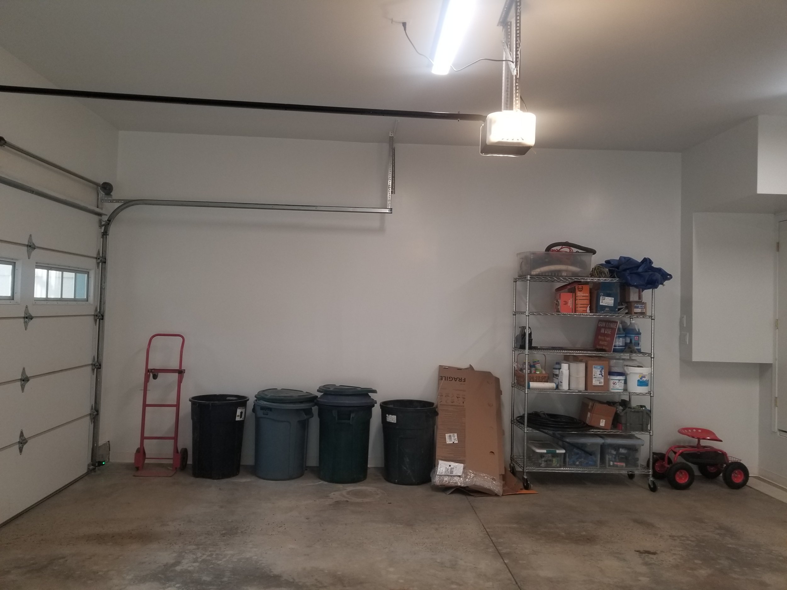

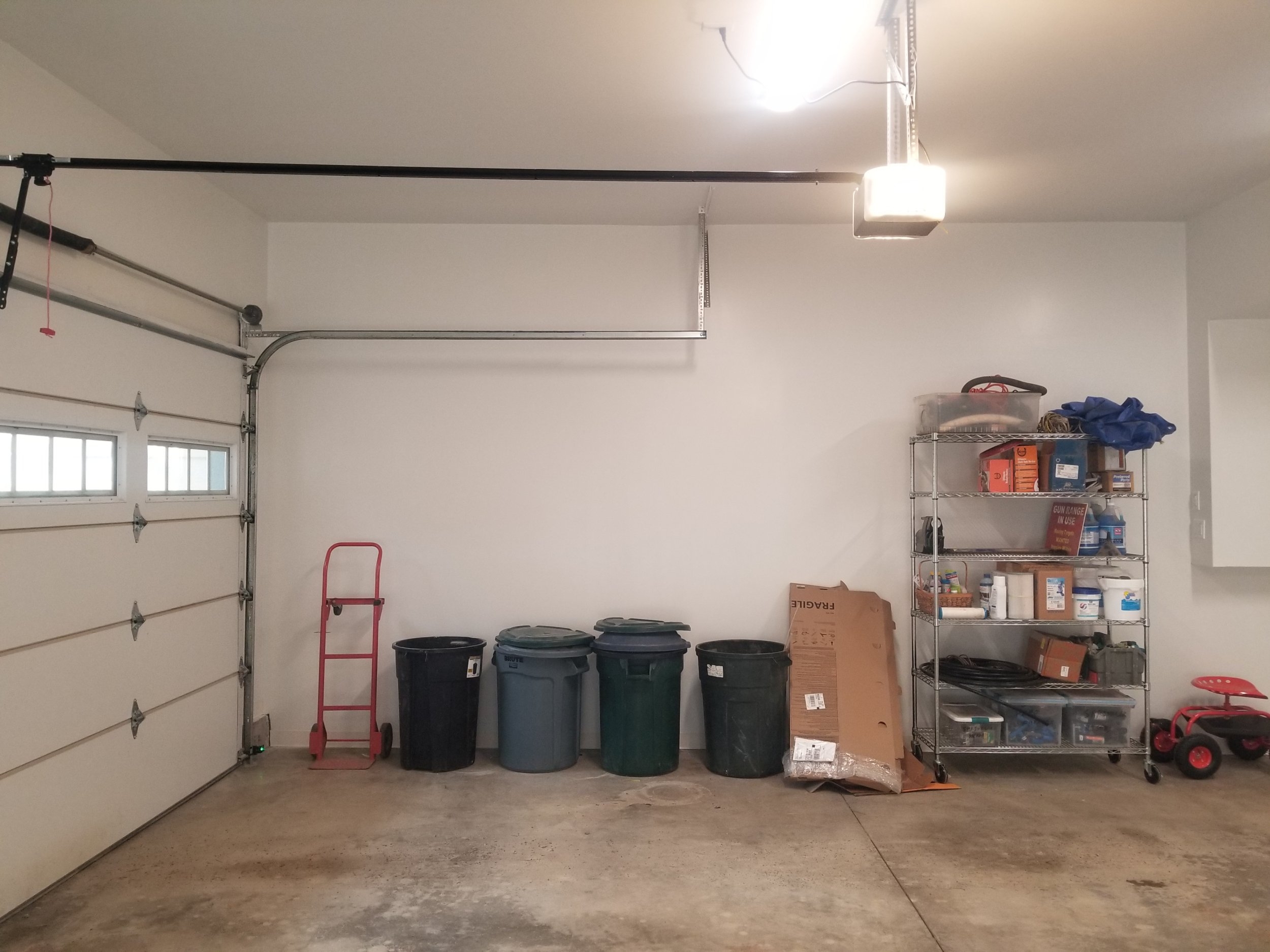

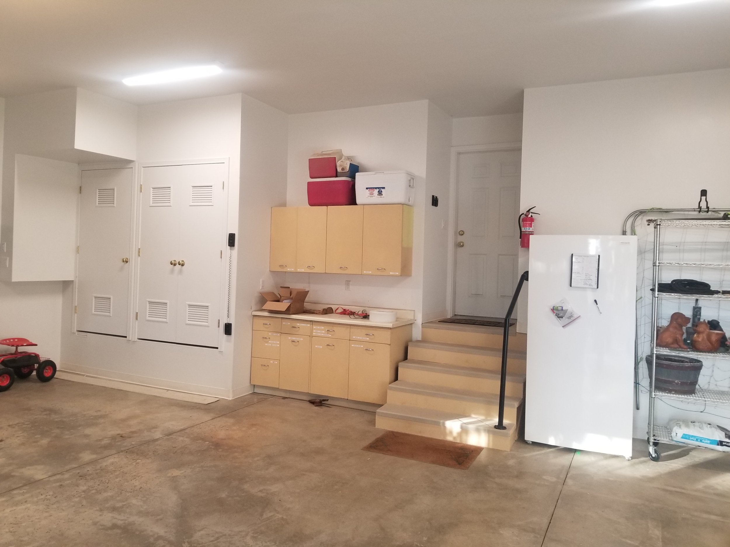

We did something a big different, owing to the fact that I don't really work on cars in the attached garage.
Attached garage: Long counter down one side wall, with overhead cabinets, and a wall of under-counter refrigerators and freezers under the counter. Heater, toy closet (surf boards, beach chairs, rollerblades, etc.), bicycle rack and snow sled rack on opposite side wall. Our attached garage is more likely to be used for entertaining (rained-out BBQ or pool party) than working on cars, and those refrigerators are also our primary house overflow. One fridge is dedicated to beer.
Detached garage: Workbench down side wall adjacent to man door, woodworking machines on mobile bases stowed down center aisle and back wall, and tool chests, compressor, and arbor presses along other side wall. This is the main space for everything from working on tractors to building doors and windows for the house.
Shed: Storage for mower, tractor, implements, seed, fertilizers, etc. All seed kept in Rubbermaid trash cans with lids, to avoid attracting rodents.
