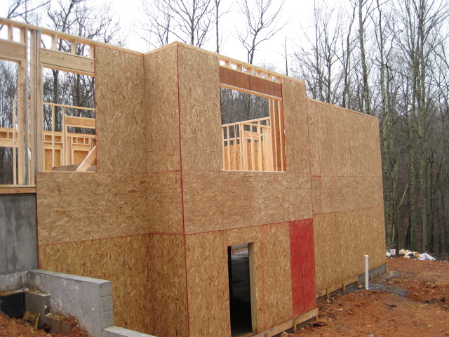

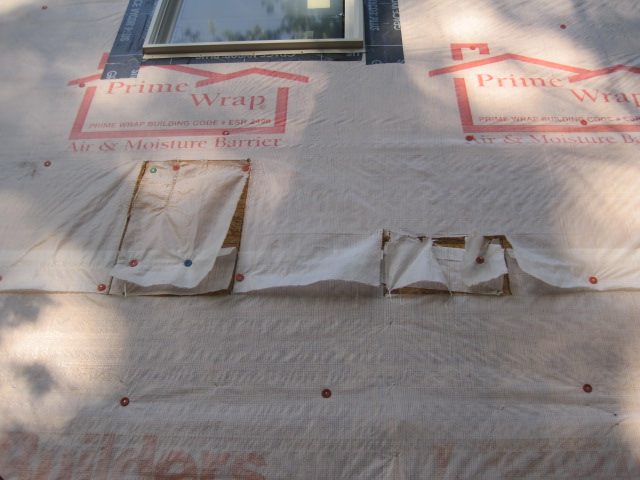

The HVAC guy had to cut through the house wrap and sheeting to install the solid H&A ductwork in the trusses. He patched his holes using the same sheathing and house wrap pieces that he cut out.
attachment.php
Unfortunately, these patches were not be very water tight. He made 4 holes. The picture shows 2 of the holes.
attachment.php

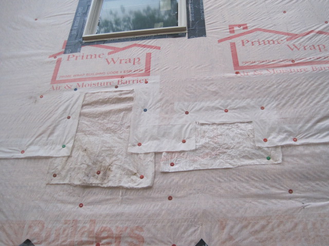

So this evening I got some scrap house wrap pieces from the scrap pile and patched the house wrap to make sure everything overlapped for water protection.

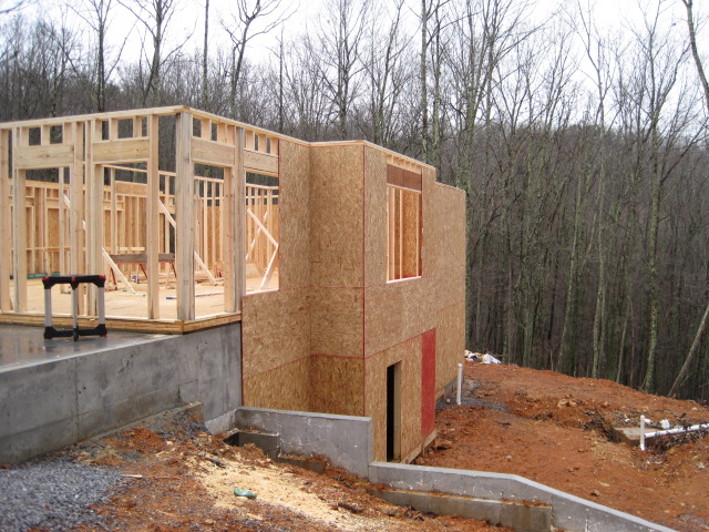

Eyebrow Question
attachment.php
Brick will be laid from the footer to the eyebrow shown here. After the brick is laid, the vinyl soffit will be installed under the eyebrow. The vinyl soffit will be attached to the brick using J-channel. One of the vinyl subs said the horizonal ledger board that attaches the bottom of the eyebrow to the wall will cause a problem. The other two vinyl subs said they don't anticipate a problem with the ledger board. We don't intend to have a frieze board or any trim below the eyebrow soffit as we think it would look bad on our house.
Do you guys see this setup as a problem? Will we end up with a gap between the brick and the eyebrow soffit? What's the solution.

/ At Home In The Woods #1,229
Obed I was looking at your picture where you patched the house wrap. Do you have any house wrap tape? You really should tape those seams. The house wrap not only keeps out the water it keeps air from infiltrating the house. The tighter you can make the envelope the better off you will be when the wind blows.

I attached a couple of pictures that I hope will better explain what I am talking about... you know a thousand words...

/ At Home In The Woods #1,231
Obed,
thanks for the kind words, I have enjoyed watching your progress and reading everyone's comments.
in regards to your eyebrow question...could you have the brick stop say an inch short of the ledger board ( lower if the vinal sub is going to use straping ) and have the soffit rest on top of the brick?
the devil is in the details and my experience is that subs will do things the easiest way for themselves and rarely make the extra effort to make it work better for the subs that come after them. it is a money thing...less labor more proffit... kudos to you for asking questions from people hear that have more experience than you, many people will not do that.
as far as the brickies go make sure you have good air circulation behind the brick ( honey comb vents at the top and bottom) and a way to let moisture (it will get behind the brick) get out.
brick tie ins should be attached to studs, not just put into the sheathing, easy to check of the drywall is not yet installed. when flashing overlaps ( asphault covered copper ) the overlap should be sealed.

The brick mason said the eyebrows would not be a problem. He said that he will cut his brick and make sure that the brick goes all the way to the bottom of the eyebrows. That makes me happy. I don't want a gap between the soffits and the brick.
