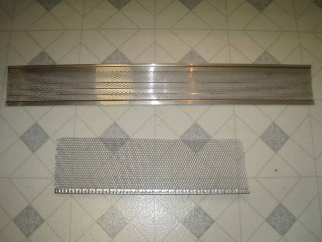

Gutter Guards
We don't know much at all about what are the best type of gutter guards for preventing leaves and other junk from clogging the gutters. With all the trees around our house, we will need really good gutter guards.
A gutter guy came by today.
attachment.php
Here are pictures of two gutter guards he can install. Here are close-ups (gutter guard 1 and gutter guard 2).
Can you tell me which guard would be better? Or do you have some other gutter guard suggestions?

The longer sample looks to be stainless steel which should last longer, but cost more. Not sure that using stainless would be much of a benefit for gutter guards.
Around here they sell a product called "leafguard" which incorporates the gutter gard into the gutter itself. They also claim that if they ever clog, they will send someone out to clean them for free. Gutters From LeafGuard - Seamless Gutter System

Go with the gutter guard with the biggest holes. While both look to be pretty good, I've had some serious issues with those using smaller holes, and not as many. When the water comes down too fast to go through the gutter guards, it goes over and ends up inside of the soffits. I've had several clients with water damage inside of their sheetrock because of this.

As for leaf guard systems...they all have their faults.
I like Rainflow better than the metal screens. I've used it several times and my customers love it. I installed it on my Mom's house and I'm going to install it on my own house. It's far superior in keeping maple seeds out than metal screens.

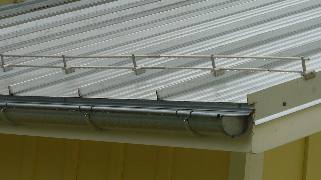

We did the 6" gutters, and have no trees too close to the house, and the only trees semi close are on the east side (winds tend to be from south to west around here). 4" galvanized downspouts. Smooth 4" PVC drains. So no gutter cleaning problems.
Last house was deep "In The Woods", had "standard" extruded plastic covered aluminum gutters. The 3x4 rectangular down spouts were on them, drains were 4" corrugated plastic. Have had to clean drain lines twice by futzing about with a garden hose. Tried various gutter guards like the ones you posted. Still had to clean the gutters each year, but at least it was on my schedule. So if go this route, pay attention to how hard it is to remove the guards. That house had them attached with aluminum sheet metal screw, so it's a pain. We had gum, pine, oaks and hickory trees, so lots of different sizes of debris.
Extruded 4" rectangular gutter is cheapest, 6" half round metal gutter most expensive. So you are back in familiar territory here reference time, money, and perfection. Young pups trade their lack of money for time and energy, old dogs hopefully can throw extra money at it and save the time and energy (and sometimes they just can't do something anymore).
The old house had the plastic coated aluminum facia on the ends of the roof rafters, no horizontal board. So we could not go back and easily change out the cheaper 4" extruded gutters for the 6" ones. The brackets that hold the big gutters are more extensive and can't go into the end of a rafter. If I were doing it all over, I'd make sure there was a horizontal board at the end of the rafters which the facia was attached to, go with the cheap gutters, and plan to change them out sometime in the future and save for it. This would probably be done in 20-25 years when the house needed a new roof.
I would put in the smooth PVC (3" or 4", depending on how much area the root has) now because you won't want to tear up all your lawn and landscaping down the road. Be sure you have 1/4" drop per foot of run so they self-clean.
